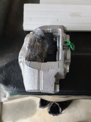

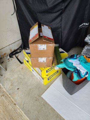

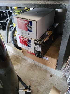

Calipers are in!! Got them keeping my controls arms company!! Away from the 08 Calipers!!

In regards to the texture on the calipers, I'm going to hit them with a 36grit flapper wheel on my die grinder. It will make fast work of it.
I'll post up some pictures when I get to it.
Man I was thinking the same thing. I got two grinders that could polish them up. I'm ask the wife for tips, see what she says;)
I knew you were going to do that.....
You have to let me know how long it takes.
I thought about that too. They are so rough and will look awesome all smooth and coated.....
I'm so lazy when it comes to that.
Are you going to pull the pistons and seals out and have them powdercoated?

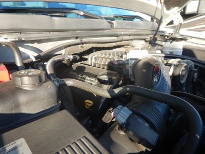

A while back I had a Callaway Silverado, 6.2 with a small maggie
That thing ran great and got pretty good gas mileage for a 6.2.
Only a 2x4 though so I sold it.

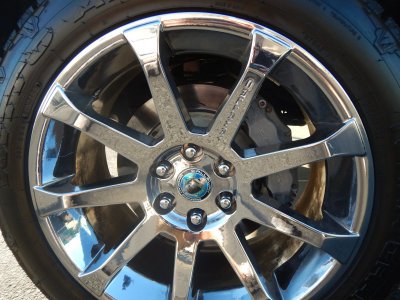

It had callaway branded stoptech 6p calipers front and back. Stopped really, really good.

This is getting a little out of hand there....smoothing the texture of the caliper....but I agree.
I'm going to install and test mine first.
Then see if they fit on the back.
I also think the caliper would look better with that front ridge shaved off. Its steel so I don't think that would compromise the caliper too much.
Then you could put some heat resistant stickers on it.....I haven't seen any Tahoe ones.

Yeah many have shaved that forward facing ridge off with no issues
