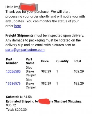

I still haven't received shipping confirmation on my order from gmpartsstore.com

Nah. I just ordered the calipers. No rush here to install them. Just wanted them before the current back order drives up the cost. I'd rather buy pads locally from one of the parts houses. Can't beat the lifetime warranty and personally have never shopped pads online

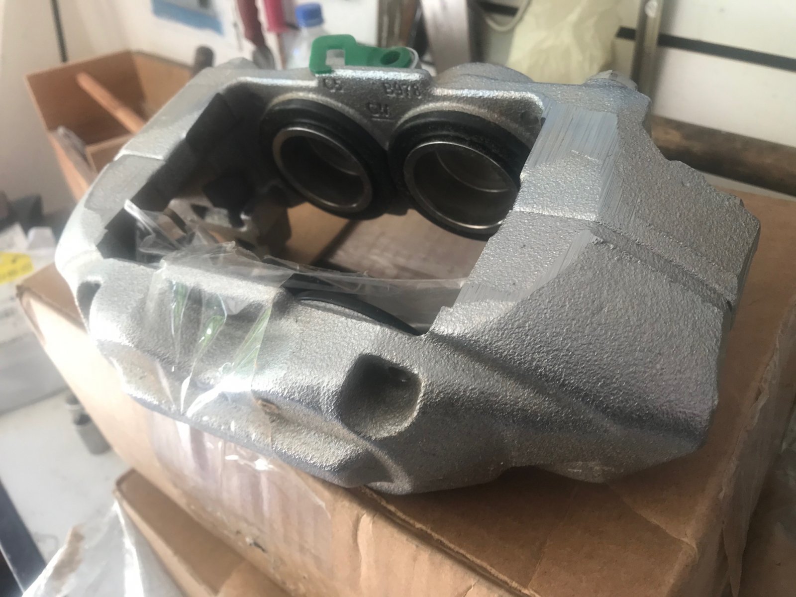

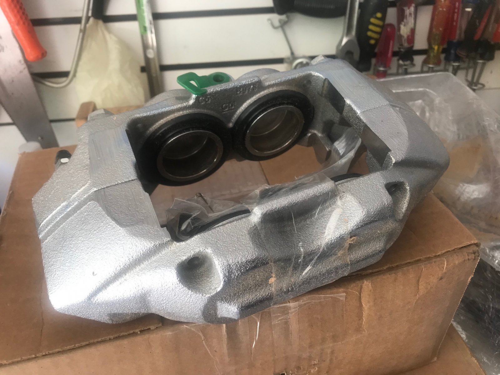

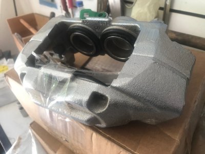

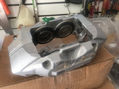

My calipers and rotors arrived today, Sunday, Easter Sunday. Thank You FedEx!
The calipers come with the pin kit so you don't need to order those.
They are BIG! Complete with pistons and seals and painted silver. What a great deal for like $80 per.
2 piece caliper, not monoblock, but you can't beat the price.
These will powdercoat really nice.
Very Similar to the calipers on my Colorado....different part number though
But I bet those Colorado wheels will clear.
