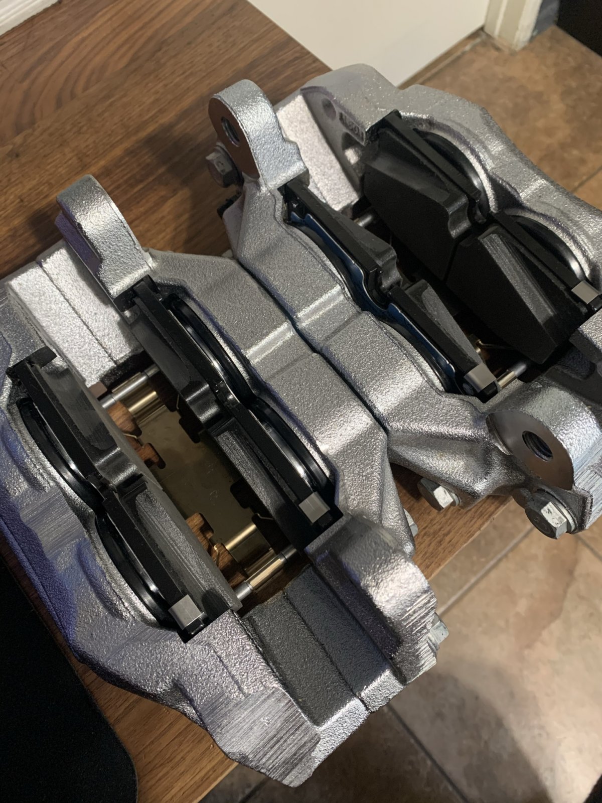

I just purchased all my parts.but im waiting on my rotors cause if I'm running these pretty calipers wanna have nice rotors to.running 24s on my suburban so you can see them pretty good
Calipers from gmpartsgiant.com 79.00 each plus shipping I think
I went with raybestos pads half the price if gm and by there site suppose to be alittle better.
Raybestos element 3 hybrids. 42.00 of ebay!
And for the cross drilled rotors I got powerstops.those were really tough to find.got them from carid.says they won't ship till April 30.they were 155 but the hammered me 40.00 for shipping on top.
I already have the 07 upgrade so very curious to see the difference!

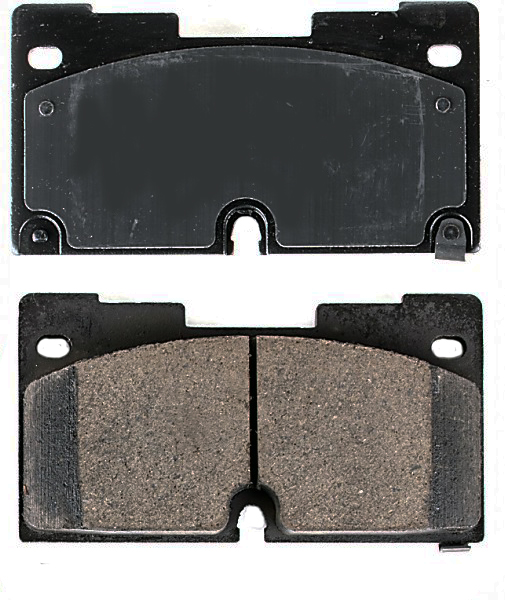

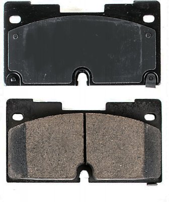

Just as an FYI the pad area of the 2020 silverado brake pad is approximately 15 sqin
I don't have the exact area as i can't find it.
Here are the dimensions of the pad.
Its not perfectly square, so I adjusted the approx area down by 1 sqin, could be more....lazy math.
Length 5.47” (138.78mm)
Height 2.95” (74.92mm)
Thickness .708 (17.9mm)
Here's the PIC
The wilwood 6p pad area with the 14"/16" rotor is 11.1/12.69
Which means the silverado pad has at least a 20% increase in friction, which is really good!
The issue that I've heard some folks are concerned about is clamping force, the ability to apply that friction....and create stopping power.
And that has to be tested.....we'll see.

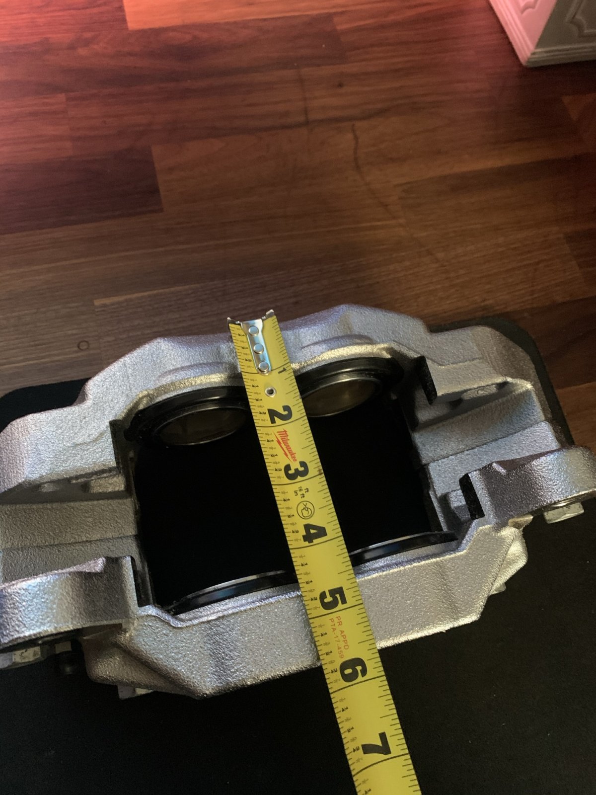

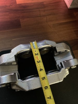

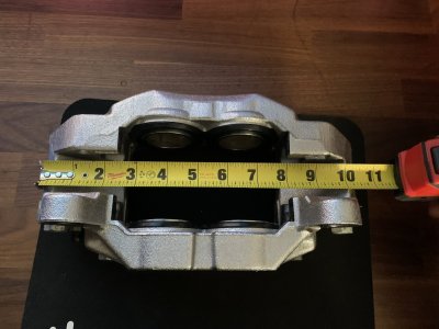

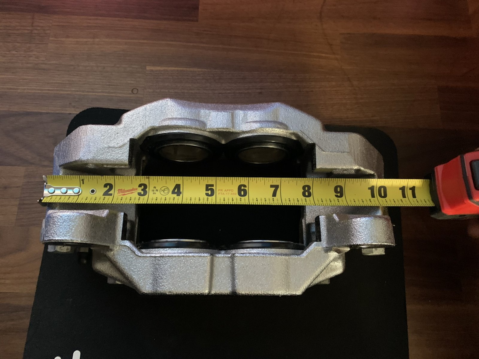

I am shocked at how huge these are. Lmao. I've never had big brakes before so maybe I'm just new to it but they're about 11 inches across and heavy as hell. Looks like 10 inches but its the angle of the camera.
Between 10-15 pounds each.

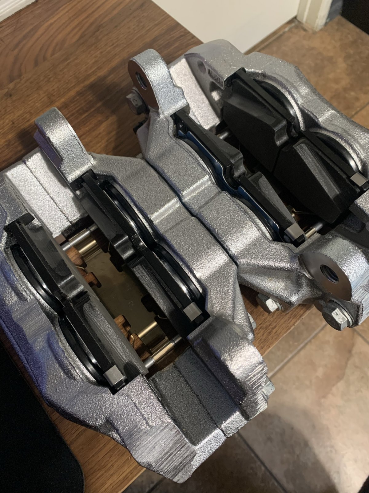

I don't want red like they all do.but my truck is charcoal I was wondering what a bronx color mite look like
