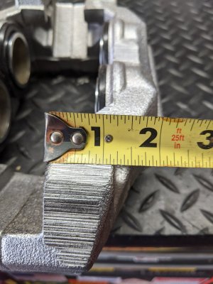

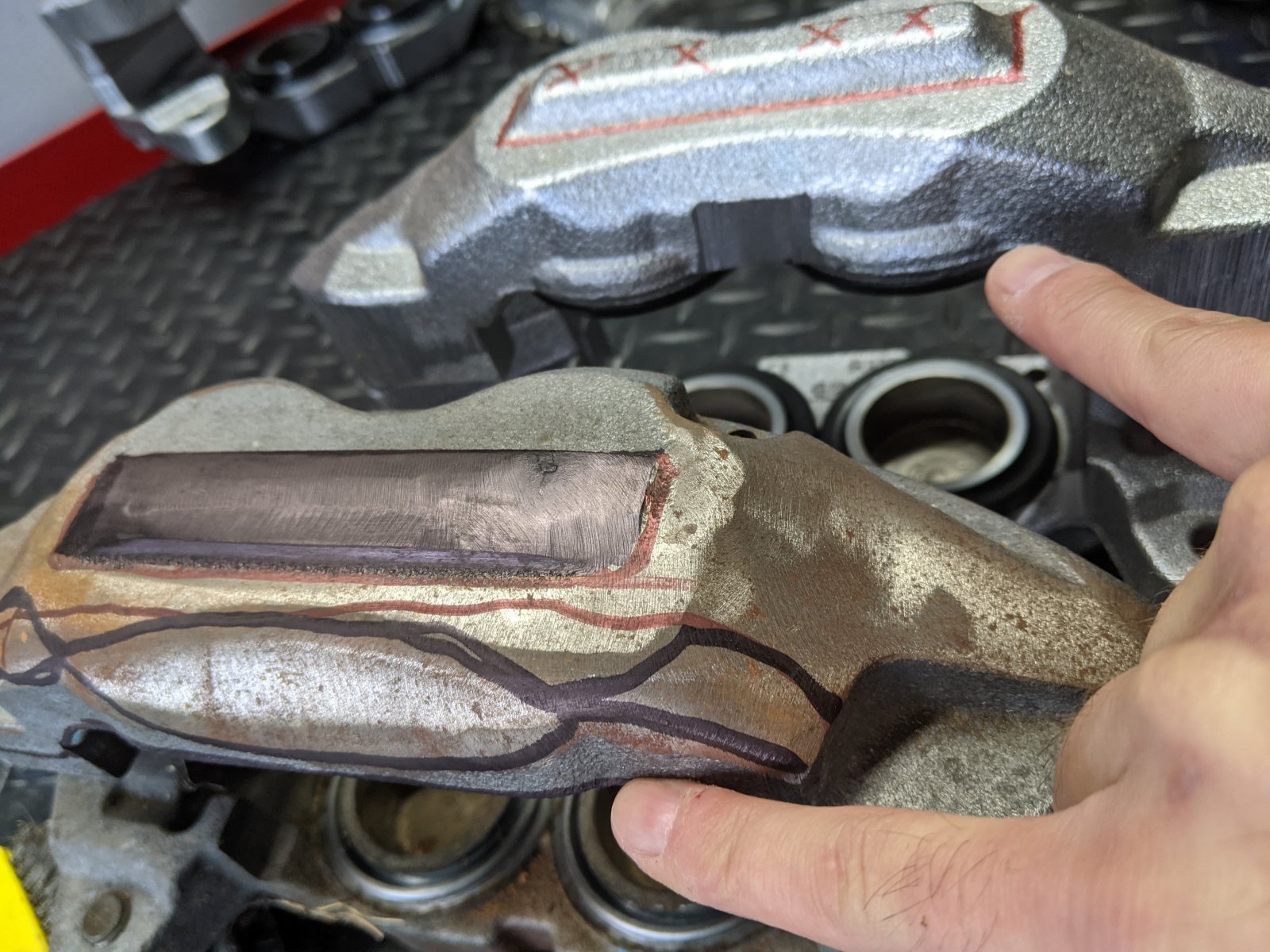

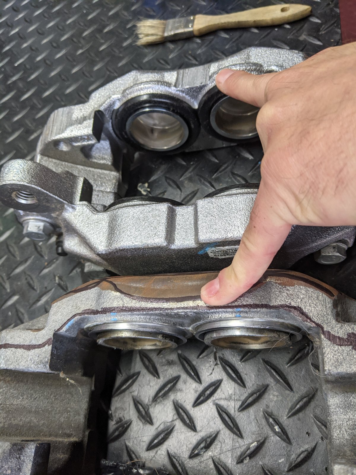

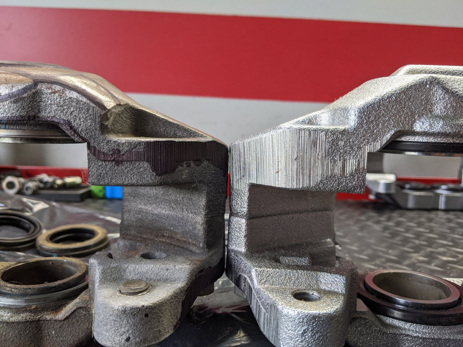

Well did some more looking into the difference from the silverado '19+ caliper to the '21+ Tahoe caliper. There are some differences. Not sure if GM revised them for the big Booty Judy SUVs or if there is separate part numbers to re explore.
See the pictures below. Other then the forward facing part of the caliper, everything else measures out the same. Possibly a difference based on the wheels that are specific to the SUVs.

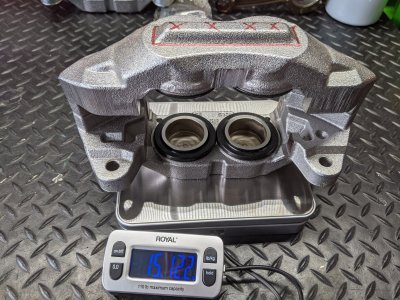

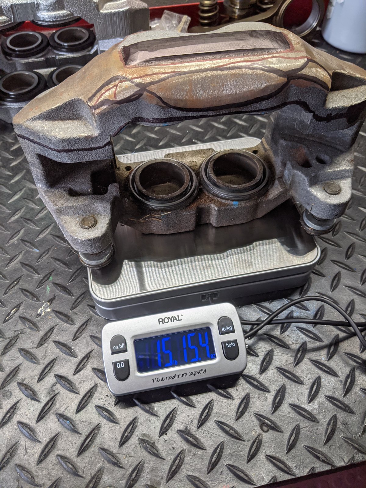

Now I broke out the scale.
The '19 Silverado I have removed the seals and have ground a fair amount of material off.
The '21 Tahoe caliper, bone stock and complete.
There appears to be an extra pound of material on the Silverado caliper. Interesting findings none the less.
Both share the same piston size 1 7/8 on all 4 pistons, that's ****** ****. Very much so a monster upgrade over both the GMT800 and 900 platforms.

On the Silverado calipers vs. the 21 Tahoe calipers.
They are the same exact part number.....driver side is ....79 and pass side is ......80
The differences and i can see those, could be design evolution over time and/or casting differences from different plants or sources.
BTW there Dr. Gandolf, on your scales one caliper has bolts and one does not
And the weight difference is ? Looked closer 3.2 ounces?
15lbs? What a fatboy! Very HD.
