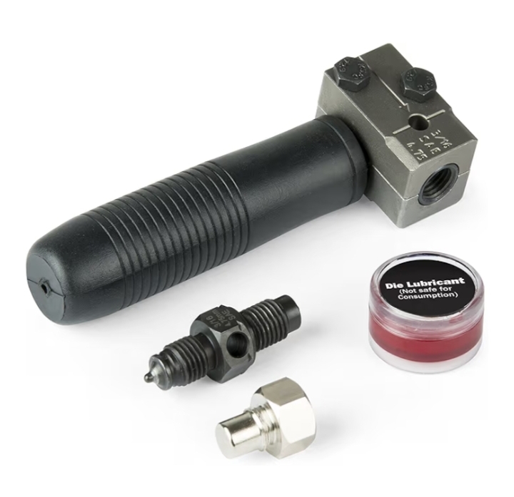

Never found a local machine shop here that had a flare end forming machine. Harbor Freight types just ruin the end. The rust free lines are comforting though.
I have used this handheld hydraulic flare tool, worked great.. Around $300 Mastercool here
I sold it because I rarely used it.. Kinda wish I kept it 'just in case'..
Looks like there's cheaper ones that look just as good.
OMT brand about $165...

There's lots of good brake info around if you search the forum. Use Rock Auto or ant online cross reference to help determine what parts are compatible between years and models. If you do start switching parts around keep a record of whilst you've done or it could turn into a headache later.
For flaring brake lines the tools like this work great and small enough to use easily repairing lines on the vehicle and don't cost much.
