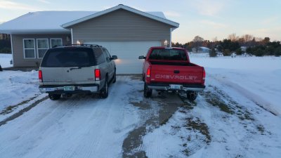

Today as my (soon to be ex-) wife was pulling out of the drive way, she backed into the side of the Yukon:
Black mark down the side just below door handles from car mirror, and the red pant transfer from the side of the car.
She says that it happened because of the snow in the driveway.
That is 4" of light and fluffy snow.
Strange how I had no trouble backing it out of the driveway without hitting anything at all.
...and she wonders why I want to divorce her?
Second time this year she has ran into a car that was parked in that spot.
But yep... definable the snows fault.

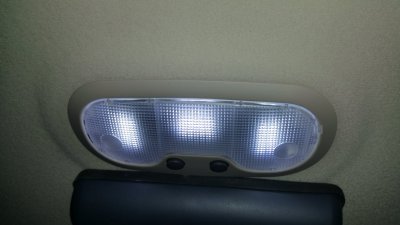

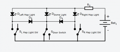

Here is another upgrade for the LED dome light:
When the dome light turns on, the two map lights turn on.
I did it with a couple of diodes between the lights. Below is a schematic of how it works:
I was playing with a circuit emulator program to make sure the idea would work.
I checked the current being drawn by the LEDs in the map lights, and each one only draw 100ma.
I found some 1A 600v diodes in my parts box, and soldered them so the map lights would get ground
from the dome light ground. You want to use diodes so the map lights still work like normal, and don't back-feed into the dome lights.
I need to do this. I like the option of all on
The LEDs I got for this weren't any brighter than stock, so it needed the extra light.
I'm thinking about adding extra LEDs to the back dome lights for a little extra light.
