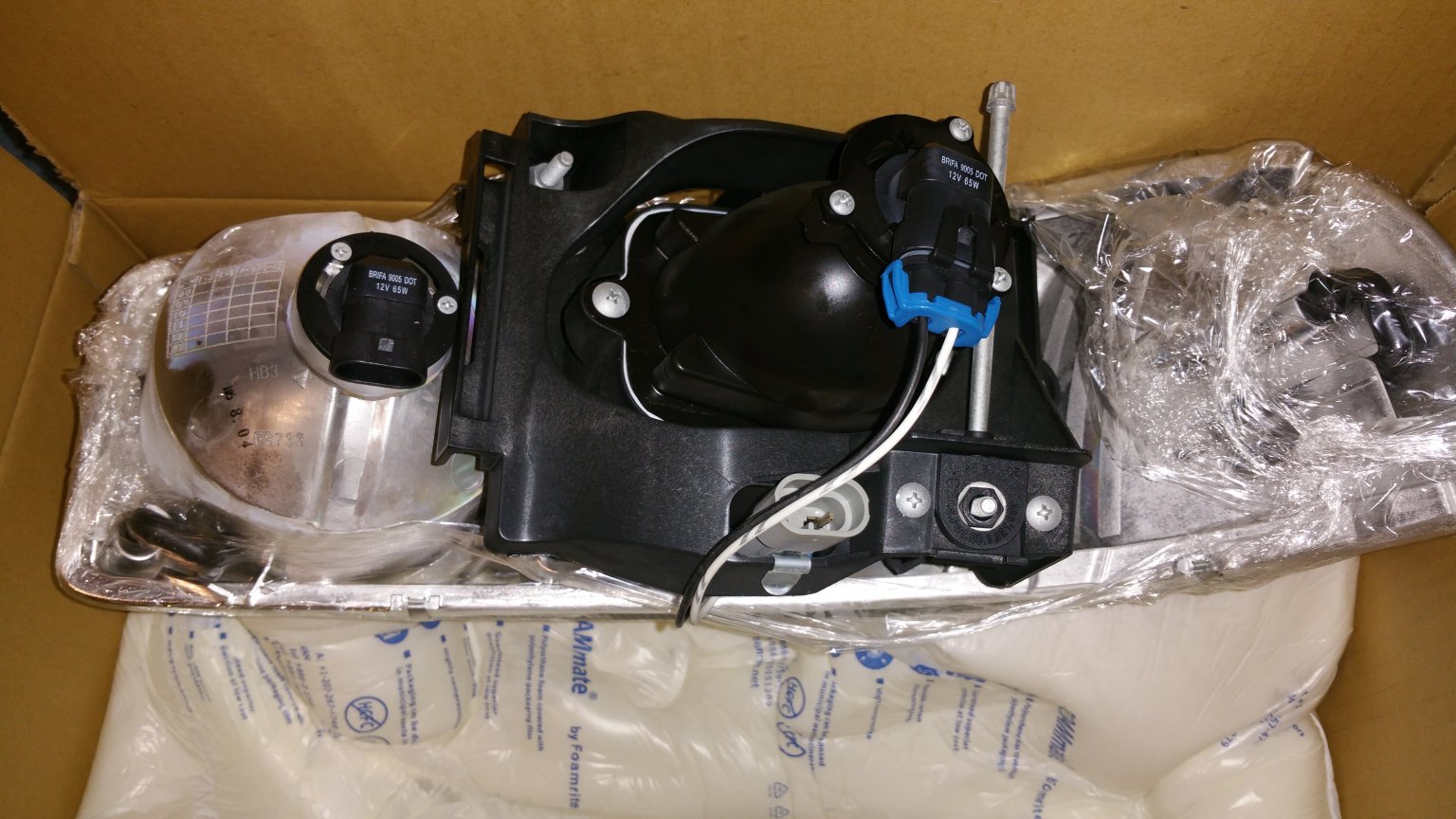

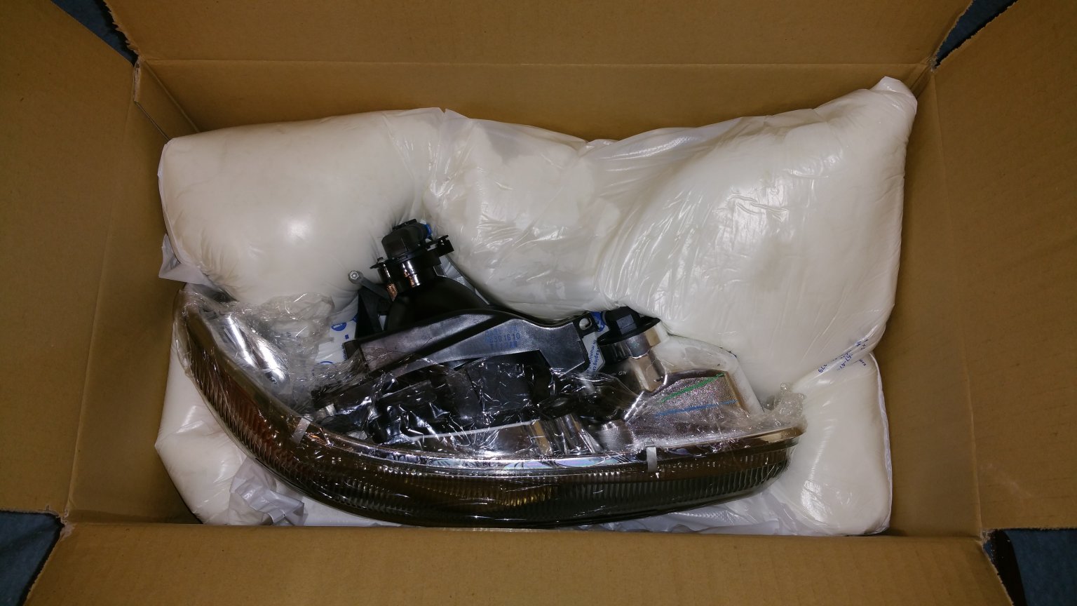

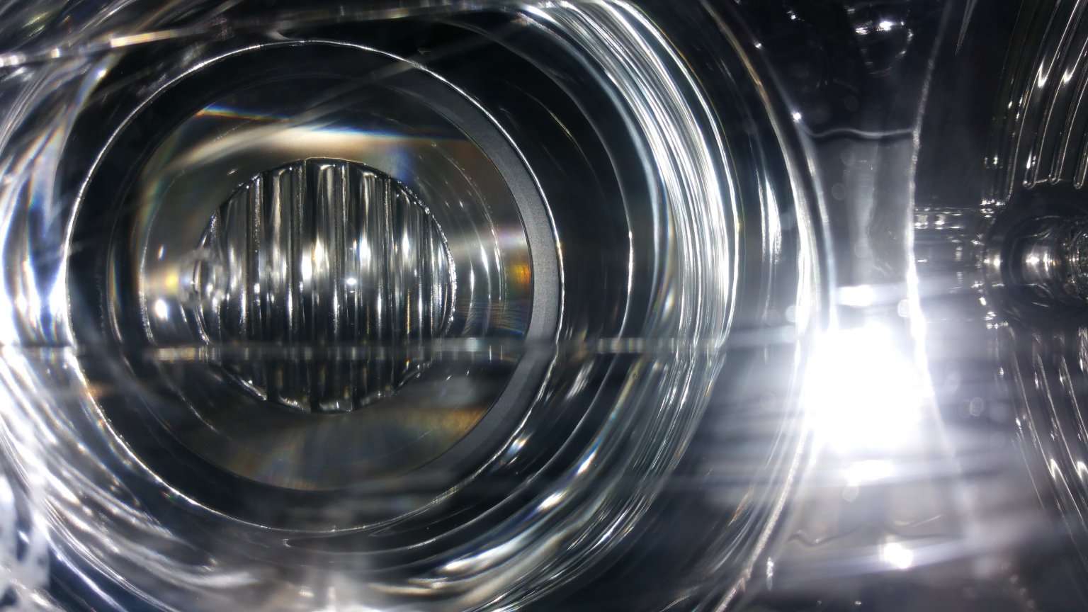

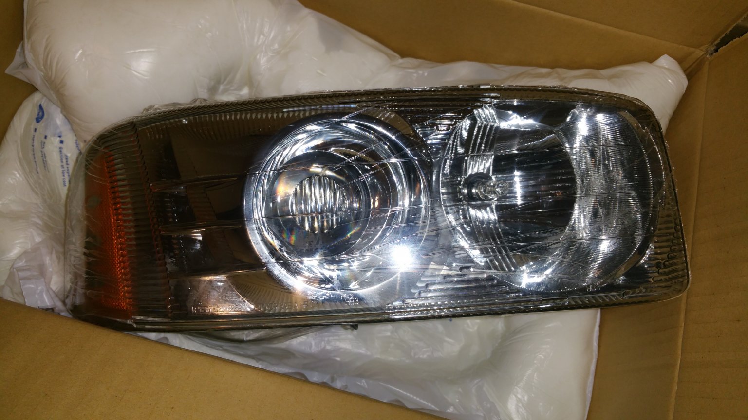

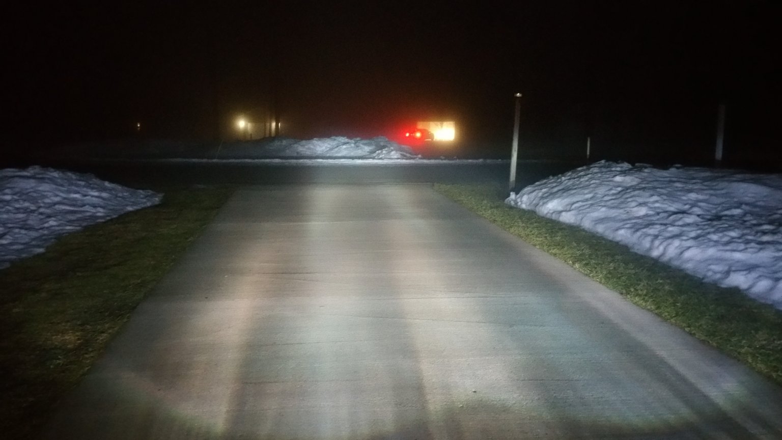

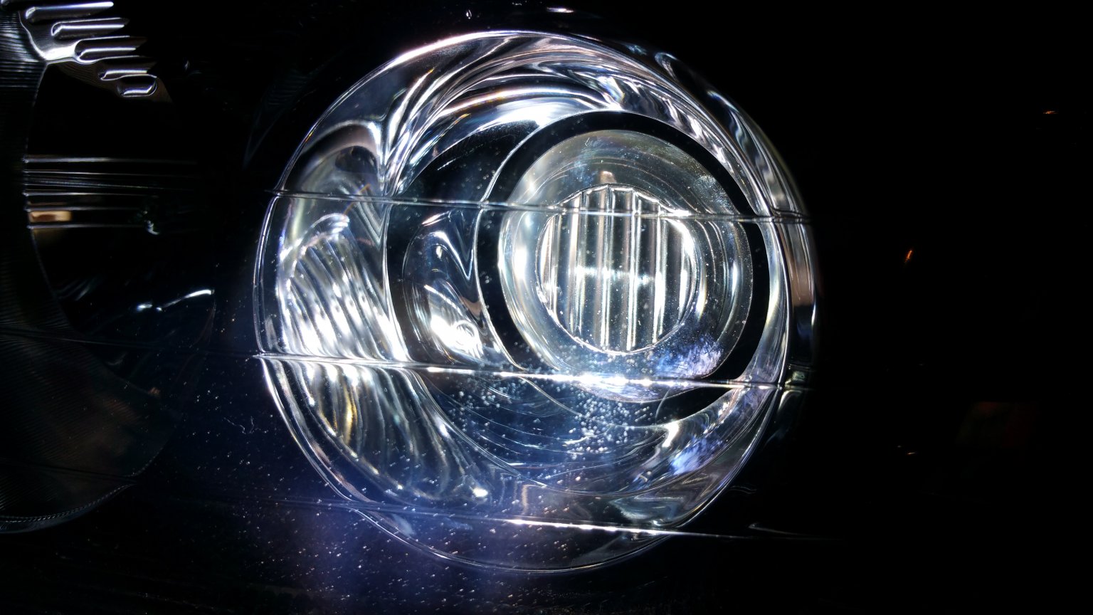

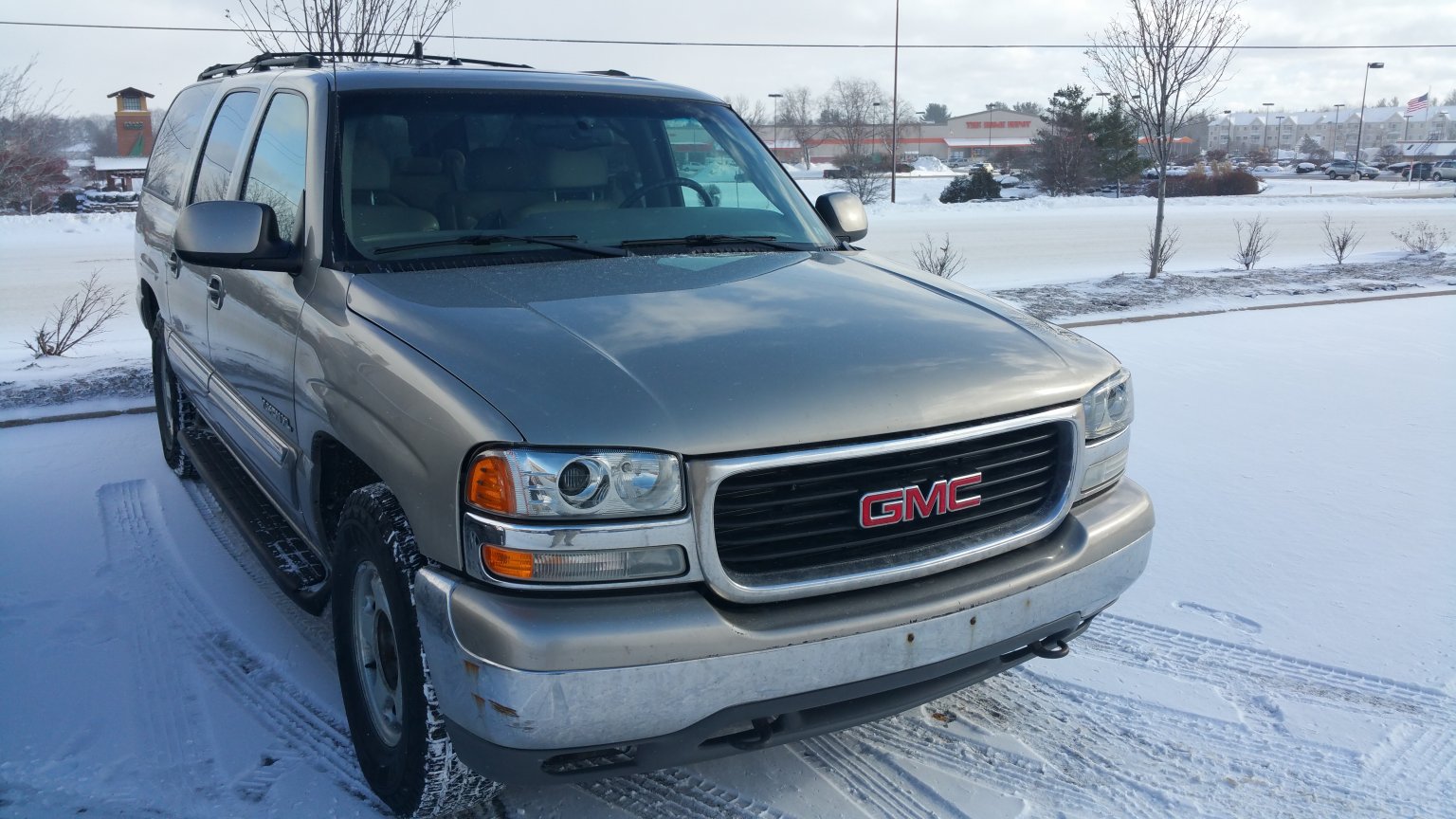

Old and busted, New hotness:
Old pattern on the left, new on the right:
And here is both with the new:
The new lights have a lot less spill above the cutoff, and it looks nice and sharp compared to the old lights.

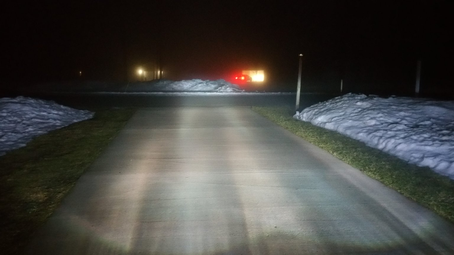

New lights on the snowy drive:
It has a nice cutout on the left that avoids shining light into the face of oncoming cars.
The driver side light went in like butter, but the passenger side fought me for a few minutes.
I think the plastic they used where the pins go in is made from a more flexible kind of plastic, and that wasn't allowing the bottom hole to line up properly.
I didn't break anything getting it in, but it took a little convincing.
Well worth it in the end.

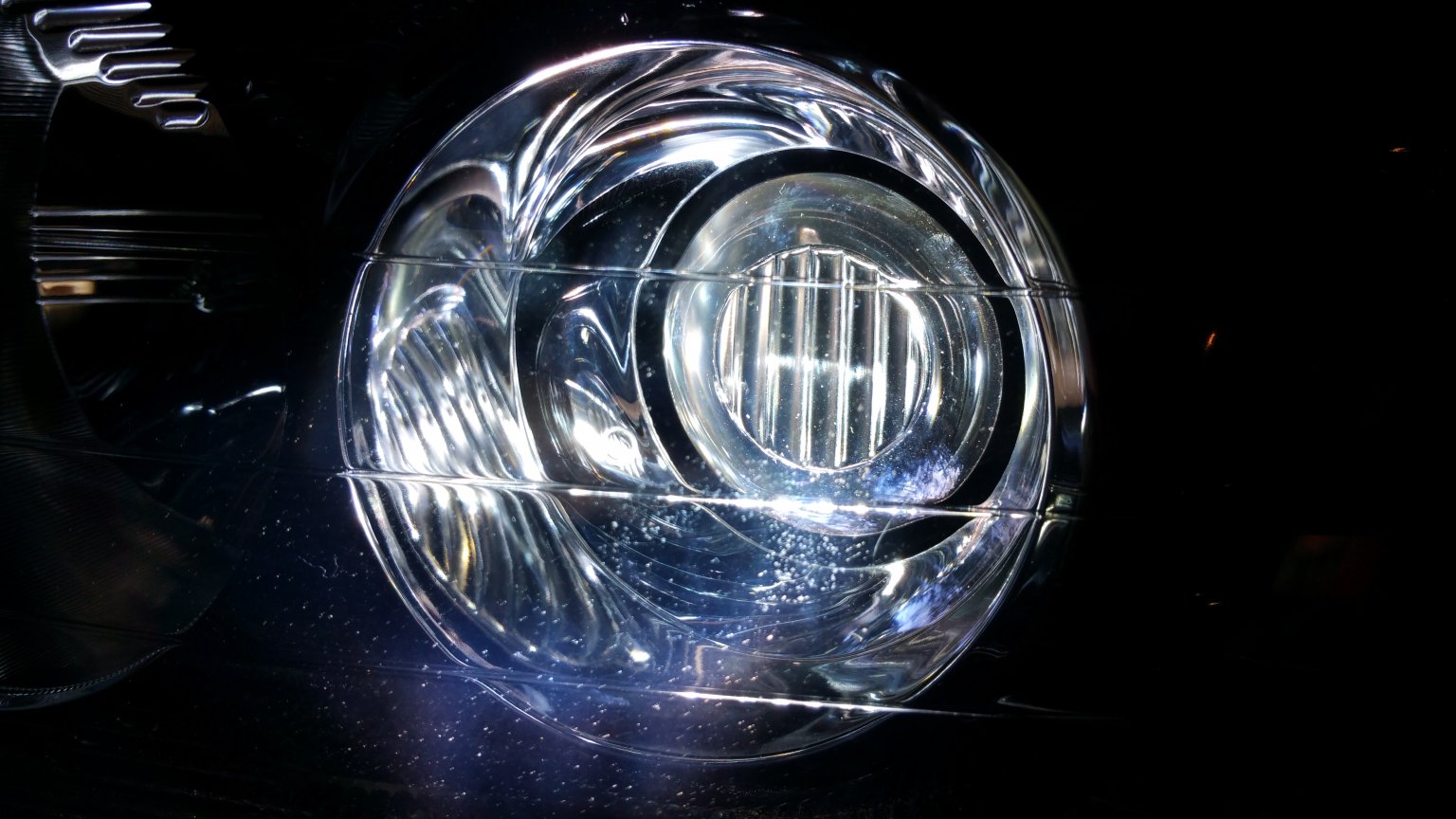

One thing I have notice with going from reflector low beams to projector low beams, is that even though they are just as bright where they project the light, the hard cutoff makes it seem like they are dimmer lights.
When I got the XL, it had 55w low/60w high. These new headlights came with standard halogen but both bulbs are 65w (both bulbs are high beam bulbs). I find myself now wanting to get an HID kit for it...

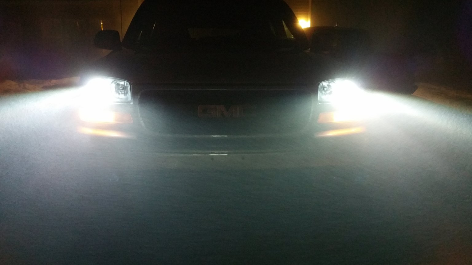

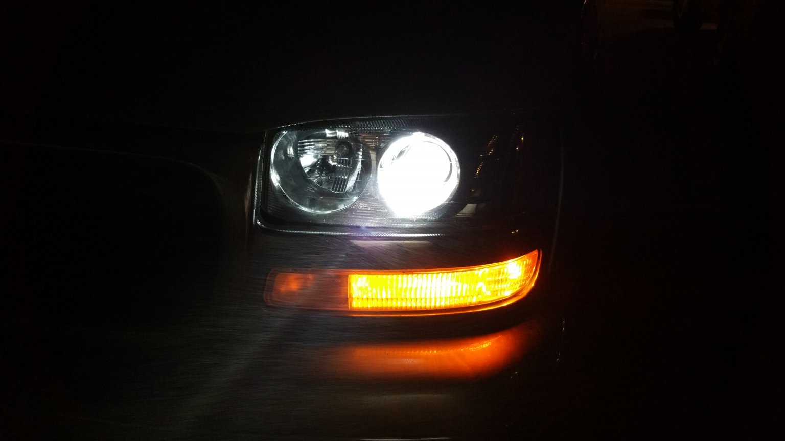

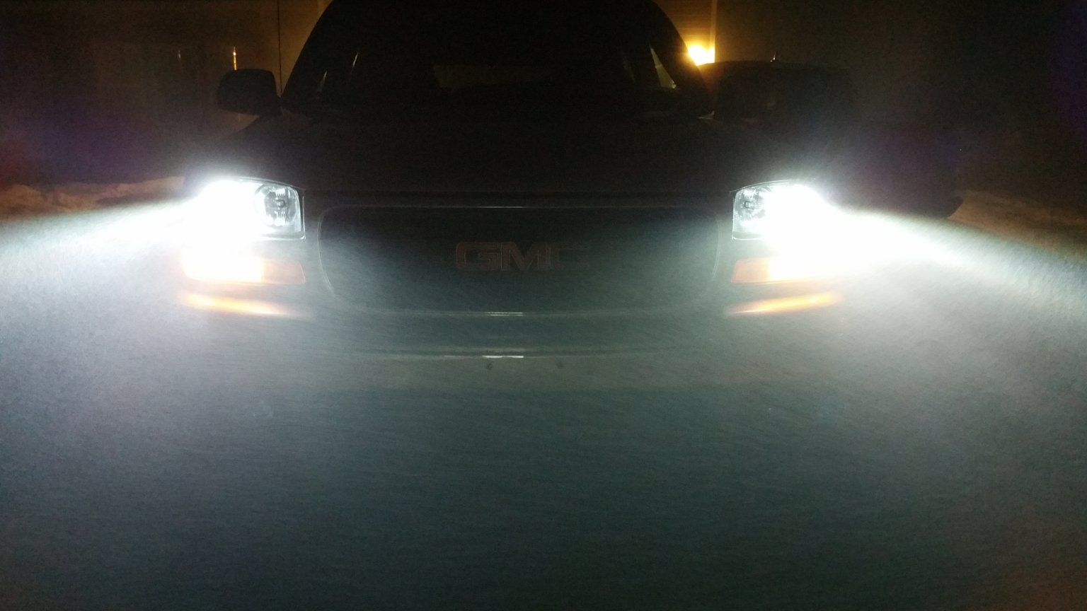

Retro fit them! I'm in the process of doing mine
So I bought this set of cheap 5000K HID headlights on Amazon. I figured for $30, if they didn't work right, I could toss them and only be out $30.
All I did was mount the ballast and trim the rubber behind the driver side headlight (and unclip the washer tubes from their holder) to get clearance for their wires. (passenger side I did nothing)
I've hooked these directly to the factory low beam plugs, and I have no trouble with flicker, and I see no change in light when starting up the truck with them on.
The pattern they put on the wall is the same as the stock halogens in these projectors. They do seem to fill the pattern on the ground right in front of the truck better than the stock bulbs.
They also seem to light the road signs on the side of the road better than the stock bulbs.
For being the cheapest (OEM Denali style) projector+HID kit I could find, I'm amazed they worked this well.
I think I might try a set of 4300K next time.

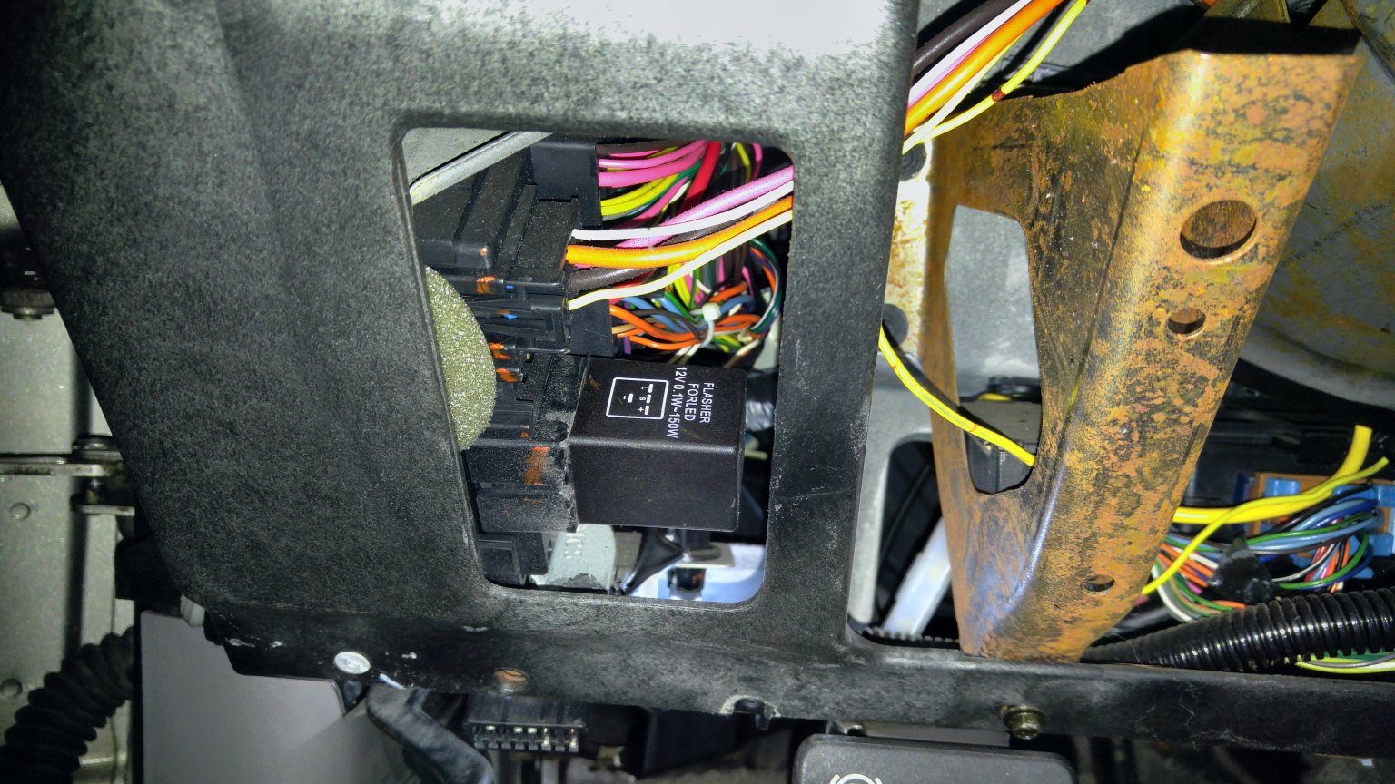

And an EP29N electronic turn signal flasher (must have an LED compatible relay).
The EP29N will not fit without removing the extra plastic around the top of the socket in the truck.

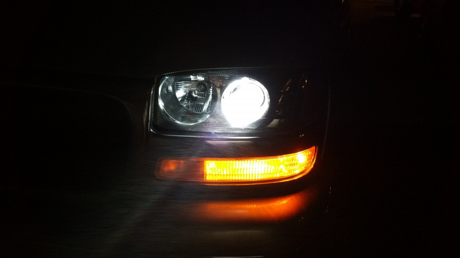

LED (switchback) turn signals, side markers, and DRLs are installed and working, along with brand new turn signal assemblies on both sides!
Action packed video:
The hardest part was cutting off the shroud around the relay with my dremel so the new one would fit.
The EP29N will not fit without removing the shroud around the top of the socket.
If you get 194 LEDs that say they are non-polarity sensitive (got mine from superbrightleds.com), the side marker lights will function like the stock lights (as you can see in my video).
When I swapped out the DRLs, I noticed the sockets were heat damaged. I'm going to have to replace those some time...
