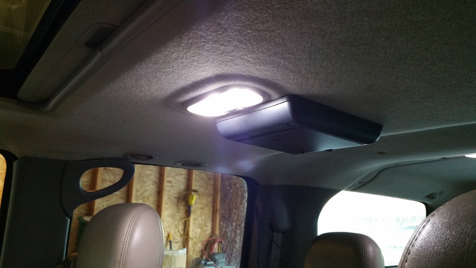

Here is another upgrade for the LED dome light:
When the dome light turns on, the two map lights turn on.
I did it with a couple of diodes between the lights. Below is a schematic of how it works:
I was playing with a circuit emulator program to make sure the idea would work.
I checked the current being drawn by the LEDs in the map lights, and each one only draw 100ma.
I found some 1A 600v diodes in my parts box, and soldered them so the map lights would get ground
from the dome light ground. You want to use diodes so the map lights still work like normal, and don't back-feed into the dome lights.
