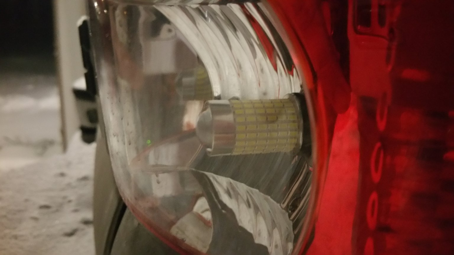

I like them
The reason I bought this set, was the entire light lights up for parking lights, not just the brake light area like most sets for our trucks do, while still keeping separate brake and turn signals.
The general theme I've been trying to follow with upgrades I've been doing is a "stock" look.
Try to make it look like it might look if the GMT800 platform was being built today.
The swtichbacks work like the new Yukon DRL/turn signal LED loop, the headlights are Denali copies, etc.

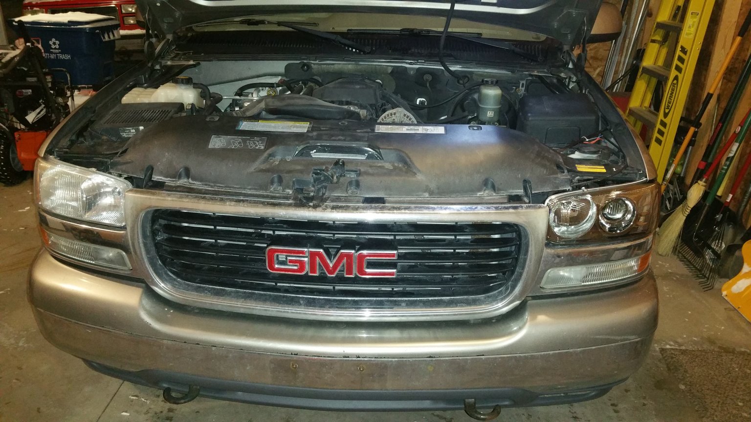

Do

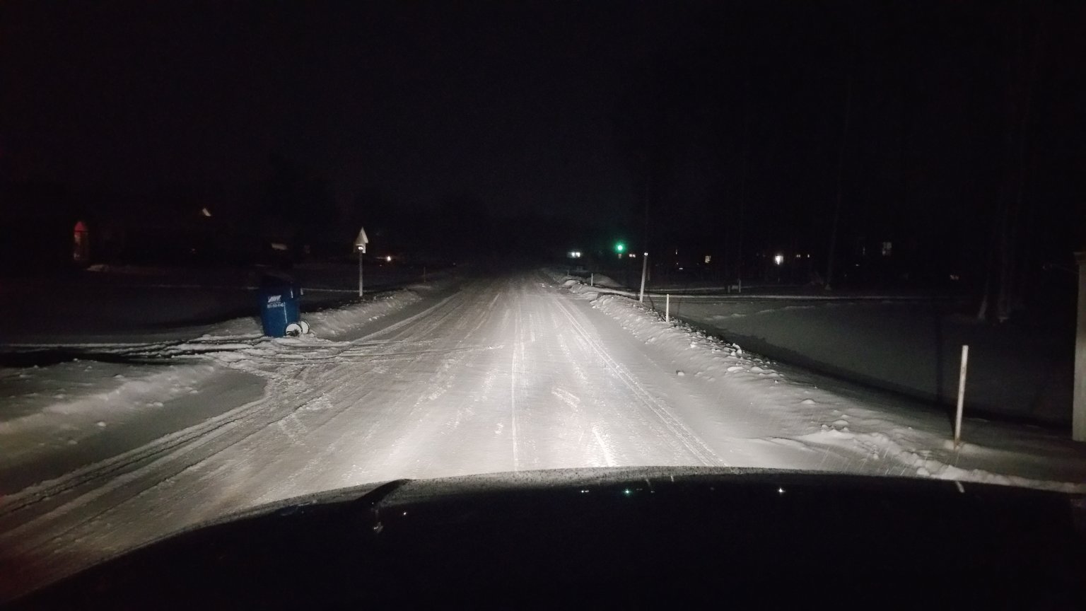

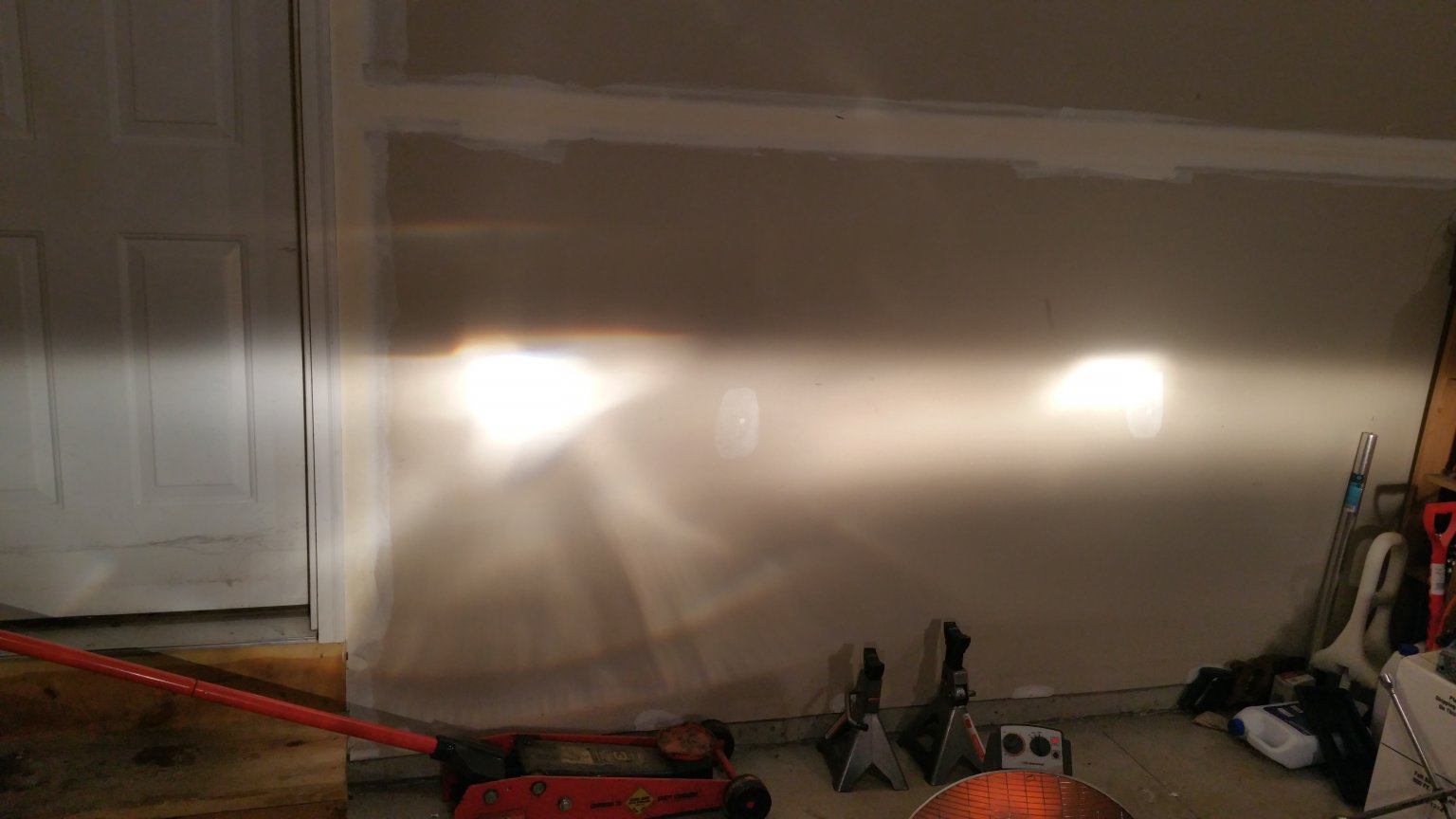

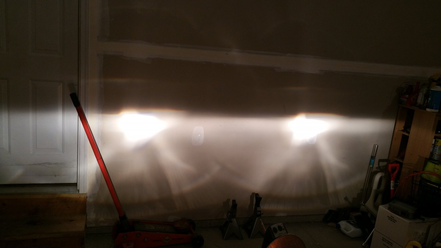

Old and busted, New hotness:
Old pattern on the left, new on the right:
And here is both with the new:
The new lights have a lot less spill above the cutoff, and it looks nice and sharp compared to the old lights.

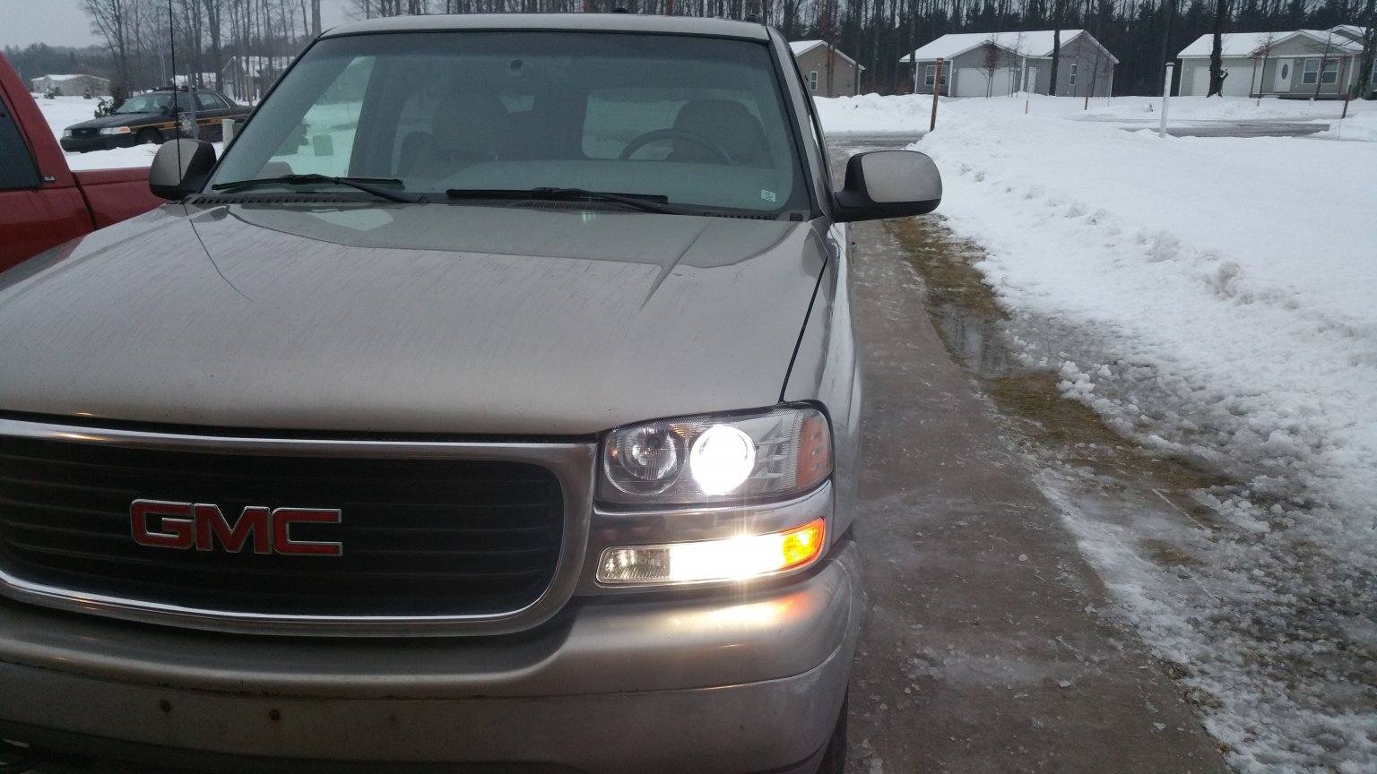

New lights on the snowy drive:
It has a nice cutout on the left that avoids shining light into the face of oncoming cars.
The driver side light went in like butter, but the passenger side fought me for a few minutes.
I think the plastic they used where the pins go in is made from a more flexible kind of plastic, and that wasn't allowing the bottom hole to line up properly.
I didn't break anything getting it in, but it took a little convincing.
Well worth it in the end.

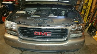

Any idea if you have to make any changes to the hood, like shaving...for an HD hood? I want projectors bad, and keep reading about having to shave to fit on a tahoe with an HD hood (the denali lights)
Thanks
W8TVI
W8TVI
Nov 6, 2016
696
692
Traverse City, MI
From what I've read on here, I think the HD hood (along with the Tahoe hood) are basically flat across the area that meets the grille.
Denali/Yukon lights won't match up to the fenders, grill (at least I don't think it'll match to the grille), or hood on a Tahoe or Silverado.
You are probably better off retrofitting some projectors into your headlights.

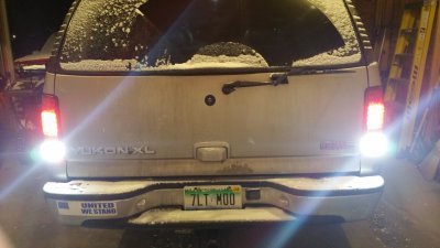

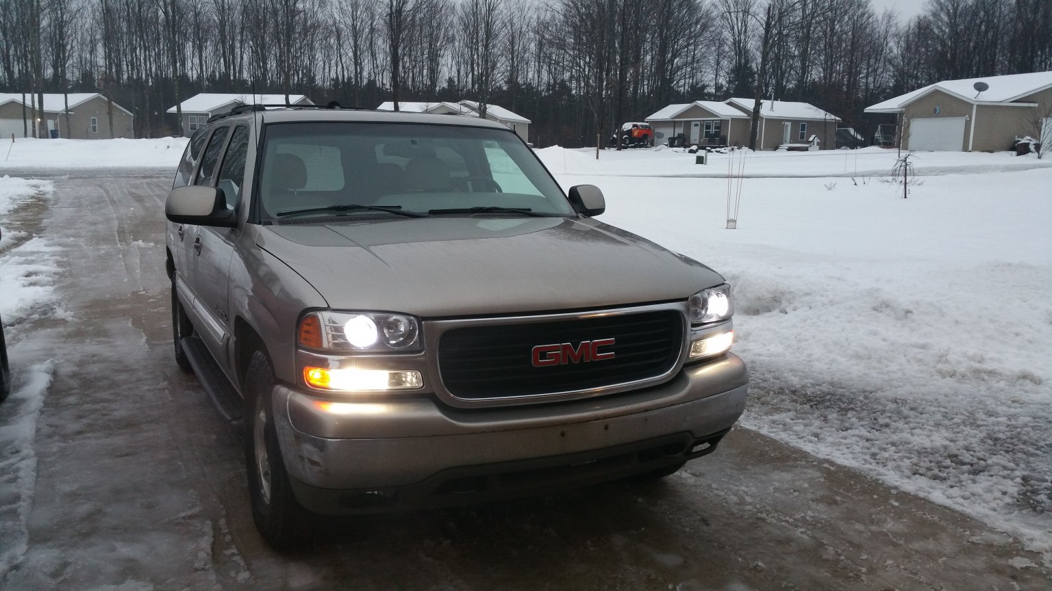

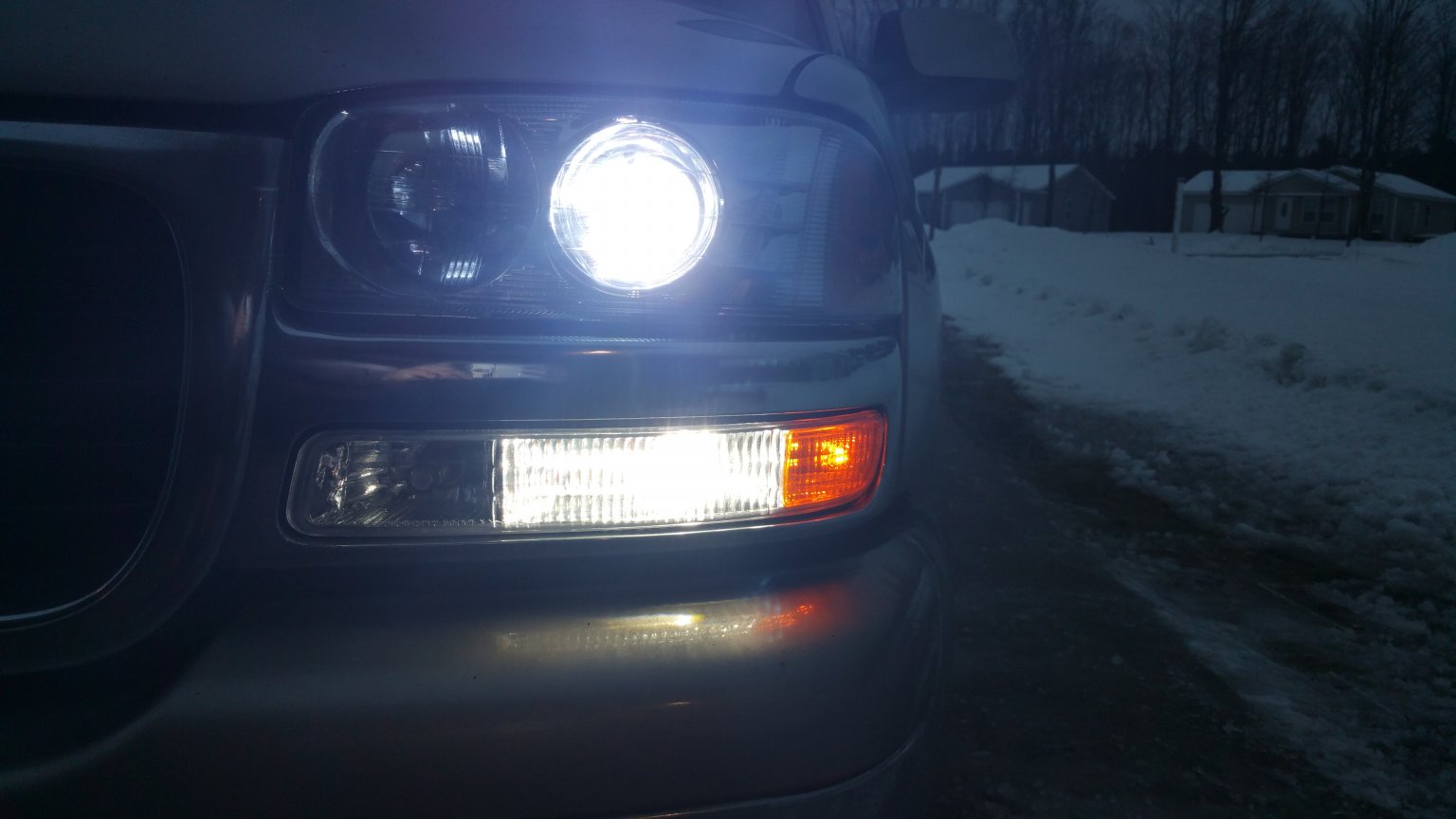

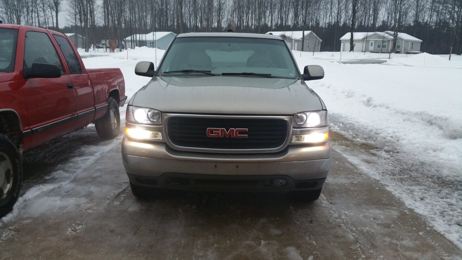

After I did some window cleaning this afternoon, I took some more shots of the new swtichbacks, and the last shot shows the cutoff of my HID projector low beams:
These swtichbacks are so bright, I'm sure I'm causing a bit of glare to oncoming drivers, but now I can read road signs now after the cutoff from the projector stops illuminating the signs.
05Single
afraid of the dark
Feb 26, 2015
8,244
11,648
On my Yukon XL, right under the liftgate, the the bodywork curves off so they would be pointed at the ground.
On mine, there is no where flat enough under the liftgate to mount a strip.
The only way I could see where one could be mounted, would be at the bottom edge of the bumper, or perhaps on the bottom edge of the liftgate itself.
Not on the body, on the top bumper pad where it angles up. There's a small lip that can be a mounting spot . Just a thought. Might work :shrug:
And I wouldn't worry about the glare from the switchbacks , no different than the bright ass Led strips on Audis and teslas.
I can use my switchbacks as dim headlights , seriously I followed a cop once at night to see if he notice and he didn't...till I turned on my signal and he hit his brakes for a second wondering how my headlight had an intergrated turn signal in it lol, had just my (full row drl delete mod) switchbacks and fog lights on only lol.
Thanks
Hope I am understanding this post.
HD hood to Tahoe = direct bolt on, No mods necessary.
OEM Tahoe hood and 01-02 Silverado HD hood both have the flat lower lip that meets the grille and headlights in a straight line across. See my build thread. I'll see if I find the HD hood master thread.
HD hood to Yukon requires modding to form fit to the headlights due to the curvature of the Yukon lights. Still a direct 6 bolts fit to the hinges.
This has been done and looks sweet, just needs a good fab job as you need to cut the hood and roll the front lip back.

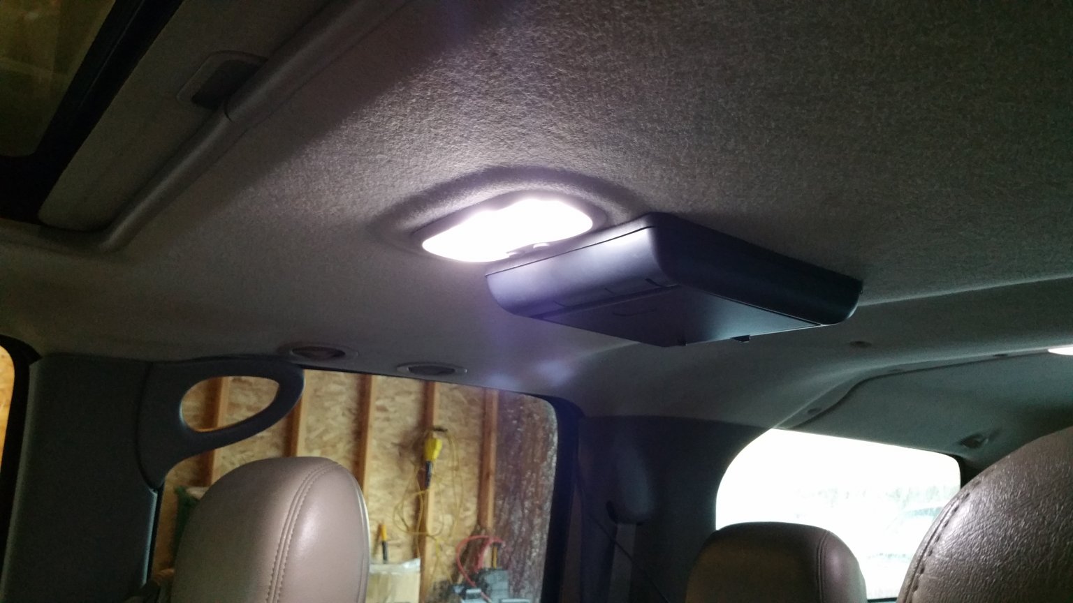

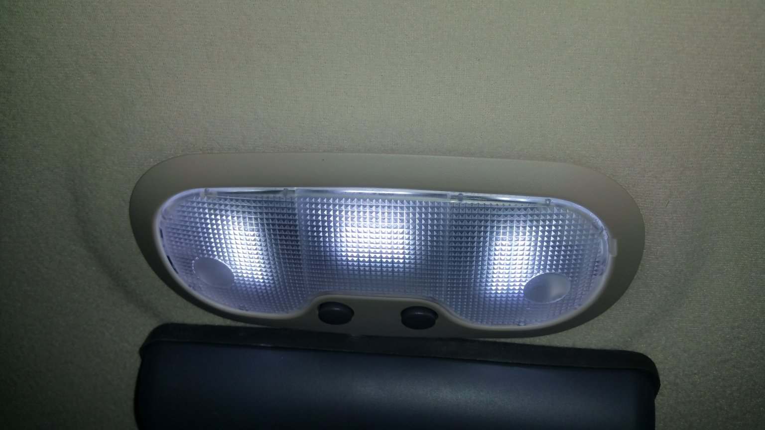

Here is another upgrade for the LED dome light:

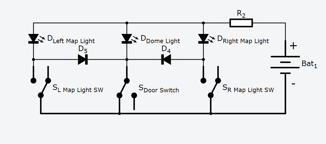

When the dome light turns on, the two map lights turn on.
I did it with a couple of diodes between the lights. Below is a schematic of how it works:
I was playing with a circuit emulator program to make sure the idea would work.
I checked the current being drawn by the LEDs in the map lights, and each one only draw 100ma.
I found some 1A 600v diodes in my parts box, and soldered them so the map lights would get ground
from the dome light ground. You want to use diodes so the map lights still work like normal, and don't back-feed into the dome lights.

How exactly and where exactly did you put the diodes, fuse box? Very interesting mod especially the all on dome.
I used two diodes and a short wire, but all the wiring is up in the dome light.
The map lights still work as stock, but they also come on with the dome light.
The problem with this mod is you can screw stuff up if you don't do it right.
You have to figure out what current your lights are drawing and make sure the diodes you select won't burn out or cause a fire.
This is an easy mod if you know how to read a schematic, because you most likely will have the knowledge and test equipment to the mod safely.
That's why I'd rather not put up the instructions on how to do this mod. I'd be too easy to mess it up.

The all-on dome mod has been done by others here on the forum, I believe there's a write-up in the tech section. It's not too hard.
Yes, there is a write-up on how to do this (you can find it here), but you don't want to just throw any old diode you have laying around and hope for the best. Worst that can happen is something catches on fire, best of the worst is the diodes pop.
You want to measure the current that your lights pull and then select a diode that can handle that.
My LEDs draw 300 mAh, so I was able to use some 1A diodes that I had in my parts box.
It looks like @mazdawg(Mikey) used a 20A diode.
Also, I soldered my connections.
EDIT: It also looks like they changed the wiring of the dome light for the newer NBS trucks (I think in '03?). It sounds like the polarity would be reversed on the newer trucks.
52,954
Yes just go overboard. I used diodes on my fog lamp and drl relays for the full time on mods. I used 25v 20 amp ones. As long as they're rated for more amps and higher voltage than the total circuit ( as in fuse size) you're good. That way you're guaranteed to be safe- the first to blow should always be the fuse not an individual component you have hidden somewhere that can only be found by following the smoke.

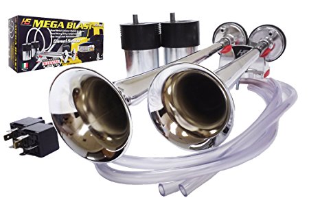

So I just bought these on Amazon:
I figured I needed something to replace the faded United we stand bumper sticker.
And the short horn is 12", and the long one is 14". (link)
