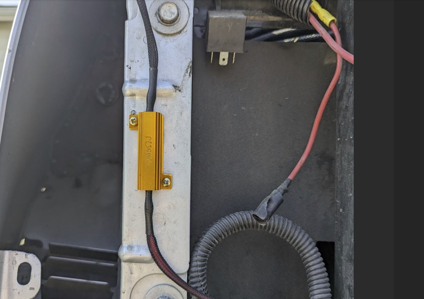

I mounted mine here

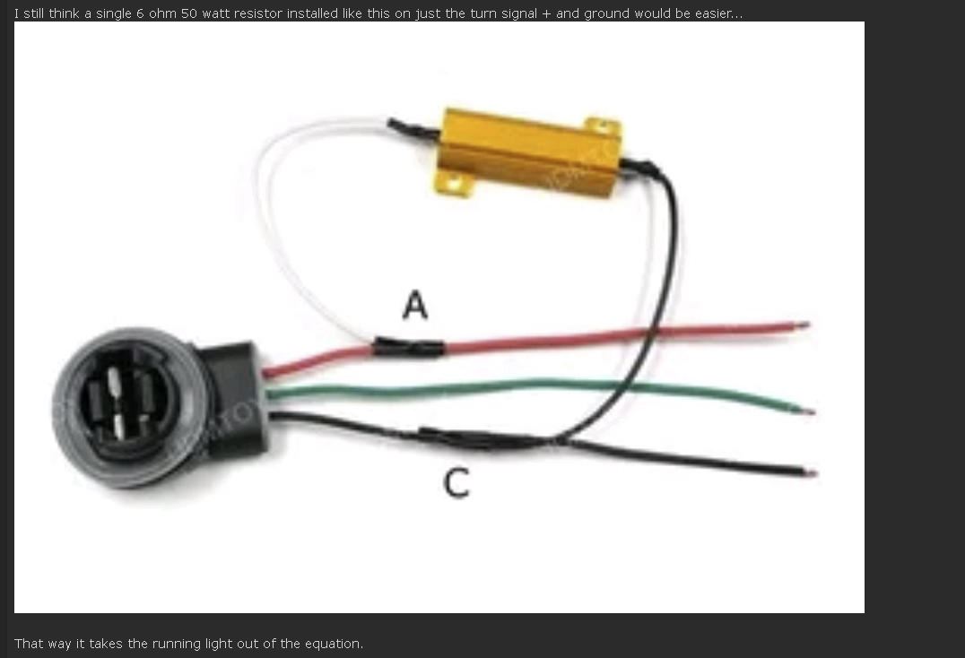

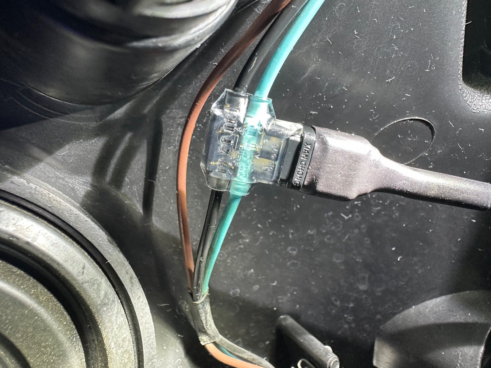

and the connection should be something to this effect

I appreciate the photos. When switching the front turn signal bulb, I was lazy and just removed the top headlight bolts--gently pulling the head light out enough for me to rotate the socket with two fingers for bulb access. Point being: I haven't thoroughly investigated yet, but that is about the same spot I considered for mounting a resistor (from my limited vantage point at the time).
I will be sticking with VLEDS and have ordered 4 of the VLR-6 (50w/6ohm) resistors, which are lower in profile (depth) but larger in foot print than the style you used. This may mean I have to do things a little differently to keep the resistors isolated from wires/etc., but I will figure something out. I should have the VLR-6s and some additional mounting plates (just in case) within the next two days.
