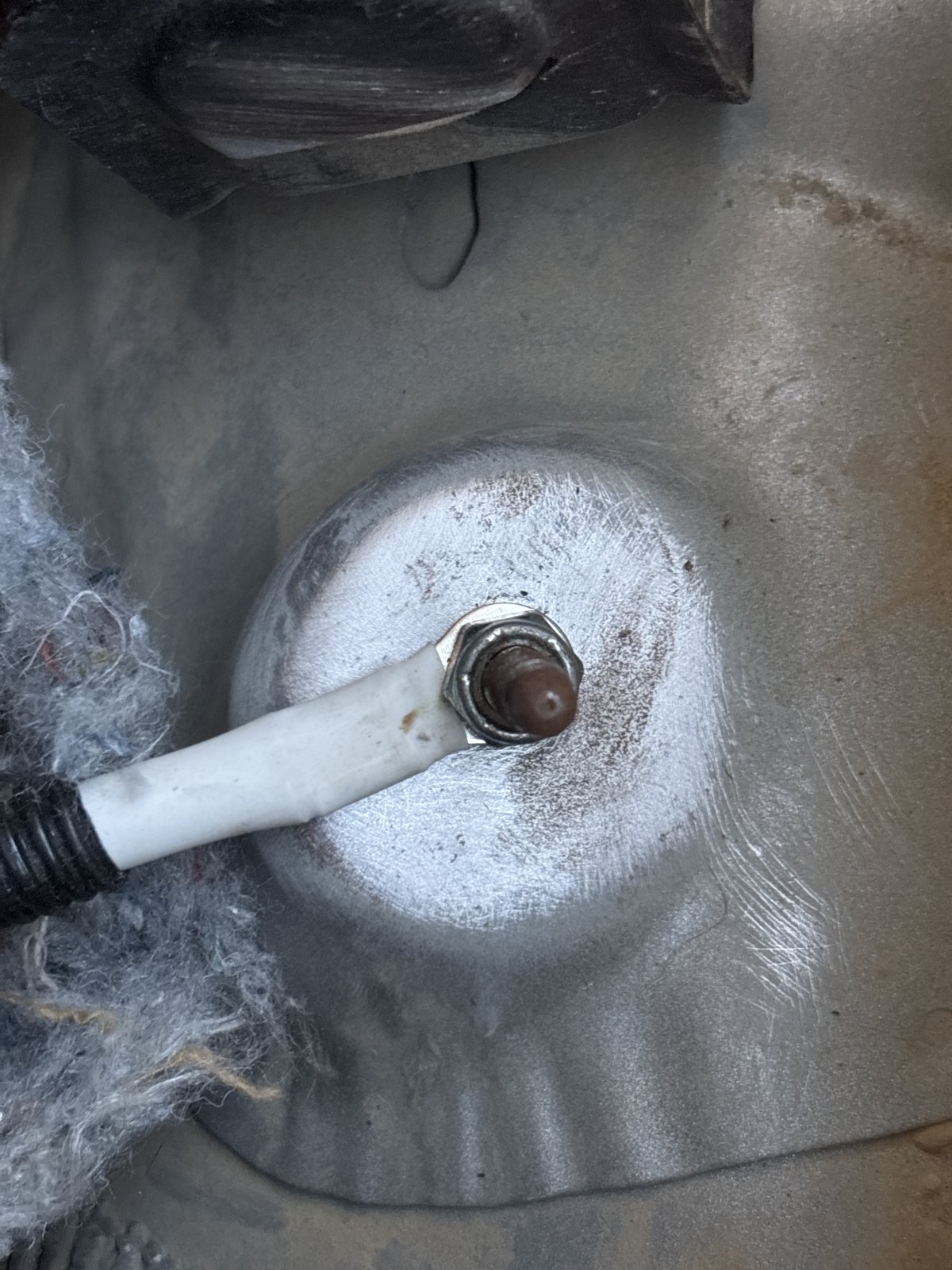

I want to walk through the timeline of what happened leading up to the battery failure.
But first I was able to successfully warranty the battery at Walmart with no issues and swapped it right in the parking lot. After installing it, I ran a battery and alternator load test using my Harbor Freight OBD2 scanner. Even though it is a basic $40 to $50 unit, both components checked out completely fine. This leads me to believe the root cause is likely an ongoing parasitic draw.
To give you the exact timeline:
The AFM Disabler: I have been running an AFM disabler plugged into my OBD2 port for years, ever since I got the truck, and it has never caused a single battery issue.
The Dash Cam (2 Months Ago): About two months ago, I installed a dash cam that runs full-time out of the cigarette lighter ports. I intentionally kept it running continuously so it could capture footage and protect the vehicle even when I wasn't in it. I didn't notice any immediate battery issues after installing it.
The Subwoofers (3 Weeks Ago): About three weeks ago, I wired up my subwoofers. The amplifier pushes around 1,000 watts. Before installation, I did my research and confirmed that the factory system should be able to handle this power without needing a 'Big 3' upgrade. I properly prepped my grounds by cleaning the metal down with a steel brush attachment on my drill to ensure a solid connection.
Initially, there were no warning signs—no slow cranking or power issues. This failure seemed to happen completely out of nowhere. The only warning I had was one slightly slow crank leaving work the day before the truck completely refused to start. Because it happened so suddenly, I am not sure if this electrical drain was building up over weeks, or if it is a sudden, major parasitic draw.

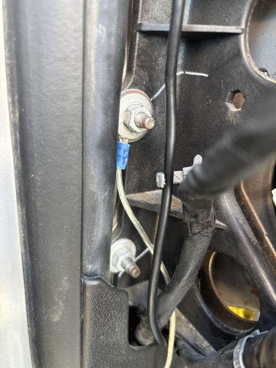

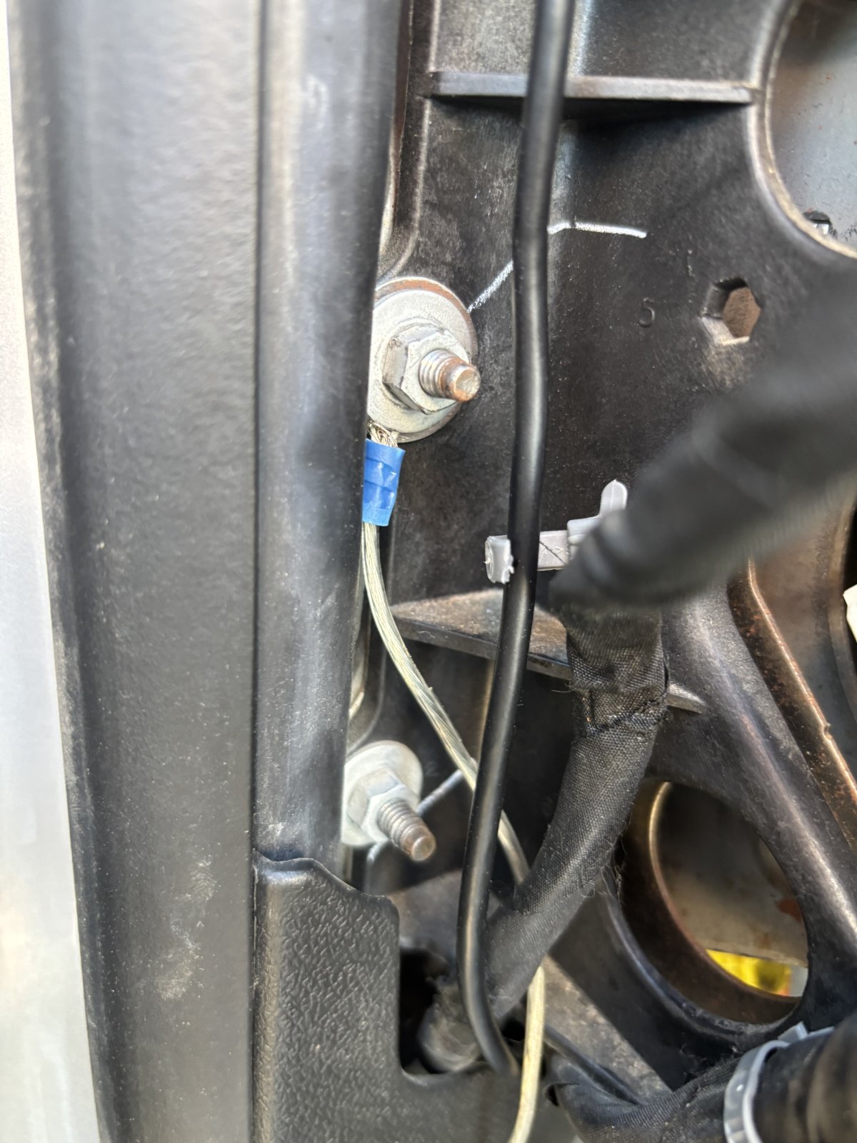

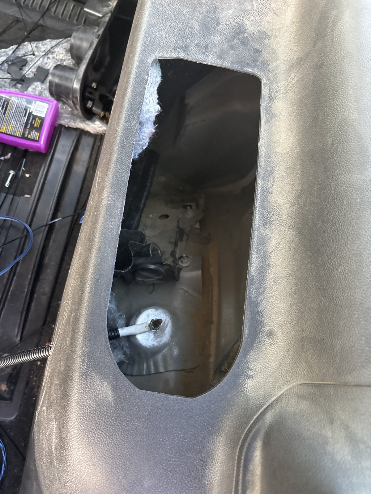

So the ground to my LOC here is grounded to a bolt in the kick panel. It doesn’t look cleaned up, but I cleaned it up on the back with a file to get bare metal now this might not be a reliable location? I don’t know if this was my issue. And then photo three and four here is where I have the main ground to the amp in the back here over the driver side wheel wheel. Just want to say that whenever I get out of the vehicle, the amp and the LOC shut off like I watched the lights on them shut off and that’s what I wanted to do so that leads me to believe it’s not the subs?

Everything's a (educated?) guess until you get an ammeter inline with the negative battery cable and verify the parasitic draw. If there is one, then continue with the appropriate test procedure to figure out which circuit is drawing current when the vehicle should be asleep.
If you don't feel like doing that, a thermal camera might help determine what's hot and what's not.

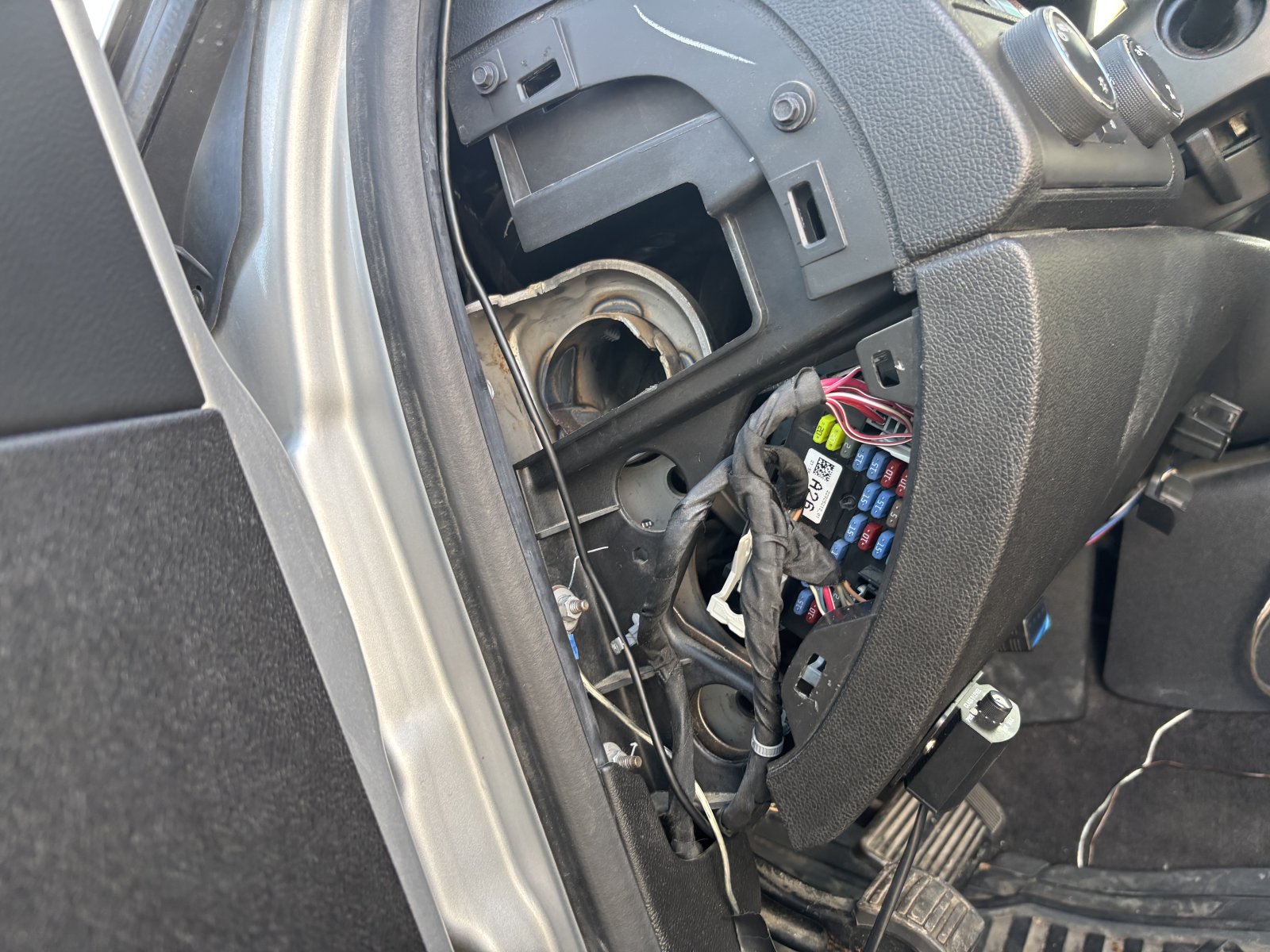

As some of you know I currently have my aftermarket audio remote/trigger wire pinned into the switched accessory power at the X14 block under the dash, and it works perfectly. I want to move my dash cam off the constant-on cigarette outlets so it stops draining my battery when parked. This is what @Doubeleive recommended. So wondering if it would work for my dash cam to
Can I splice a 12V female cigarette socket adapter directly into that same X14 switched power circuit that my audio trigger wire is using?
My plan is to hide the female socket under the dash, plug the factory dash cam adapter into it (to drop the power safely from 12V to 5V), and have both the audio gear and the dash cam turn on and off together with the key. Will sharing that switched circuit cause any interference issues with the audio turn-on signal, or is that a safe way to do it?
