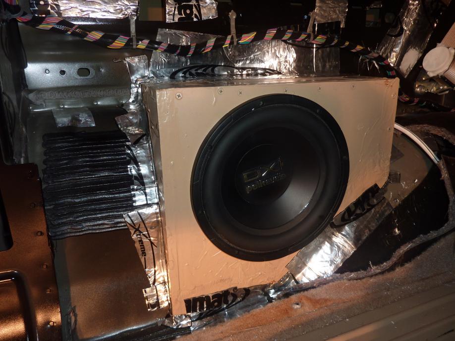

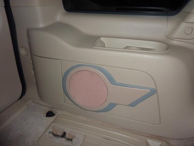

Final two pictures.
Sub just before I put the quarter panel back on and then the quarter with the grille I made. I wanted to do just the top part of the grille (tan with the brown grille cloth) but I made the hole too big on the plastic for the other grille I had made that I didn't like. So I had to make a bigger piece to cover that first then lay the new grille on top of it.

Talk about sleek install, good job!!!
I do want to know how you attached the box to the metal behind it?
Or how does the box stay in place?

the box is form fit to the back obviously, so all I did was put silicone on the box itself and some on the metal, then set it in place. Then I wrapped all the edges with about 4" wide strips of dynamat which serves a couple purposes. First, it further deadens the metal, second it helps hold the box in place and third it prevents any inadvertent air leaks. There were a couple small ones after I had to redo the side of the box. In the photo of the sub and box, the left edge was actually cut off and replaced with a piece of 1/4" masonite and then glassed in place. That gave clearance to that little pocket on the panel.
