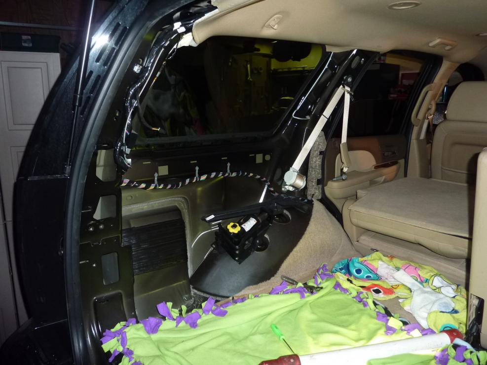

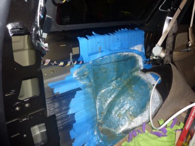

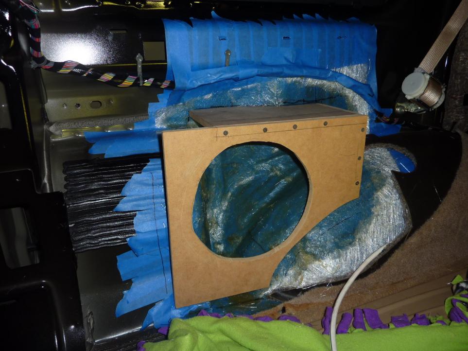

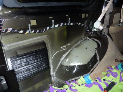

Here are a few pics. Sorry it took me so long. Not going to work on it today but I'll be back at it again tomorrow. I thought I had a pic of the grille I made to go over the side quarter panel but I can't seem to find it. I'm not really happy with it anyway and will probably make one out of fiberglass instead, but I need more hardener and Home Depot is closed today. I'm hungry anyway, I neglected to eat for 2-1/2 days aside from a small dinner.
Have a great thanksgiving everyone.
Edited to say, pic 3 is what it looks like when you start, with the jack under there. Pic 1 is the jack removed. Pic 2 is the quarter all taped and the first layer of glass and a layer of mat & glass just before I popped it out. Last pic is the top, side and front put on during a test fit.
