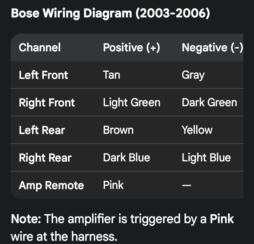

As I just finished a complete system in a 2019 silverado. Since you hacked it up make sure your steering wheel controls work and just rewire the door speakers from your new amp to the wires behind the radio that go to the doors. Forget trying to get your factory bose to work you can run 2 runs 9 wire from amp to dash. That will handle the remote turn on wire for the amp and all the door speakers, B pillars. Here's the color code for your bose amp if you insist on trying to get it back to working.
