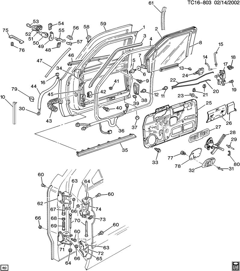

I need a part the holds the rods for the interior door latch and lock on the inside of the front door of a 1999 Tahoe 2 door. It is item 21 in this picture. They are flat disks that fit in place sideways then rotate to lock into position. They hold the bars that connect the lock and latch to the door interior controls.
Does anyone know where I can find these?

You were almost there with the diagram. When you pull that up and know the item number, scroll down the page where the parts are listed. I found the diagram and came up with this part number:
Search eBay, Amazon, etc. for 15053341. You'll see it at times as a superseded number.
Here's one listing but there are others:
On the page where I saw the diagram that part number was skipped. I went from 20 to 22. Where did you see the info in your reply?
