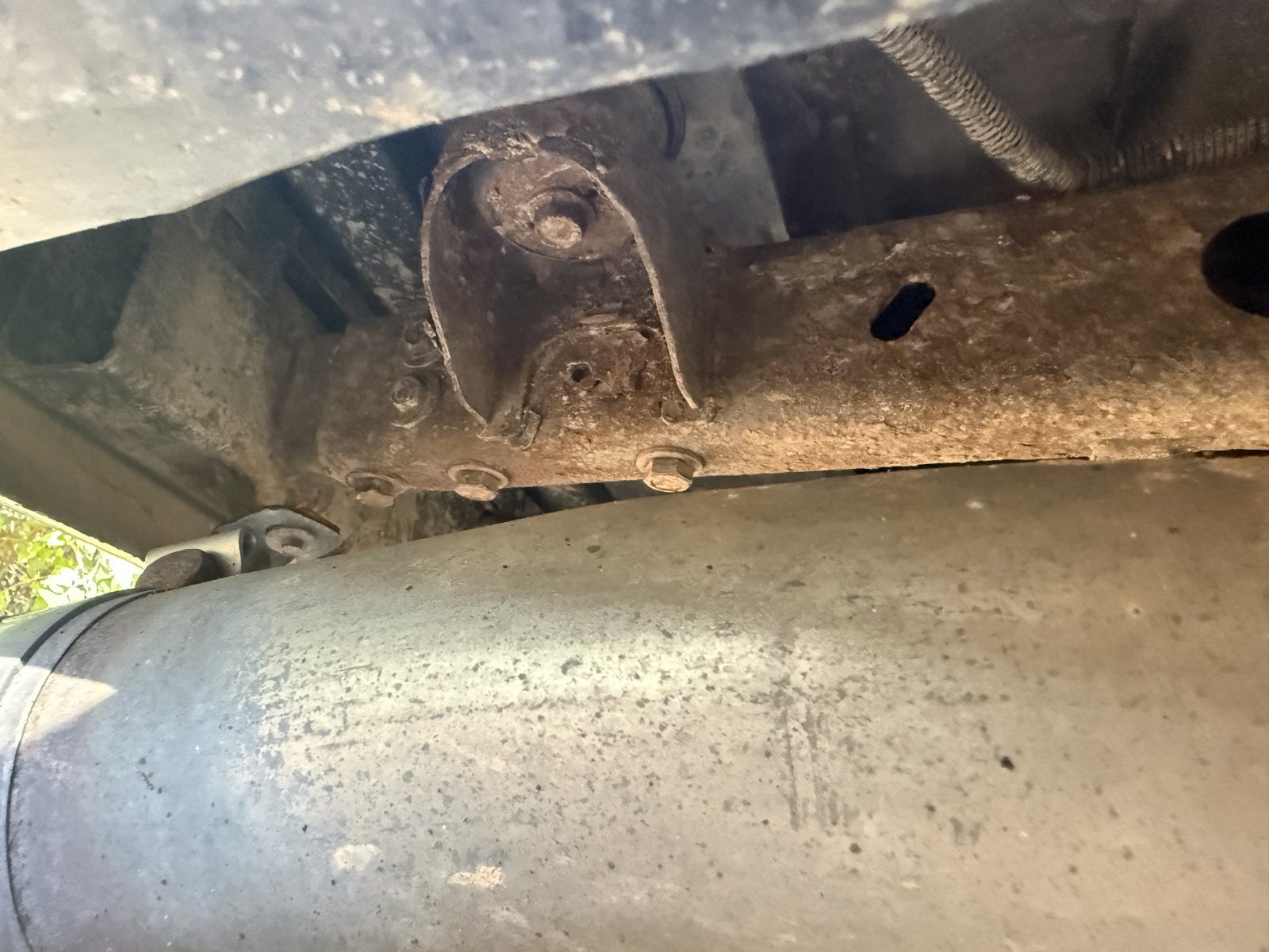

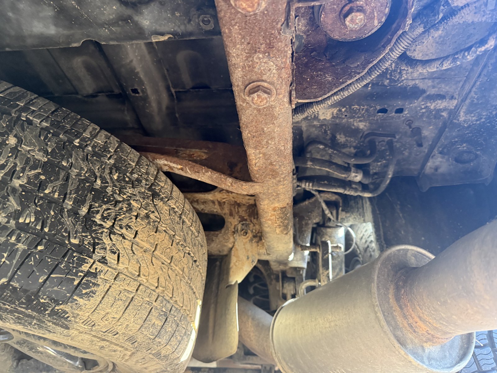

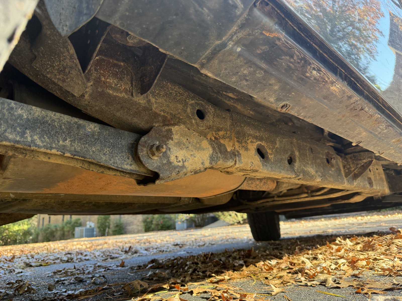

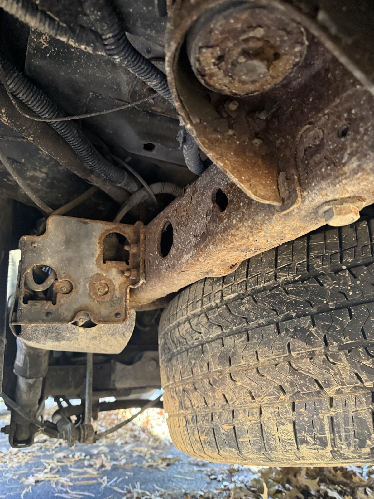

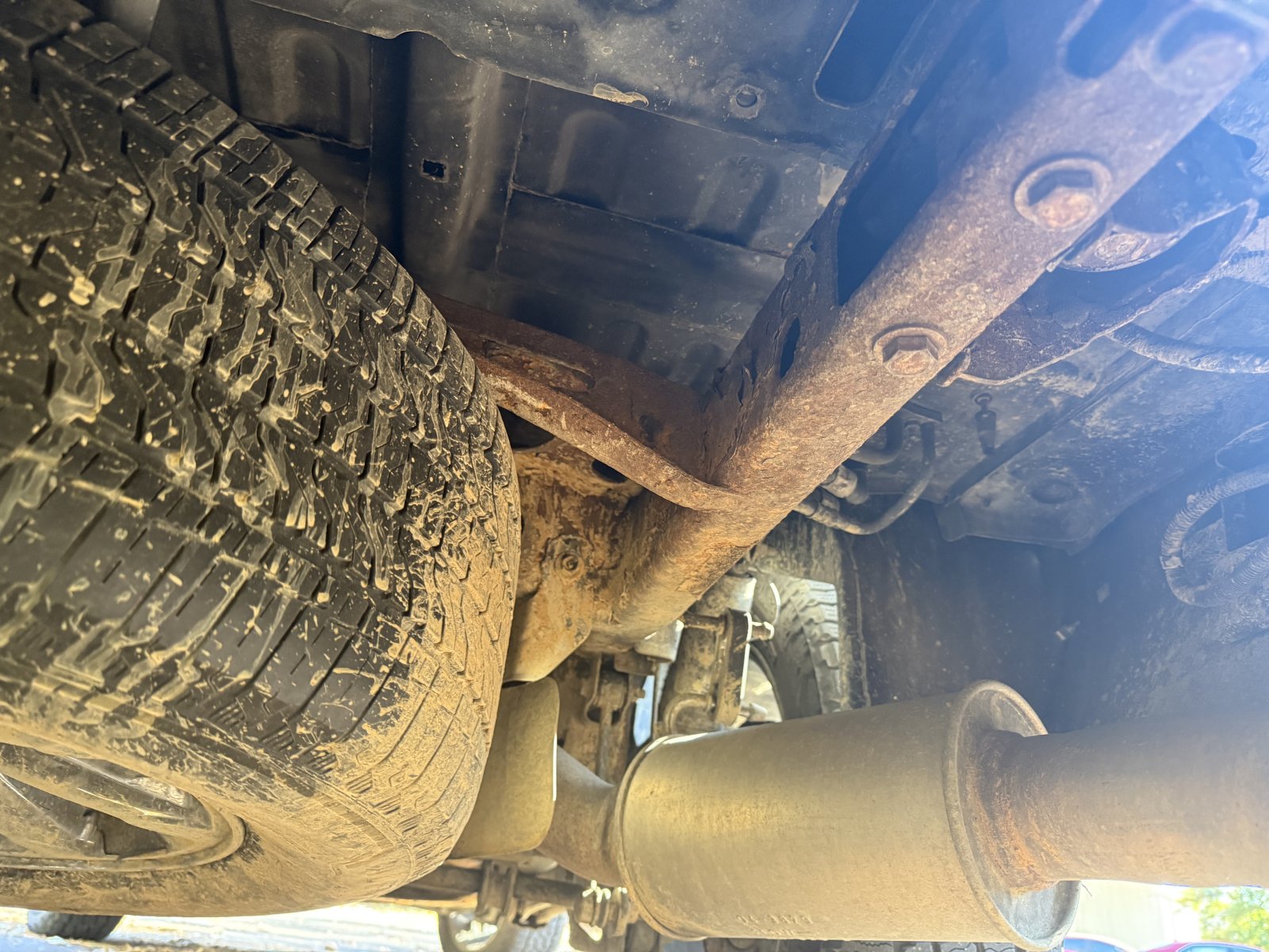

I would hope so. I got some frame pics here. It gets spicier as you go back. The oil leak that I fixed when I got the car had the front half of the frame looking mint.
Maybe I'm crazy (or midwestern, what's the difference), but most of that rust doesn't concern me, and the "flaking" is just the original frame coating starting to come off. Dunno, though. Opinions welcome...
View attachment 472042View attachment 472040View attachment 472041View attachment 472045View attachment 472043
Thats just scale. What I do every year in spots that are like that I'll wirebrush the chunky stuff off and then undercoat it. I dont do alot of prep work underneath because of the conditions it'll see but It will last all winter and will need touching up again next fall. Just my PM schedule. Like your truck to me is a pressure wash and spray it black look
Another way is to needle scale the whole truck which is best done on a lift for saving of the back.
