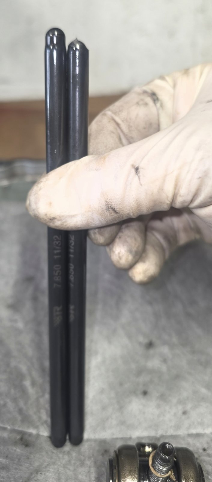

My pushrod ate it and sounded like that just not as loud
My sound wasn't as bad but very similar
I just threw in a replacement rocker and pushrod some lifter additive for good measure just in case and its runing fine now
