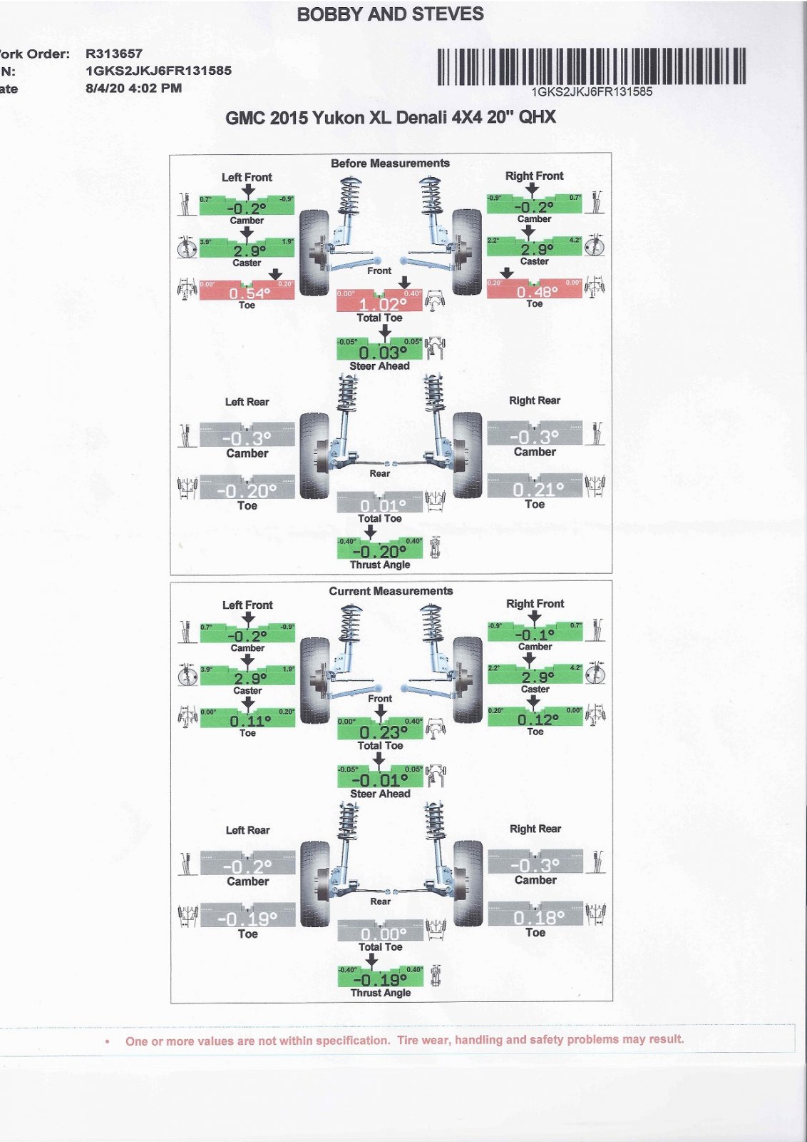

Hey guys/gals,
When you had your alignments with 1.75" - 2.50" did they pop out the OEM retainers for camber and caster?
I went with suspensionmaxx 1.75" and figured they this would have changed the camber and caster if the strut is pushing the lower control arm down further, no?
Attached is the alignment before and after.
Also noticing a shake around 60-70mph range that i'm thinking is a mis-balance. My right rear is leaking about 1-2psi/day as well. Think that could be the crap oem rims or tire pressure sensor? What advice to resolve this - bring it back to the alignment/balance shop?

I suspected a caster shimmy but they are even and I always say there should be a RF caster lead, like instead of 2.9 up it to 3.4, for road crown. Does it wander?

I didn't do the math, but 1 degree toe seems excessive. Also noted your before/after numbers on rear changed, usually meaning tech bumped system to green light your ride. Toe and Go. At least he went in right direction for you.
I completely agree about the rear and may have a thrust angle problem. But the toe in is .1 degree which is fine. Not 1.0 degree.

Appreciate the responses. Lubing up what I can find for serviceable on the suspension. Two different ball joints, a replaced UCA and CV axle on the DS.
Still, didn't have shimmy or shake before these tires M/B even driving the with previous tires the in the 15 miles to the alignment/leveled. Braking is smooth and accel is smooth but 30mph and intermittent up to 75 (different speeds) you feel it at times.
Hub bearings have been replaced and are good. Tie rods, steering, bushings all good.
Going to bring it for a rebalance and what should I request if at all on the F/R alignment?

PNWVietVet- Screwed up while posting- At least he went in right direction. Flipped before after in my head while typing. You caught it though.

Yea, at this point I feel it is in the tires. I would also ask why the alignment tech did not give it a lead of about a 1/4 to .5 degree lead on the right side for road crown. Even is never recommended.
