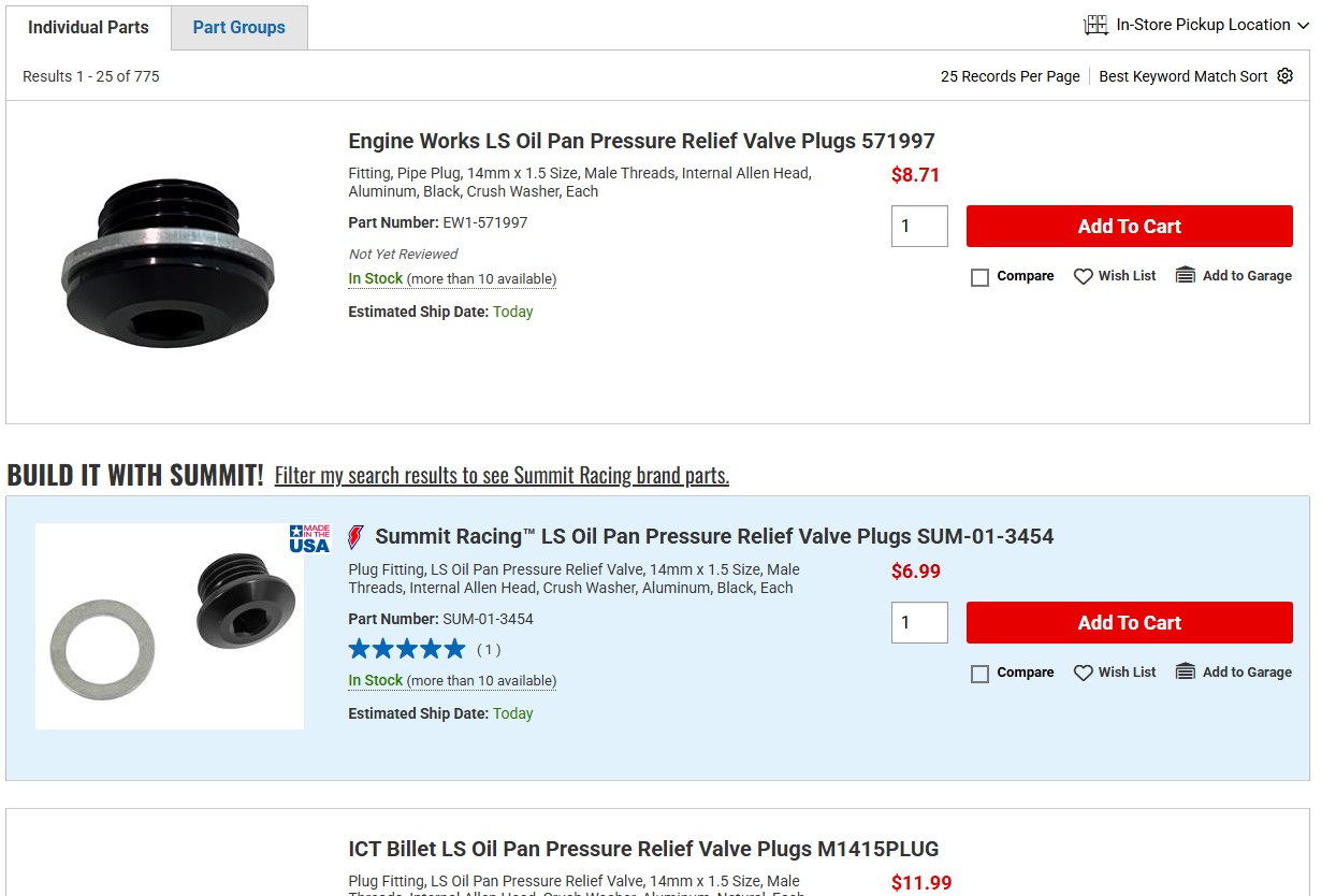

Summit Racing sells them for sure, made specifically for that purpose. Just order the delete plug that is specific to your motor.

I couldn't find a size M14 1.5 pitch bolt at any hardware stores... Then this comment popped up in my brain. Dorman sells a M14 x 1.5 oil plug at auto parts stores that is the perfect length and has a crush washer.
