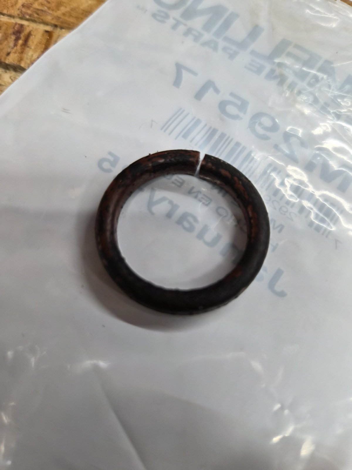

Beg to differ on the difference the o-ring makes. My truck suddenly went from barely good to low oil pressure warnings. I dropped the pan and replaced the o-ring plus cleaned a bunch of gunk out of the bottom of the pan and now my oil pressure is the best I've seen it since I bought this 300k mile truck a year ago.

what did the o ring look like?
I'll add you to my list. which is now up to 3 people that have changed just an I ring and noticed any useful difference.

The ring was flattened and darkened plus it was split on one side and the inside looked much less darkened.

Seems like changing the o-ring is what fixed my problem. Mine was pretty flat and wider on one side, and a little less flat but still clearly not round around the rest of it.
I will repeat what my mechanic said when I called him to see if I should tow it to him or was it something I could fix. He said 90% of the cases with these, it's the oil sender, other 10% it's the o-ring, and he almost never sees an oil pump go out. His cheap test for the o-ring is to look for bubbles on the dipstick. Otherwise customer would have to pay for a pressure test to get a better diagnosis. Starting with oil pressure and then losing steadily until it drops to zero is one symptom. I've seen other people online say pressure starts low in cold weather and then as the engine warms pressure increases. Perhaps this is up until the o-ring is so bad that it just flat out fails like mine did. I dunno.
I suppose changing the oil pump to a higher flow one can mask a failing o-ring too, at least for a time. Who knows. All I know is my pressure is much better all around, and it doesn't drop while driving anymore.

The bad O rings I have actually touched had become very hard, held the shape after removal showing flat sides and no longer rounded like a new O ring. One was at 270,000 miles, that was the highest mileage failure I have seen. A buddy owned that truck since new and was very good at regular oil changes.
