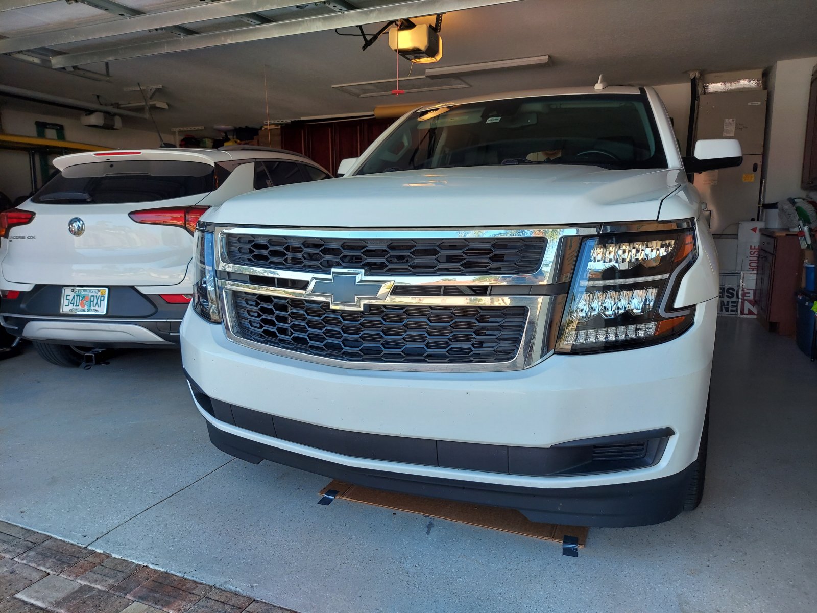

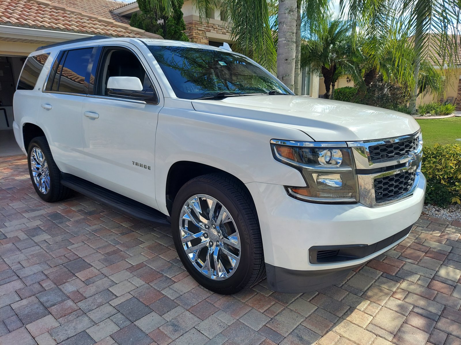

My 15 model is running Gr8! Of course there will be things you need to do... The AFM really helps. I have done these mods also...
Trans cooler thermostat replaced with the continuous circulation module, keeps tranny much cooler.
Changed Tranny fluid and filter. Much smoother acceleration.
Oil change with filter.
Replaced headlights with Anzo LEDs. The original low beams were horrible.
22 inch wheels/tires, and I am getting 19 to 20 most of the time.
Replaced plugs, coils and cables.
