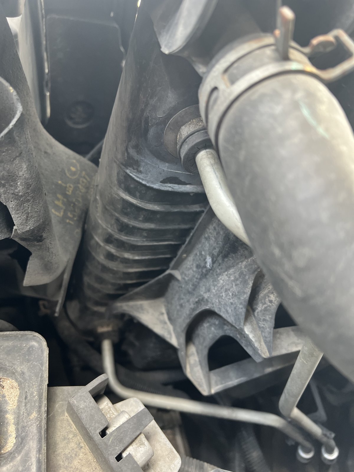

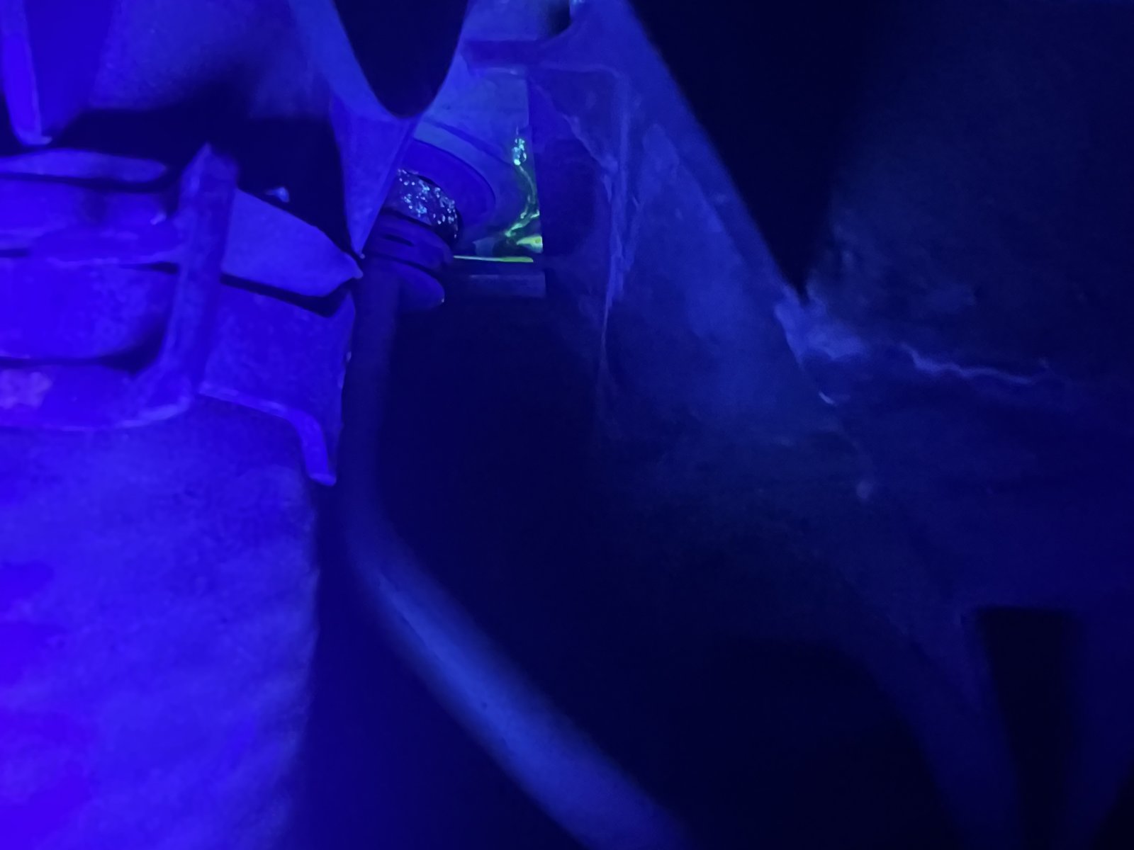

I have a 2012 Yukon Denali it has around 220K miles. I have had it for 110K of those, since December 2016. I have noticed a small coolant leak, long story short i got some UV dye and was only able to find it in one spot. Not a good picture, but it is around the top drivers side on the radiator. looking through the forums and google looks like this is a common failure.
I am not looking for more work then needed, but I figured it was time to replace the radiator, and looking what else i should do while I am there. I guess that plastic T on the firewall, (I have not gotten the part number yet) the hoses, the thermostat. Water pump is old, but no issue with it yet. i might replace it now, may not. i read maybe i need new orings for the oil or transmission cooling lines. the idler pully and belt also look good, but I may replace them while I am doing it. I don't want to start replacing things just because, as i could always use that money for something else. I also don't want to not replace the obvious stuff that should be done or needs to be done. Now on the radiators, I have several thins. some say only buy ac delco, some say Denso, yet others point to some of the all metal ones on amazon, like these https://a.co/d/0ep2vKNc https://amzn.to/3TltaxN https://amzn.to/4vkgpB9. the thing is besides the brand, I am not sure if i need the 3 core or 4 core, and i have not verified if mine has the oil cooler in the radiator, or only the transmission. I also have a disability that somehow lets me look and order the exact thing i need until it arrives and reality warps and it morphs to the wrong part as i overlooked something stupid or something. and it does not matter how many times i check and recheck before i order it... anyway some help and recommendations on what to order and replace are appreciated. I don't have any issue doing the work myself, just want to make sure I have everything I need so I can finish it when I start and not be down a car. thanks

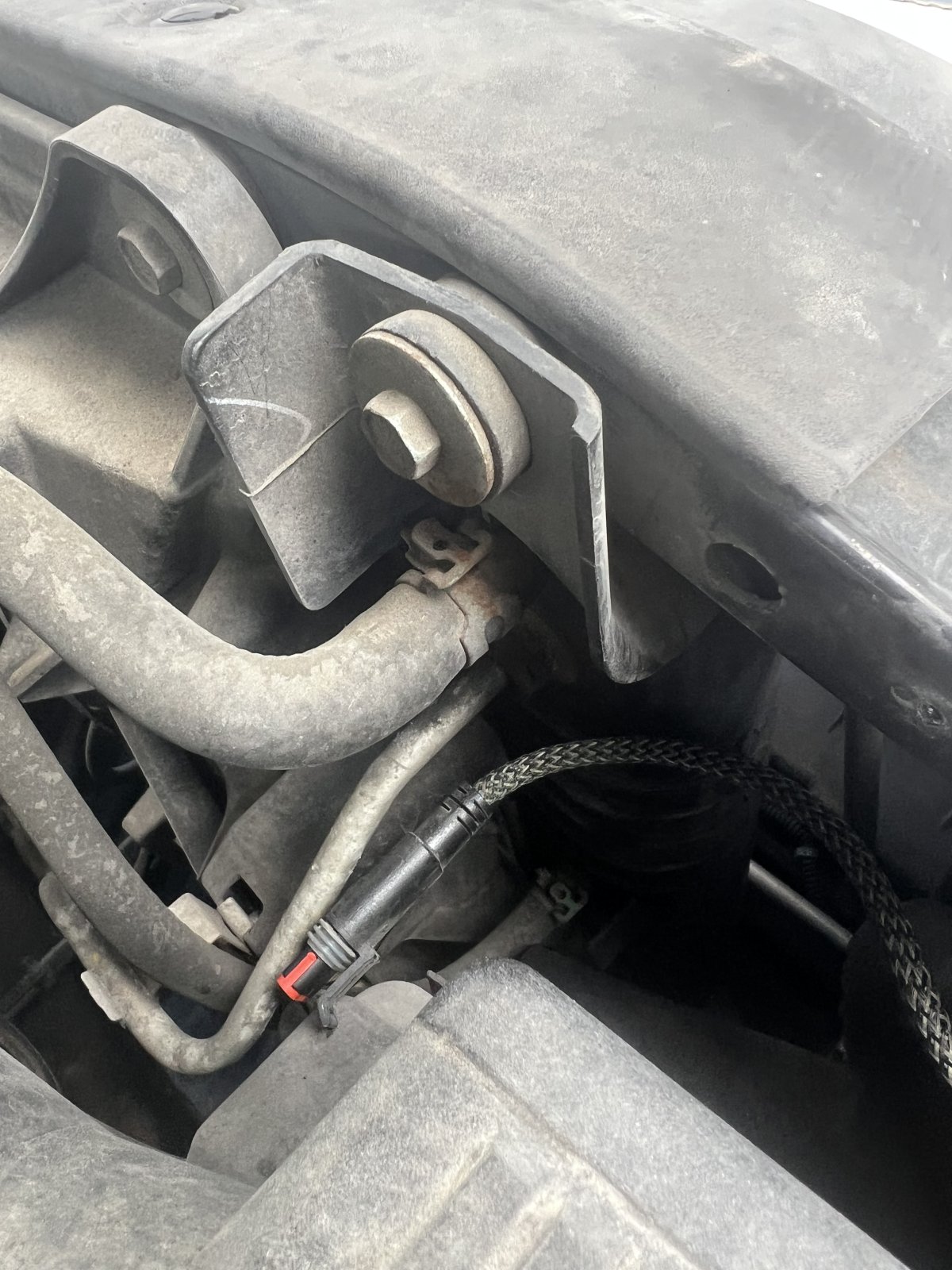

ok thanks this is what i was trying to figure out. i do have lines going into the radiator on the drivers side, and the passenger side. so the passenger is the transmission and the driver is the oil? sorry she is dusty and needs to be cleaned. had to make a couple trip to the farm over the past week. it is normally not as dusty under there. :)

ok thanks this is what i was trying to figure out. i do have lines going into the radiator on the drivers side, and the passenger side. so the passenger is the transmission and the driver is the oil? sorry she is dusty and needs to be cleaned. had to make a couple trip to the farm over the past week. it is normally not as dusty under there. :)View attachment 488846View attachment 488847
You got it ! Orielly etc now sell the dorman upgraded all metal heater hose tees
right off the shelf, so no hunting anymore. And they are reasonable $$

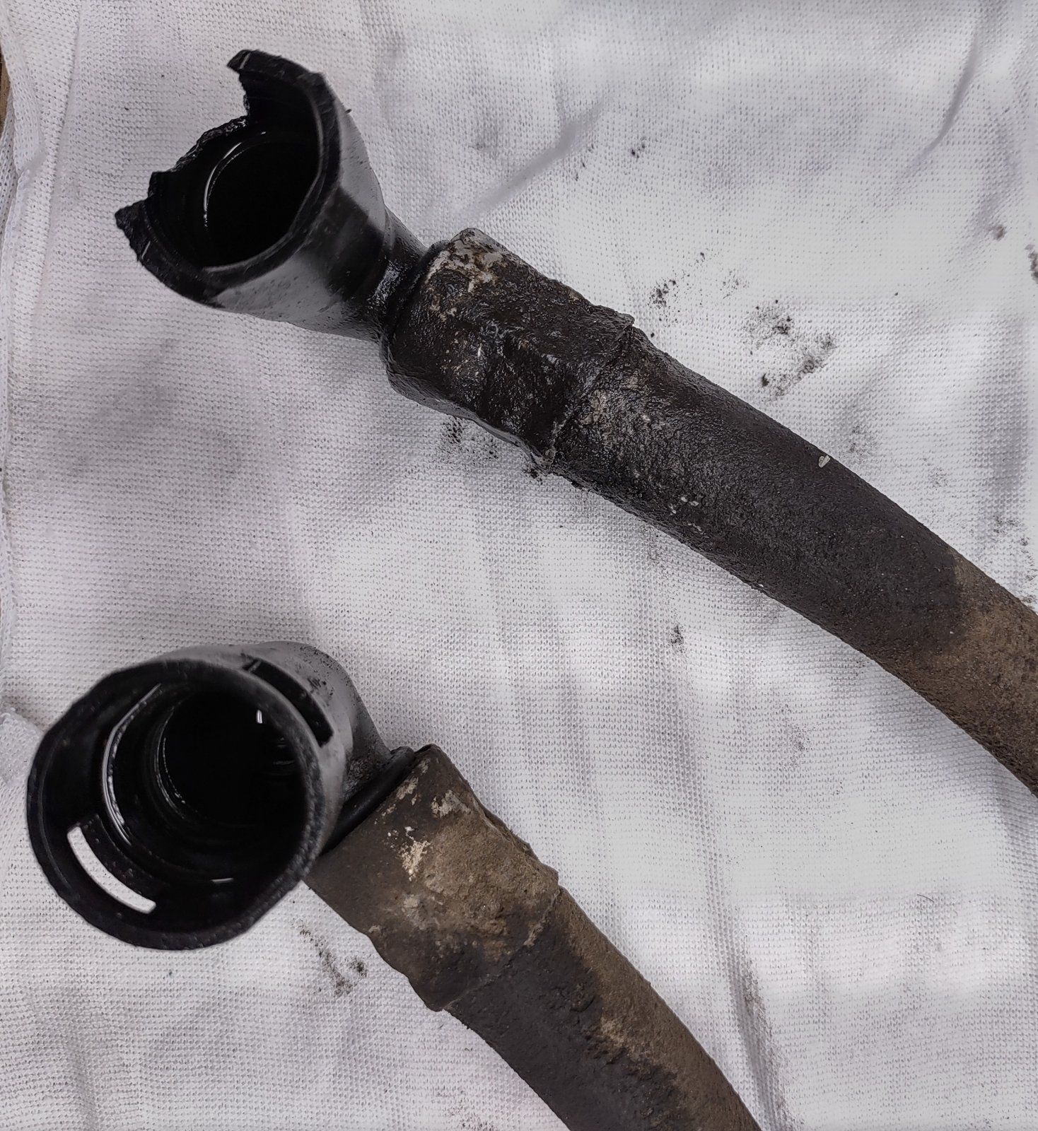

.... And don't forget the two heater hoses behind your right rear tire! Especially at your mileage, they're not long for this world.... And when one goes it will empty your entire cooling system rather quickly.
i hope that is a joke, not sure why there would be a heater hose behind the right rear tire, but it would not surprise me knowing what some manufactures do.

The picture below was a set of rear heater hoses changed at about 170,000 miles.... Plastic connector broke just by touching it. I'd hate to see what yours look like at over 200,000... So yeah, terrible place to put a couple heater hoses. But on that link above, you'll see what you need to do.
rdezs
Nov 6, 2023
1,405
2,631
As you can imagine, it's nothing you want to deal with out in the middle of nowhere in the middle of the night.... With all your coolant running out the back of your vehicle. That alone puts it high up on the "preventative maintenance" list in my book....
