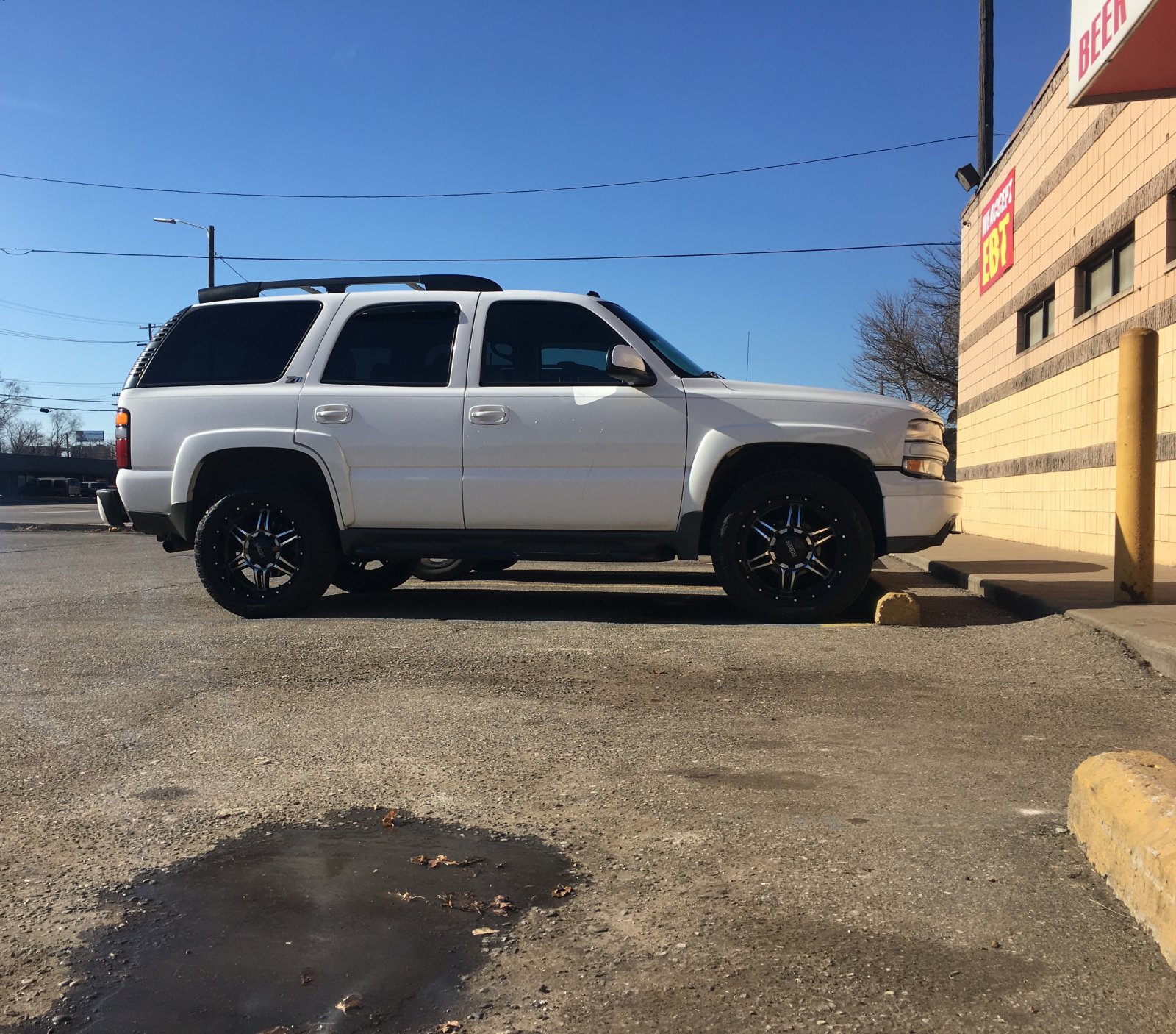

I bought my 2004 Tahoe z71 4wd in October 2017 with 149k miles
Currently at 176k miles
It’s in the shop now to replace a leaking water pump
When I bought it, it had a bad oil pressure sending unit-had that replaced
Shortly after had a leaking rear pinion seal fixed
At 168k miles had both front hub bearings replaced as they started the helicopter sound
Recently had a cat that went bad and had the a/c serviced
Nothing too major and I switched to Mobil-1 high mileage 5w-30 ever since I got it and have kept up on oil changes every 5k miles
What can I expect going forward with the truck creeping up on 200k miles
It’s a daily driver of 60 miles a day so mileage adds up quick
It’s had a minor oil leak ever since I’ve got it. Having that looked into while it’s in the shop. Going to have them run the dye through it. Always kept an eye on the oil level. Takes about a quart, sometimes a little more between oil changes

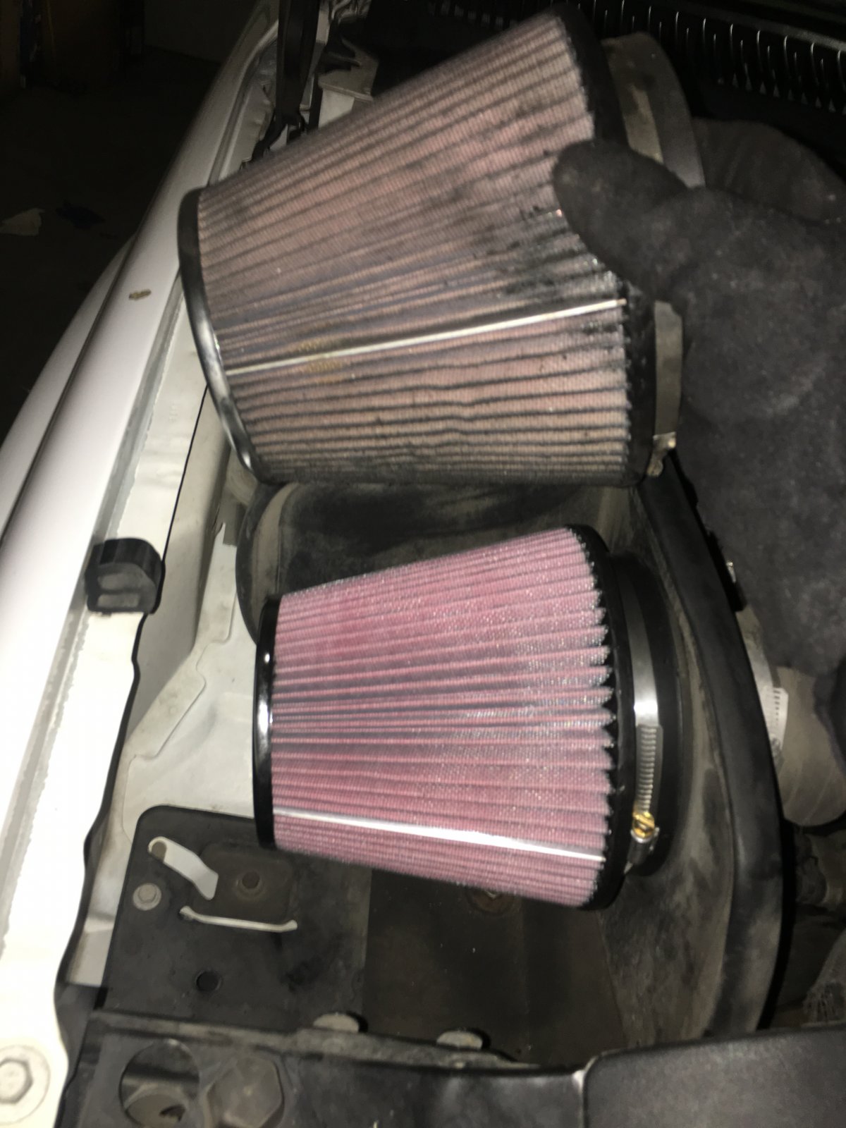

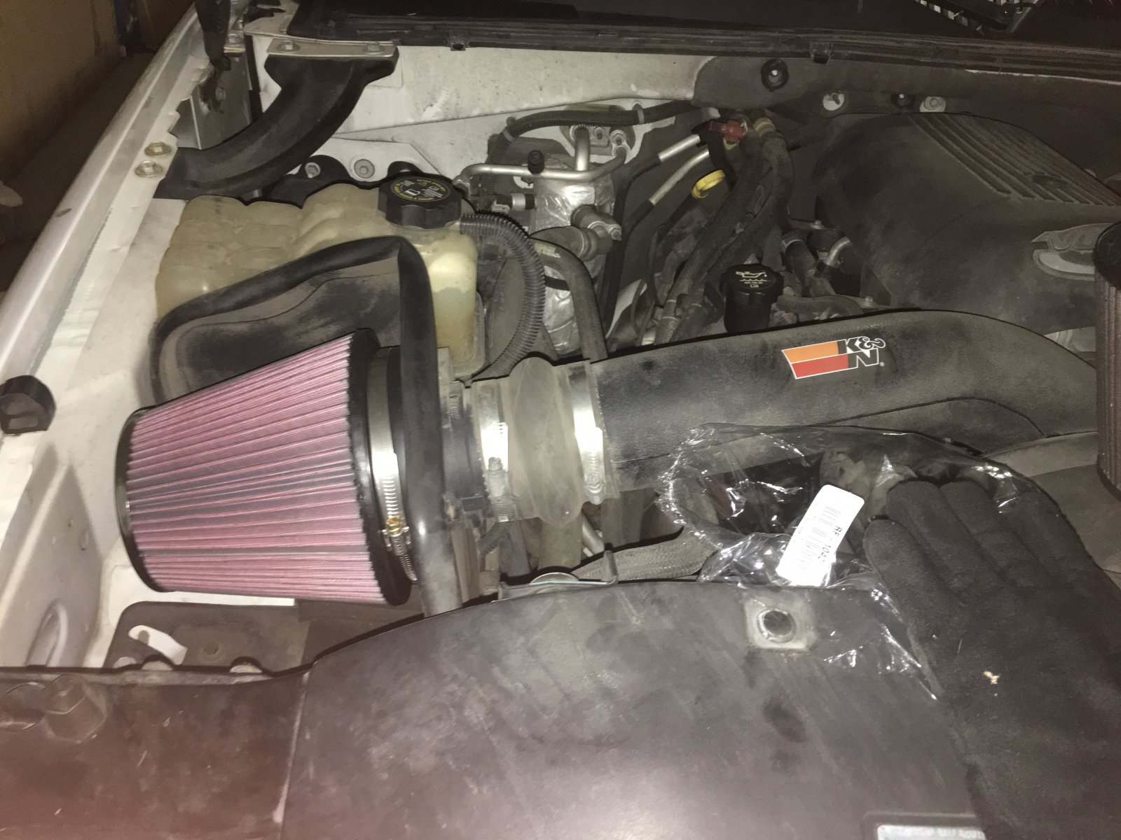

I have a k&n cold air intake but look how dirty the filter got from oil flinging up onto it from my oil leak I believe. I got a good deal on a filter so I bought a new one but I also bought the cleaning kit to clean the old dirty one. Now the new one is getting pretty gummed up with motor oil

View attachment 225765 View attachment 225764 I have a k&n cold air intake but look how dirty the filter got from oil flinging up onto it from my oil leak I believe. I got a good deal on the filter so I bought one but I also bought the cleaning kit to clean the old dirty one
k&n makes a dry filter also, the oiled filters are reported to mess with the maf sensor and that could be the reason for the funky shifting, even if it wasn't from the filter oil it could be the maf taking a dump my experience is I see them going bad around 160k

Yes- clean the MAF and check the inside of the tube for dust by swiping your finger on it. If you wipe off dust, your filter isn't working so well and that same layer of dust is on your MAF wires, skewing the air flow info to the PCM.
