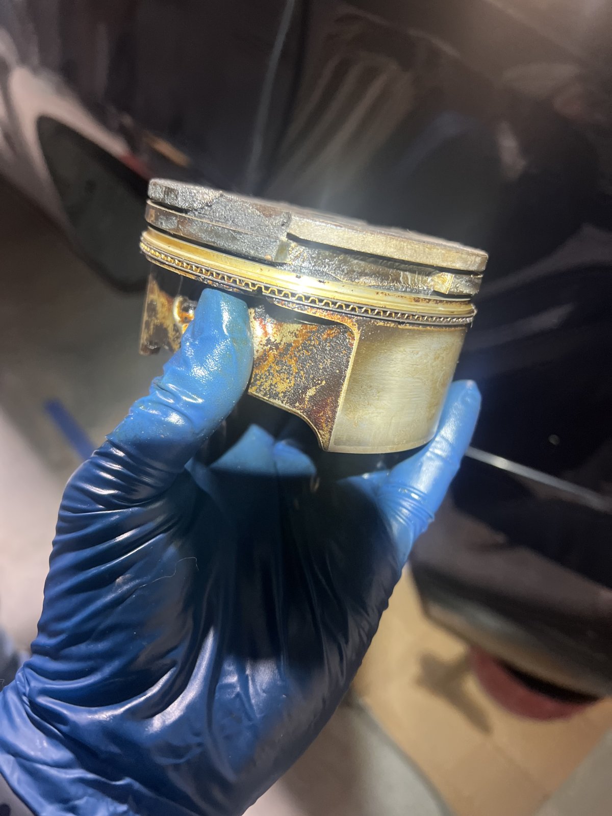

You put a lot of work into bringing that rig back to life. Can I ask what happened to your broken piston and curious what your hot idle oil pressure is with the new oil pump. Nice to see you revived rather than buried that rig.

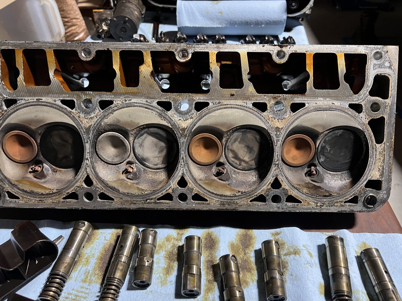

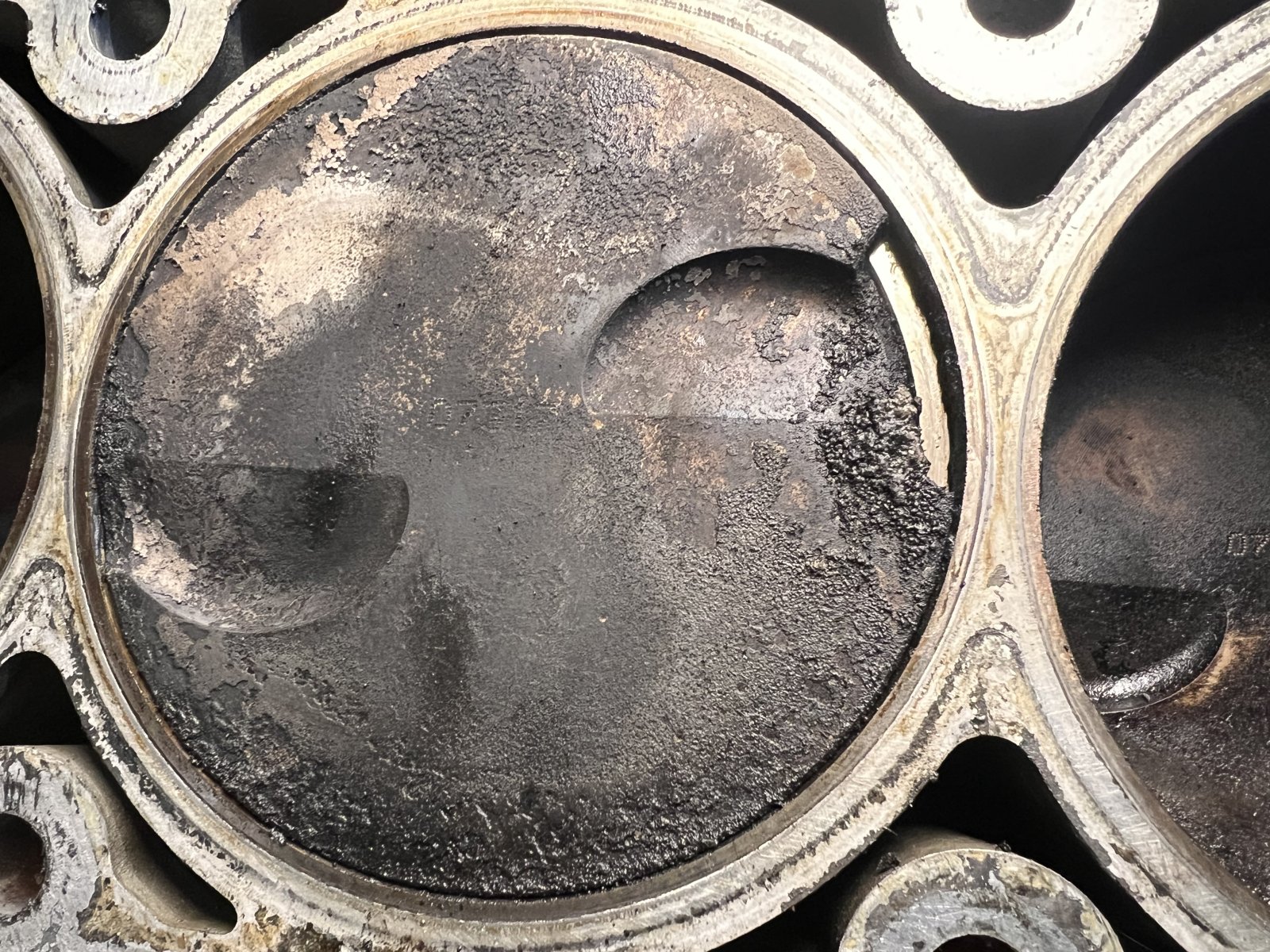

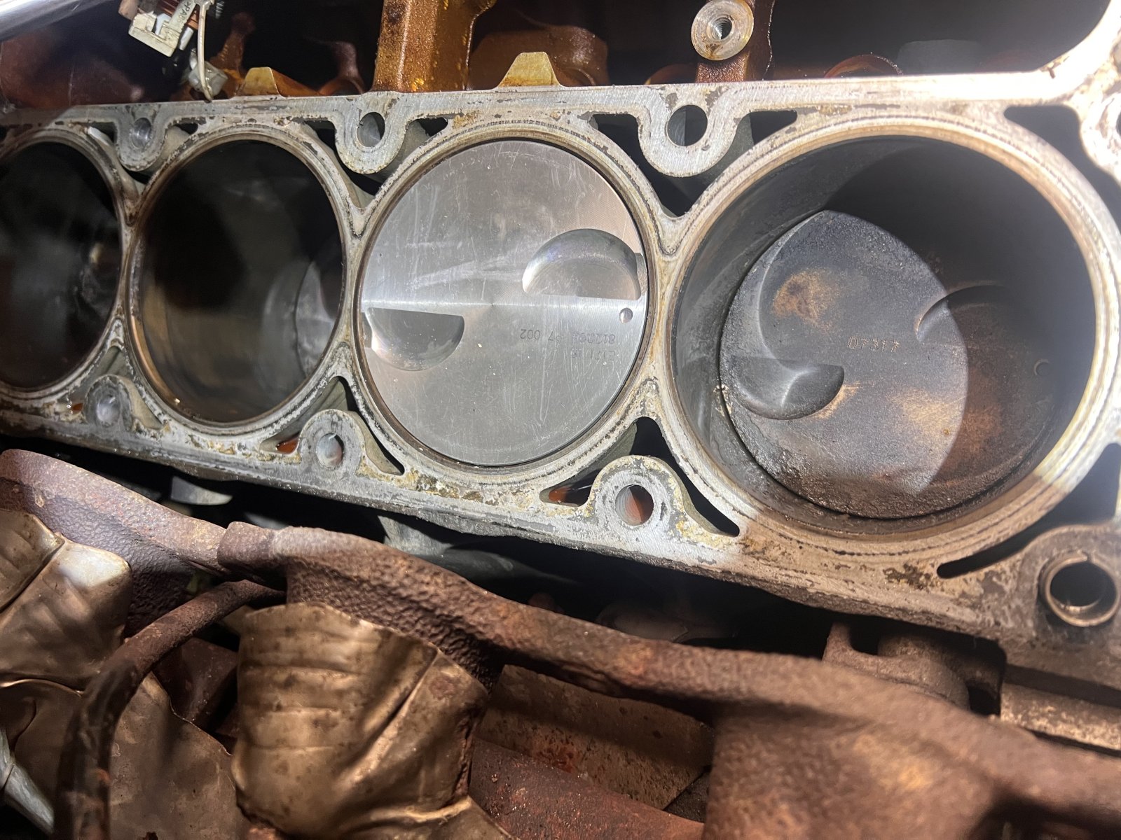

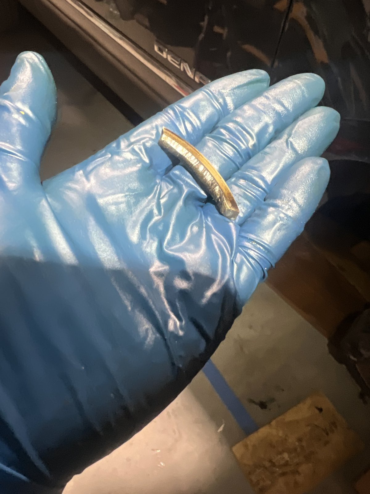

Found the piston like this. How it happened, I am not sure. There are a couple of theories. It may have been the source of a ticking that I have been chasing for a long time, though. Sounded just like lifter tick. Or, I did have lifter tick and the piston was just a cherry on top.
I put a new one in and put it back together.
New Melling HV oil pump has my hot idle at about 22-25psi. Up from probably 12-17psi. I consistently gained at least 10psi everywhere while warm. My cold start went from 45 to 70+ so for an older engine I will take it. I did plug the relief in the oil pan.

Wow, I fixed an Escalade that had dropped a valve seat hanging the valve open and the valve head hit the piston and cracked it. Cylinder was fine. New piston and rings plus valve job had it running like new.
Your damage looks to me like detonation damage. If something was dropped into that cylinder that broke the piston you will have contact damage in the cylinder head at the exact spot where the piston damage is.
Detonation is early combusiton, the fuel charge lights off before the spark plug ignites. In detonation the fuel explodes as the piston is still going up with 7 other pistons driving it. That creates huge cylinder pressure which can fracture a piston, break rings and do connecting rod bearing damage.
Normal cylinder pressure at wide open throttle might reach 600 PSI. Detonation has been measured at well over 3600 PSI.
Causes of detonation are:
Lean Burn, not enough fuel in that cylinder
Advanced timing, we don’t see that on these fuel injected vehicles
Cheap gas. Low octane fuel burns erratically and leaves hot spots in the head chamber, the hot spots glow red and act like a spark plug igniting your fuel early
A partially plugged injector can feed fuel but not enough giving you lean burn.
A vacuum leak can lean out a cylinder.
When you find damage like yours always look for the cause or the new piston may have the same problem after install.
You had the heads off so all your intake gaskets are new and all your vacuum hoses were removed so you were able to see any issues.
Glad it is running perfectly for you now.
View attachment 475825View attachment 475826View attachment 475827View attachment 475828

I really didn't see anything concerning as far as intake or vacuum hoses. Maybe coincidence, but when I did have a lifter collapse, it was on the same cylinder. Something that does concern me is the exhaust valve color on that cylinder. Not quite sure what the issue is, if there is one. I am thinking it might be a fuel injector issue? I checked the valve and valve seat while it was off and there was no issues. Only thing making me scratch my head is the exhaust valve color.
I don't know if it's normal or what. Or if the piston being cracked somehow caused the valve color to be different... I really didn't see any change in color on the spark plugs.
I would say that it is something fuel related, though. Seemed like the piston had a little bit of melted metal near the crack.

If you blow up the view of your chamber in the head where the exhaust valve is grey you see carbon deposits building up in that cylinder. That would be extra oil in the burn due to the damaged rings. I think it is odd that your exhaust valves are Orange like they are seeing water or coolant in the chamber. Did the engine use coolant before it broke?
The engine used no coolant, and no oil (or large amounts) as far as I am aware. It was an AFM cylinder, though. What is a more normal exhaust valve color?
I was running e85 for about 1500 miles before I tore the heads off. Maybe that has something to do with it?

The exhaust valves may look that way after running E85, I don't have any experience with E85 engines. My son runs it in his Twin Turbo Corvette for the octane it offers but I have not seen an E85 engine torn down yet. The one cylinder was not running the same for sure and it had the broken / damaged piston so something is off there.
