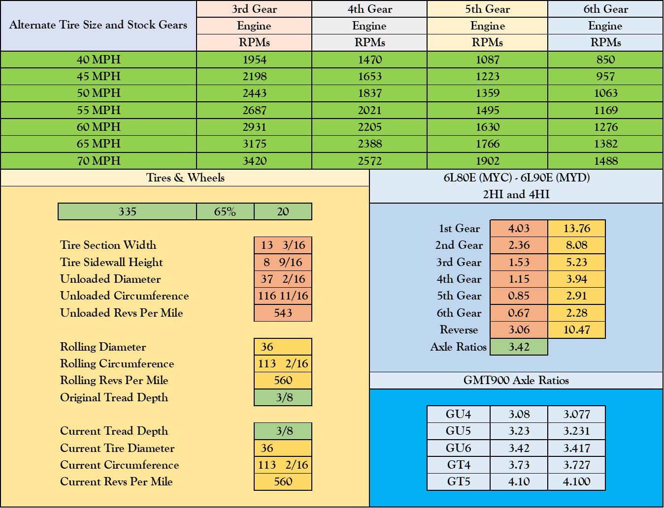

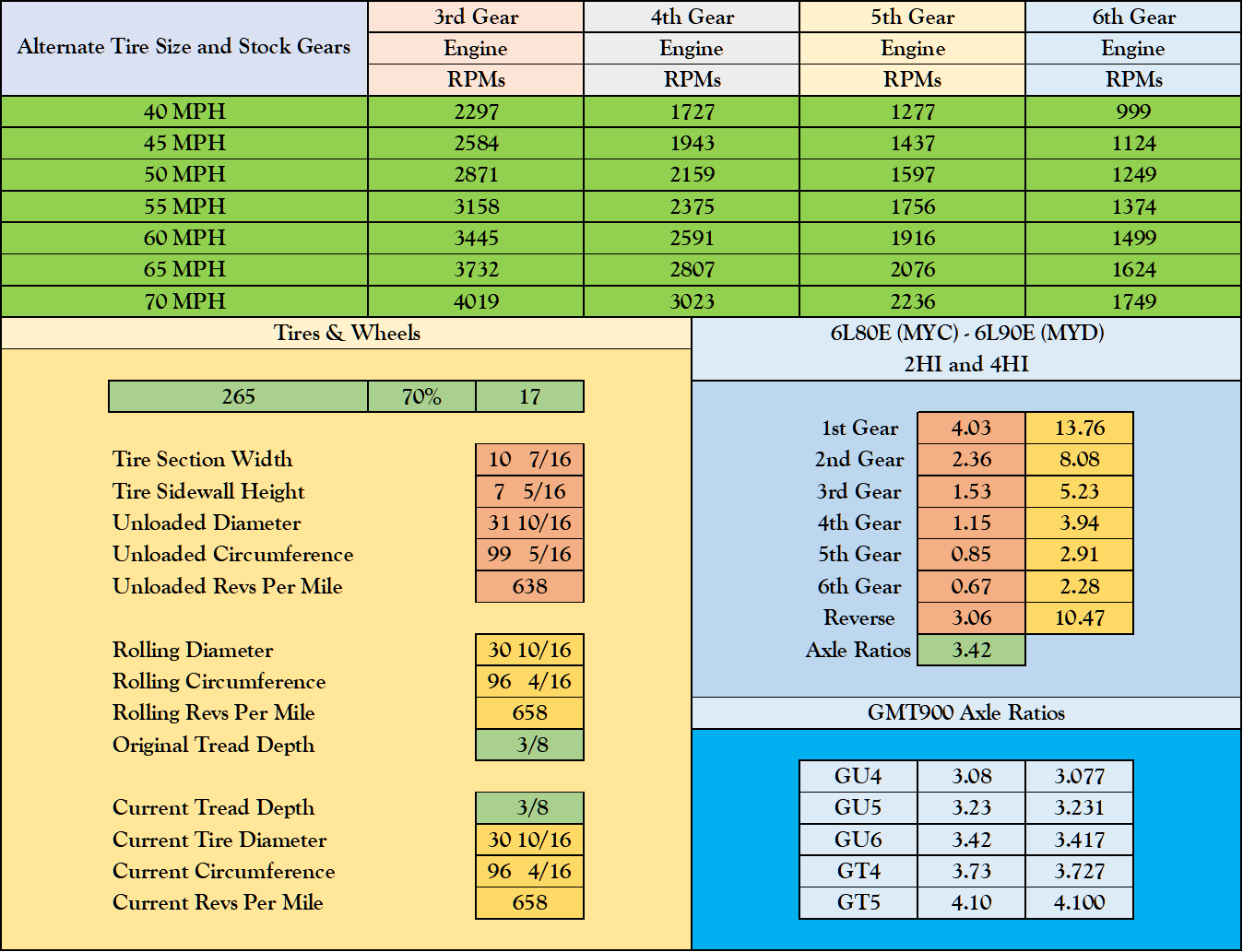

I made a calculator with excel that's very precise and even accounts for tread depth. Here's an example of my compact one:
This is about what the OP is experiencing now:
And this is how his truck would perform with 4.10 gears:
So if you compare the before and after, you guys were correct and I was wrong about the 4.56s being more equal, the 4.10s would be more equivalent while running 37s!
That's why I made this! LOL
Does that also include having the 22x14 wheels as well ?
