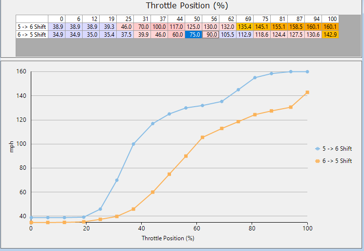

Was the 4.10 to 3.42 swap tuned? It sounds like that swap was a 4l60 with the taller 1st gear?
Without a tune it would be shifting at the same speed as before, but at lower RPM's..
NOT saying you wouldn't prefer the 3.73 all around anyway!
Just pointing out those variables that may make the taller gear seem worse than it is..
It sounds like the majority of issues people have with taller gears is freeway speeds..
(The only time *I* notice the shorter gear improvement with my 5.3, 6L80)
But in your case @West 1, regarding your '08, it sounds like a minor tweak would fix alot...

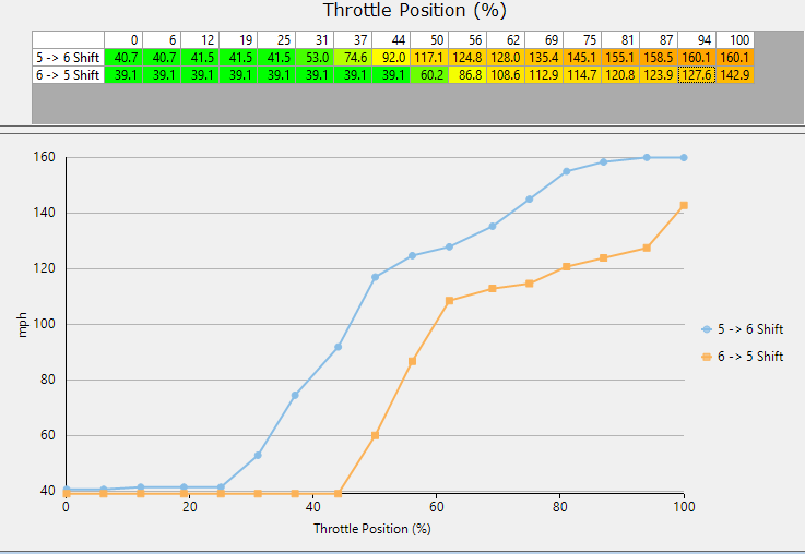

In fact, the '09 escalade seems to improve right there..
Downshift speed is up 15mph at 50% throttle (where yours is 60mph, '09 is 75mph) but only up 3mph at 56% (87-90mph)..
The '09 upshift is also raised @31-37% tps, so when it does downshift, it will not be so eager to upshift.
I imagine a Black Bear tune could dial it in to your needs even more..
Without OTHER nagging issues, it maybe overkill to swap gears in your '08 6l80?
'08 escalade below, assuming it's same as yukon denali..
'09 escalade
