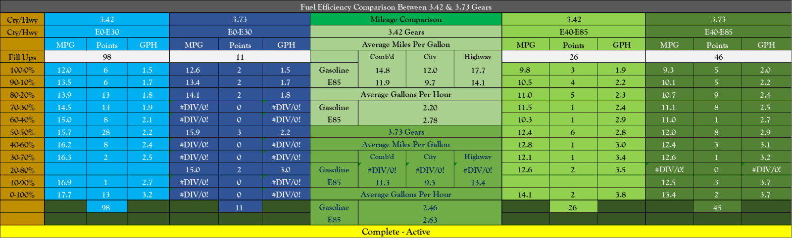

We did the swap to 3.73s and the 14-bolt Saginaw differential from 3.42s in the Yukon XL. She has a 5.3 motor and doesn't downshift anymore while crossing the steepest bridge in the county like she used to. Towing and getting off the line are easier and she's faster too. The gears allowed the motor to put down an additional 10 horsepower through the traps in the quarter mile at the drag strip. We've towed several times since the gear swap, over 7,000 pounds but it was all in town. It was effortless towing even still.
Is it worth it moneywise? That's a question every man has to decide for himself. It was an incremental difference over 3.42s but still a noticeable one nonetheless.
The truck has been on E85 almost exclusively since then and the difference in economy is small but still there. When you look at the chart realize that this truck now has 220K miles on it, save for the zero timed rear differential and the used front differential out of a 2008 Suburban with less than 150K on it.
After our next run to the drag strip, I'll put the truck back on gasoline for a bit to collect some more data.
At first glance, it looks like she's doing pretty good on gasoline with the 3.73s compared with the old 3.42s and with more data points, the difference is the other way but only marginally worse, what, a quarter mile to the gallon? A tenth of a gallon per hour difference in fuel burn? If I was maniacle about gas mileage the 3.42s might be the better choice.
My stock 6.2 pickup averages about a mile per gallon better fuel efficiency compared to the 5.3 in the Yukon XL. The 6.2 can make up for gears with more horsepower compared to the 5.3. But, you've already done that.

At first glance, it looks like she's doing pretty good on gasoline with 3.73 compared with old 3.42 and with more data points,
If I was maniacal about gas mileage, 3.42 might be the better choice.
Carmakers are heavily incentivized by CAFE MpG test scores to think EXACTLY like this.
Every fraction of a mile per gallon matters to a carmaker, even though it's a very small price to pay for a transmission that will go longer between rebuilds.
