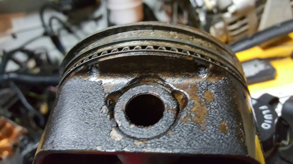

I think I found the problem... Aside from being grungy as hell, the rings on #6 are stuck hard... Pulling them all tonight and debating on ordering a set of flat tops

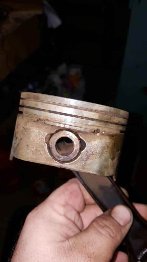

scrubbed and scrubbed some more pistons are about halfway clean, still need an afternoon soaking before im ready to put te rings in. But for comparison heres #6 the problem piston before

are you sure it is safe to continue? i dread to think how dirty the bearings, lifters and oil passages are. also your oil cooler is functional as well correct?
chaingun427
OBS Mad Scientist
Feb 1, 2014
435
38
Mooreland, OK
Mains are mint, rods are being replaced just because it's open, driver side lifters don't look too bad, but they're going to get changed out before it goes back together. I don't notice any build up on the oil passages in the crank and pressure was at 40lbs warm. I ran some marvel in the crank case and it looks a thousand times better than it did before.
I don't have the oil cooler hooked up at the moment, but the rad it's brand new so after a few more oil changes I'll be getting it connected

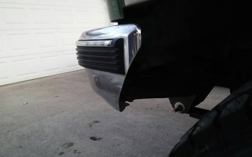

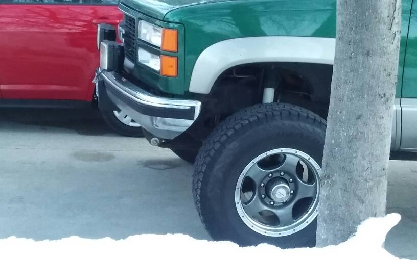

Cut the front bumper.
Since I removed a leaf from the front suspension the front end dropped about an inch, resulting in the wheels contacting the bumper while turning. 20 minutes of cutting and grinding and this is the result.

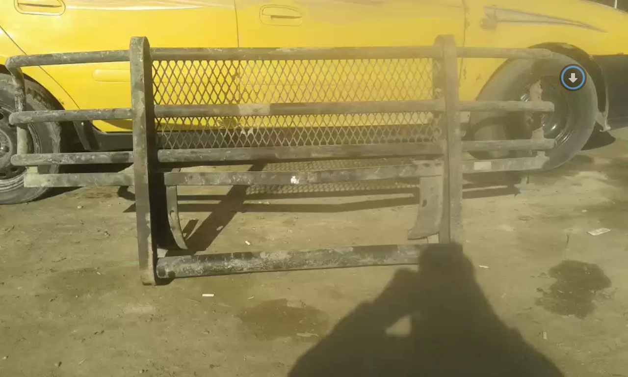

Thinking of buying this bad boy
But not sure yet
Depends on the look you're going for imo, looks like it's in great shape though
