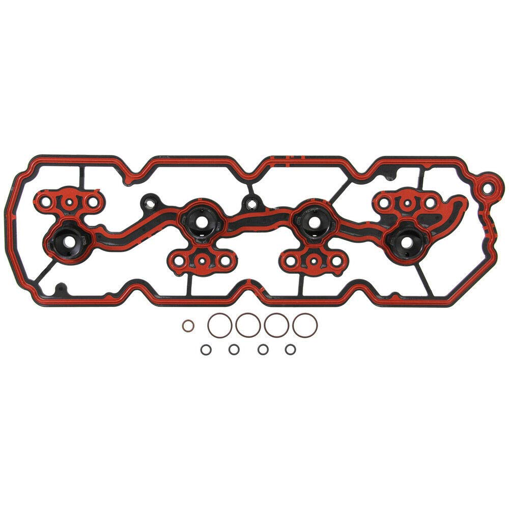

That’s the difference I believe. Your valley cover will look different. It will have a series of ridges for oil paths. The non-AFM covers are flat like the one in the video.

O-rings under the valley cover? Yes. There's the main gasket and two different sizes of O-rings for the towers and solenoids. BTW, it's technically known as a "VLOM" (Valve Lifter Oil Manifold). I should mention that there's an updated VLOM. But, if you're not gonna use AFM, I'd guess your old one is fine since the solenoids aren't being cycled.

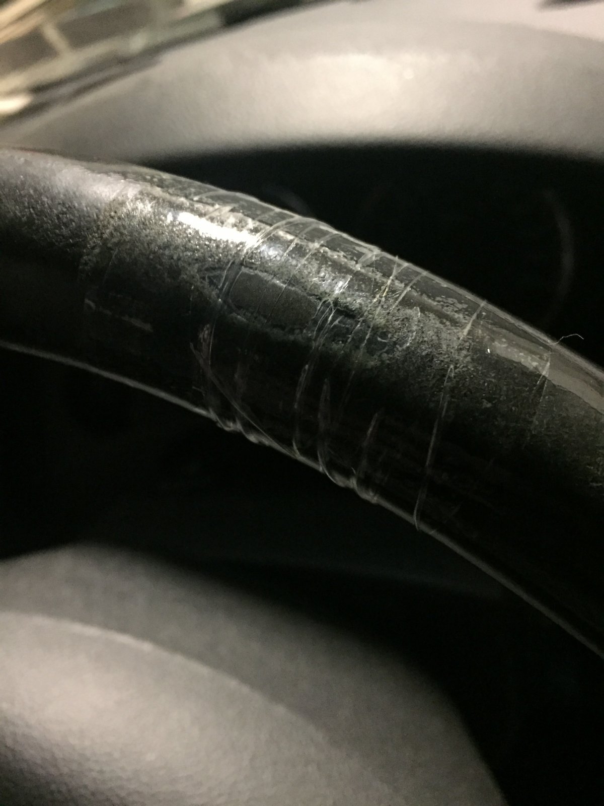

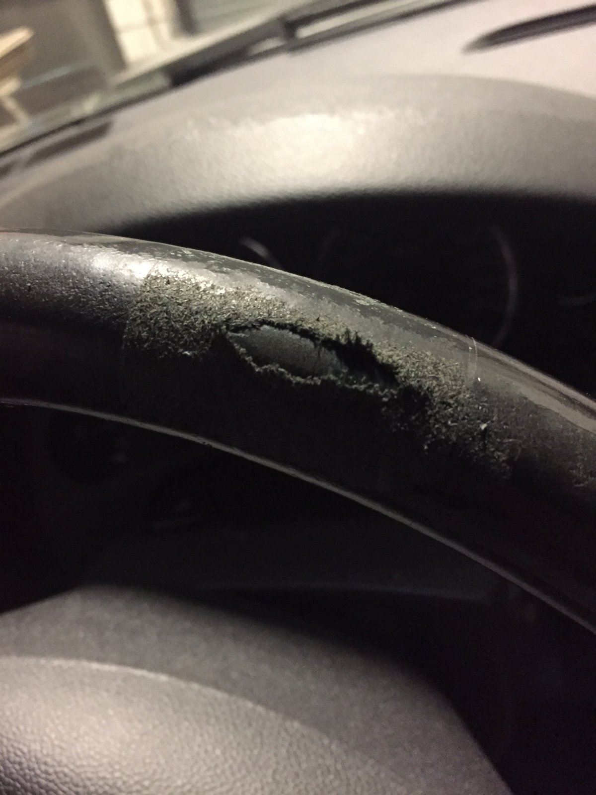

Any quick and easy fixes for this besides replacing the whole thing or using scotch tape? Any secret squirrel internet fixes?
