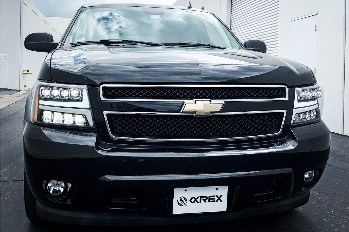

these headlight? YES or no? :jawdrop: it's almost $1,000

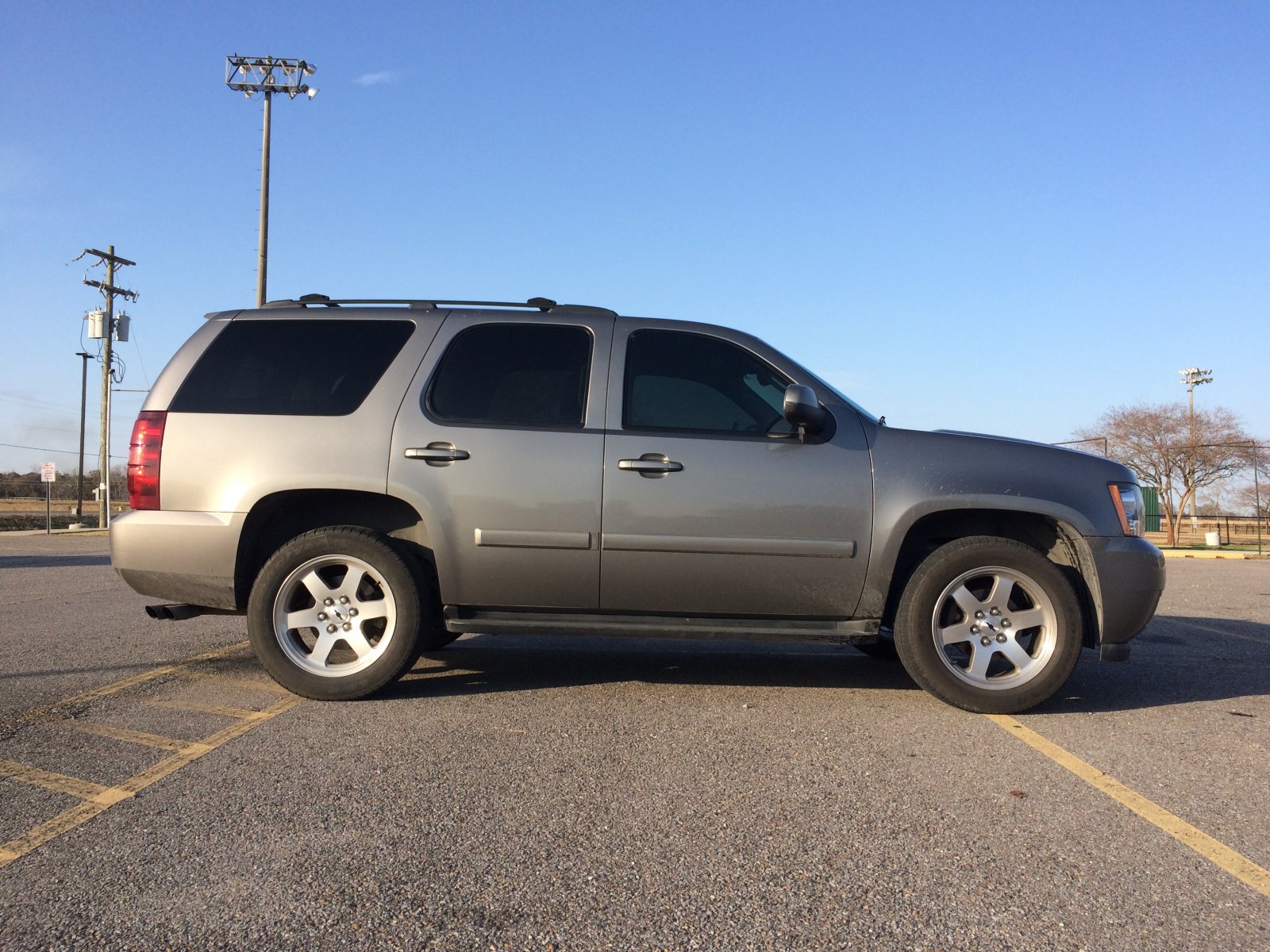

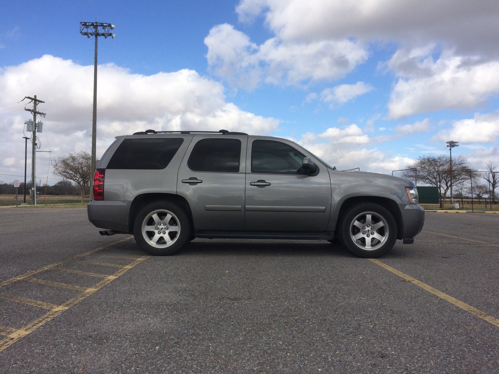

Comparison pics for "Phase 1" drop:
Before-
After-

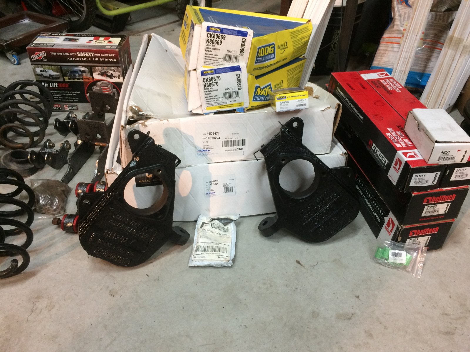

This is a "2/3" with spindles and coils. Actual net drop is 1.5/2.375. Also have shock extenders, new upper and lower control arms with new bushings and ball joints, new shorter front sway bar links and Belltech alignment cams. I'm still trying to sort out why I only got 1.5" out of the spindles, but I'm not gonna invest much time or effort into it since it'll soon be going lower.
Pile of parts:
The rear rides much firmer than with the stock coils. I can't say for sure if it's the 3" McG coils or the suspension computer firming up the shocks because it sees the rear sagging. "Phase 2" drop will include drop struts and shocks, DJM rear sway bar links, DJM rear control arm relocators and some "mystery" coils that I'm guessing would bring another 1.5-2" of drop and SHOULD be a softer ride. I have AirLift bags to adjust the firmness if they're too soft. The struts will be set for an additional 2" of drop on the passenger side, 1.5" drop on the driver side to level out the Chevy Lean. I have resistors for when I replace the struts and shocks to delete the Autoride. I'll swap the shocks when I do the struts but try them with the McG coils so I'll know what was causing the firm rear ride.
