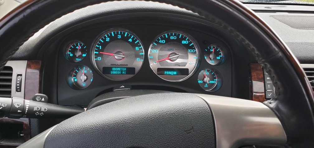

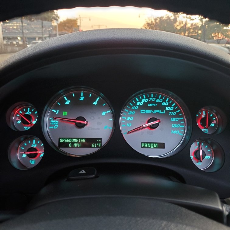

Guys which do you prefer. I can't decide.
Sent from my SM-G973U1 using Tapatalk
I'm feeling the silver needles but I like the factory Denali gauges better... imho...

I like the 2nd choice. Not a big fan of DENALI printed on the speedometer, but the rest looks better IMO.
I actually like the top one better. Looks more factory. Though I do like the 140 mph speedo..

Second one. But, for the love of humanity, get some blue tint on those screens!
You guys are the pro's. Tell me is there anything i can do to even out the light distribution on the denali one? The backlighting to the numbers has like hot spots.
Thanks
45,012
Thanks
Depends on what's causing them. LEDs or stock bulbs? If stock bulbs and the hot spots are only with the Denali one, then the problem is the tinted film being too thin and/or smooth (not textured enough to diffuse the light sufficiently). You can try Scotch tape (frosted, not clear) or layer the entire back of it with frosted window film.
