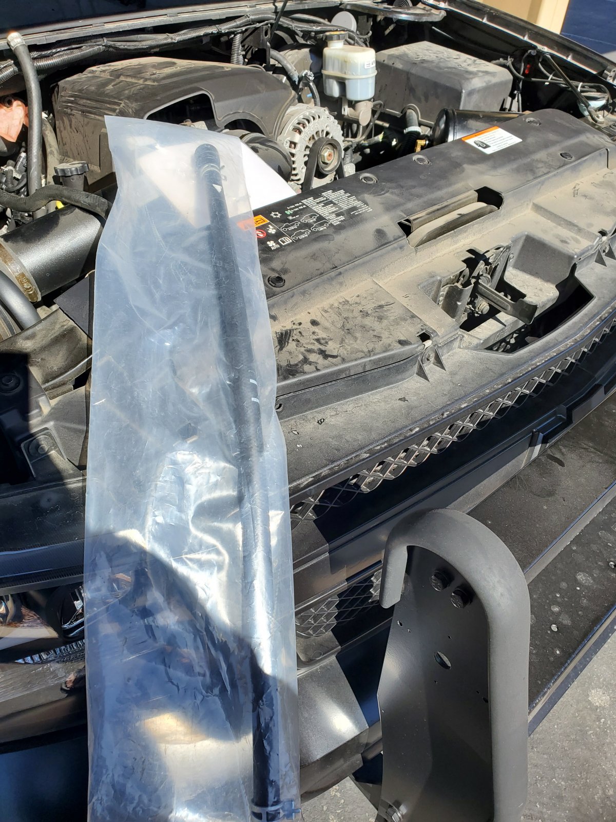

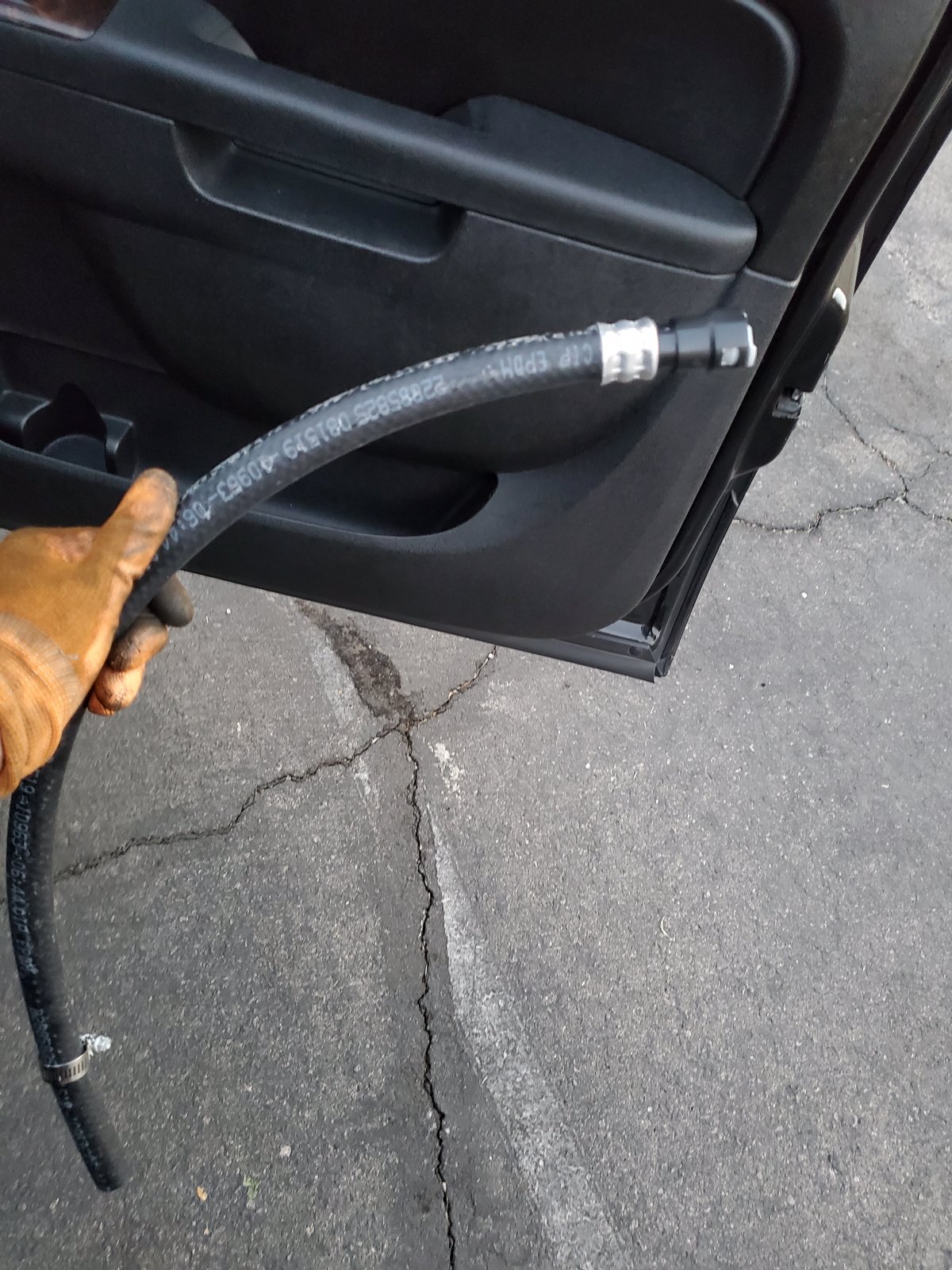

Bad news, cant wait for the oem part to come in. So i went across the street to the oriley and got the dorman version.
Just make sure to order the OEM T’s and replace those POS Dorman ones or you’ll be broke down on the side of the road in no time. That way you’ll be good for another 150k. There’s tons of guys who put Dorman T’s on just to have them break in months. OEM are generally good for 10 years. The hose itself with it’s quick connect will probably be OK, I’ve never heard of them breaking.

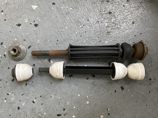

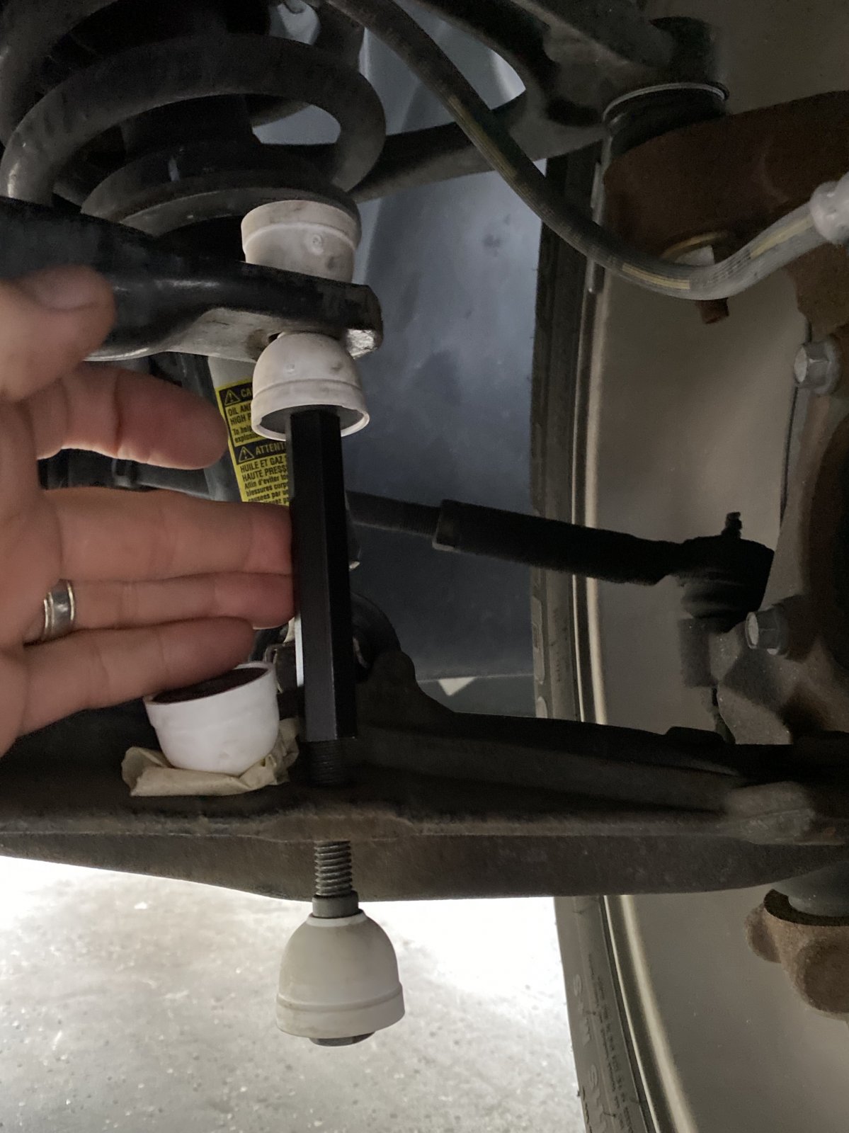

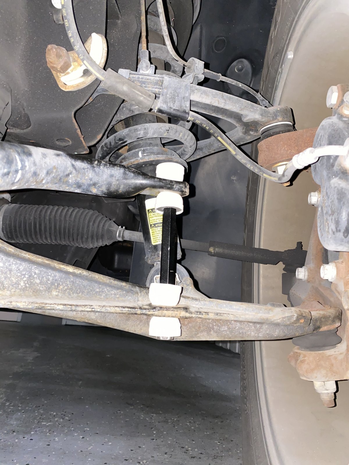

Installing new Moog endlinks K700538.
Going to check and make sure the correct part number but that other bushing has zero space to slide in the spacer before passing through the control arm.
Truck is jacked up with both front wheels off the the ground. Hmmm...??
Exact same set up on my Tahoe. What am I missing here?
Edit: checked part number and application for 2007-2014. Sleeve length shows 3.4 inches.
Have to do both sides at once so the sway bar can move freely.

After a trip to the dealership. I got the right part. The part and 2 gallons of coolant later(cause it was everywhere), im done

Sounds like need to add an OEM tee to my RockAuto wish list. Who makes the metal one?

I did mine with the front wheels on ramps. I removed both sides which allowed the sway bar end to rotate up/down. I installed the new endlinks up from the bottom and used the barrel nut end on the top.
2001 Yukon SLT
2012 Yukon Denali XL
2011 Yukon Denali RIP 5/20/18
I copied this method, and worked a treat..
