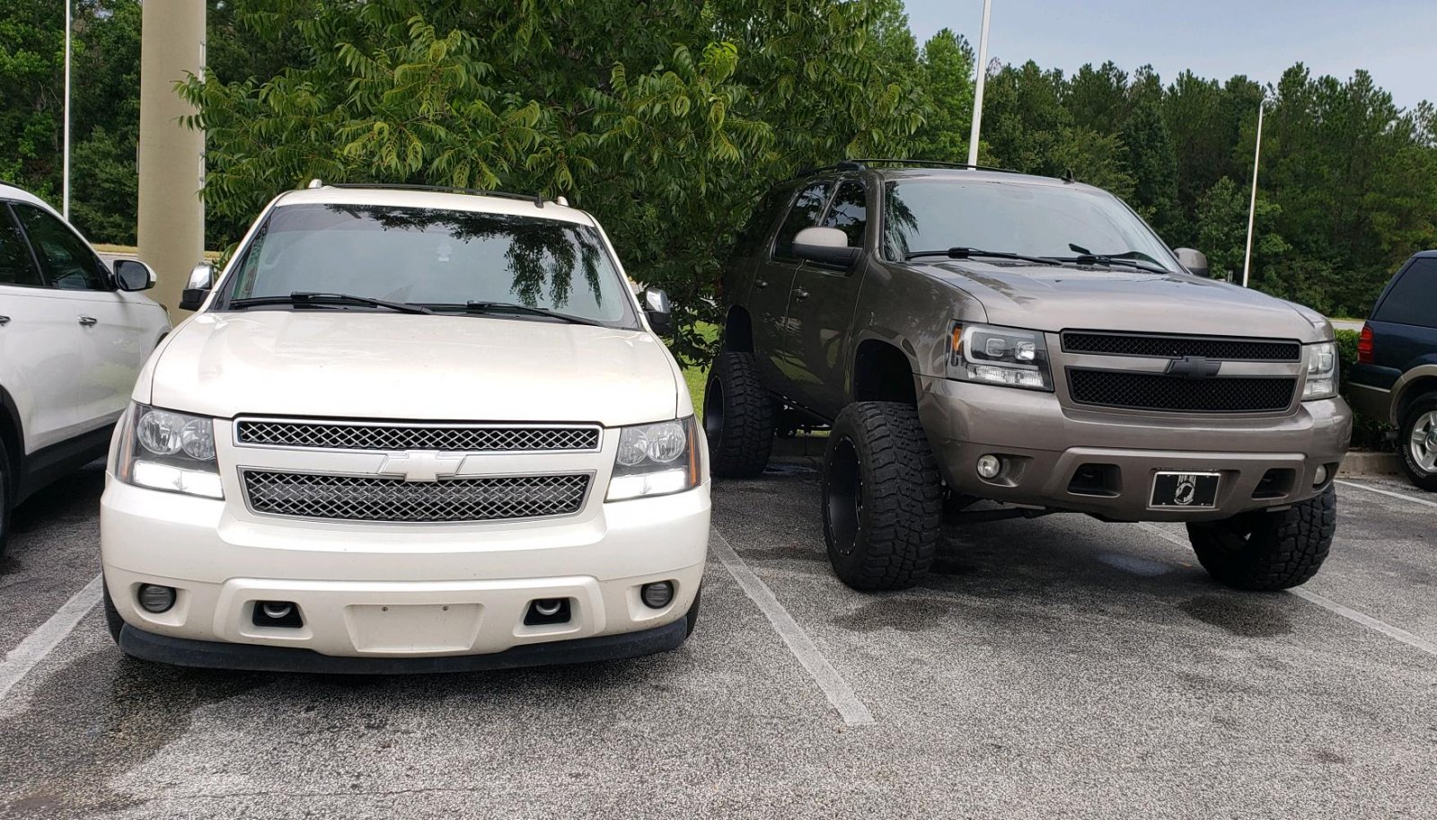

Snapped this pic the other day... forgot to post it until today...
The dropped Burb sitting next to a lifted Tahoe.
Your front lighting set up looks sooooooooooooooo gooooooooooooooood.
Who's lifted burb?

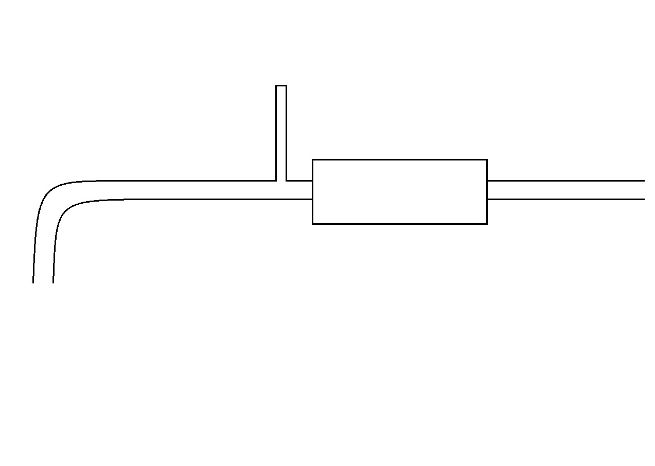

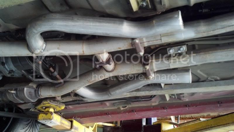

Nah. I've been wanting someone with a droning issue to try fixing it with tuned resonator(s). Basically, you calculate a formula to determine the length of tube(s) needed then weld it/them to your exhaust. You keep your muffler, it's volume, etc. but single out and attack the offending tones. I recently put a 14" muffler on my brother's truck and was actually hoping for drone. So far, he says there is none.
*EDIT*
It's called a Helmholtz chamber and it'd be something like this (internet pics):
It doesn't have to be straight the whole way, just 90° where it meets the main pipe.
Dual chambers (because dual exhaust on Mustang) :
*EDIT*
Think of the stock intake tube. Same thing.
*EDIT*
That's really ****** neat. I will look into this. I'm gonna take a welding course next term, and will look into doing that with the titanium exhaust.
That's a great point. I was looking at my stock intake tube. Gonna cut that one off and JBweld the hole shut. I loooooove intake noise. With the cam, at higher RPM when the exhaust noise falls away the intake noise sounds like a space ship and I want more.

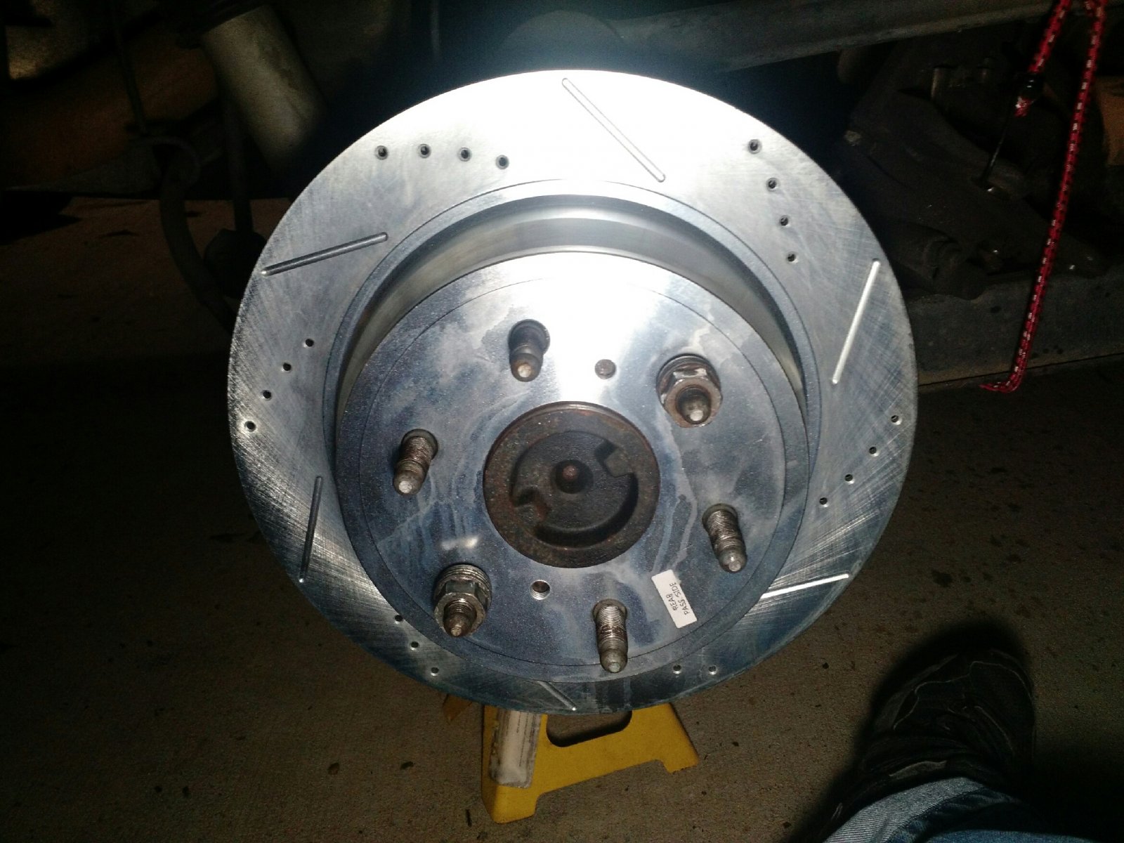

Oooh Rear brakes(powerstop), since stopping on the backing plates isn't the best idea.
Also adjusted parking brake while i was in there, yay I can park finally ;)

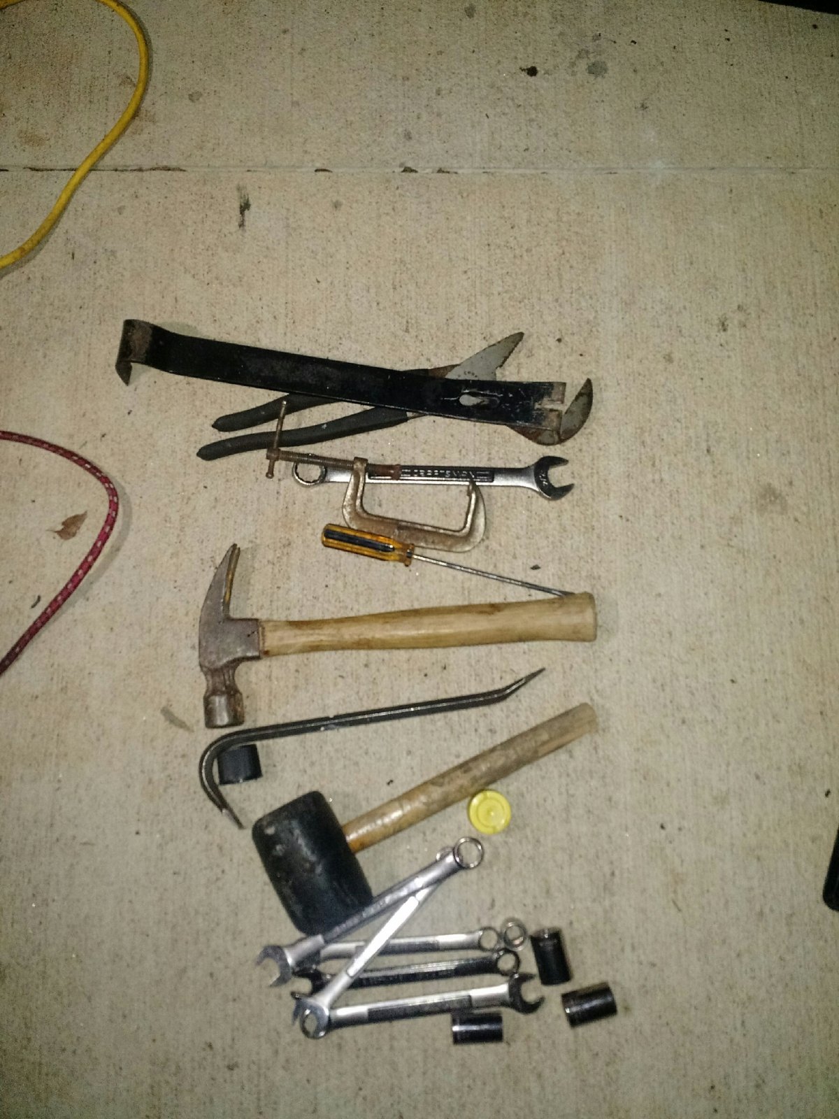

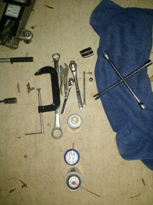

The Tools I used....
BTW key tools
13mm socket,
20mm open end or vicegrips if you are like me and can't find your 20(if you own one)
18mm socket
Also that 10x1.50? pitch threaded rod again to pull rotor
The tools I thought I'd use...
