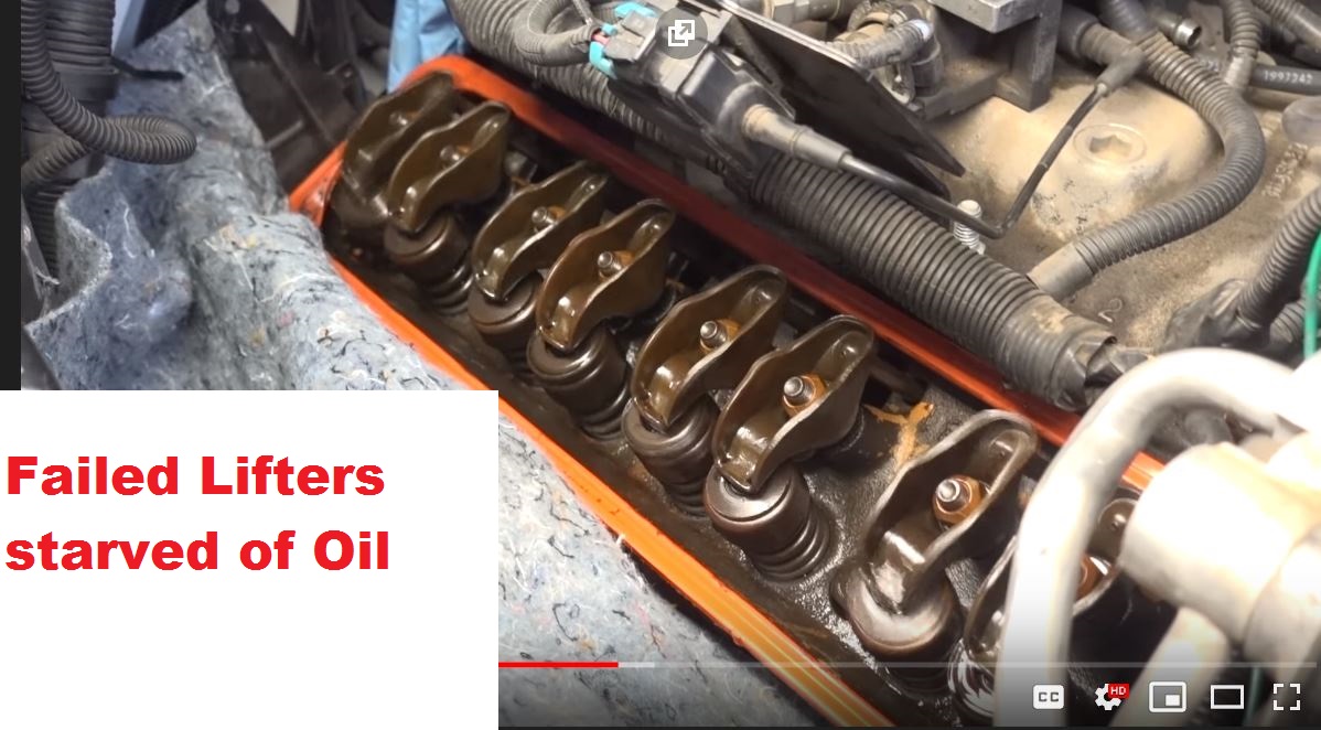

This photo shows a engine with 1995 suburban with 70k miles
the lifters are all ready failed the oil tubes are clogged with dirty oil according to the video it took 45 seconds to get very low flow from the rod tubes... so it's running "dry"
the idiot was revving the engine too and also said keep some water handy if it catches fire... LOL I called him out of that to do a follow up video still no response on that ( he did mention a fire extinguisher though) but WATER will cause a oil fire to flare up
apparently this guy is using magnets on his oil filters and has been collecting a lot of metal shavings
if you watch the video you can HEAR a metal to metal screeching( :head3:metal frottage) :hahano: :rotflmao: sound from those lifters hurts my ears

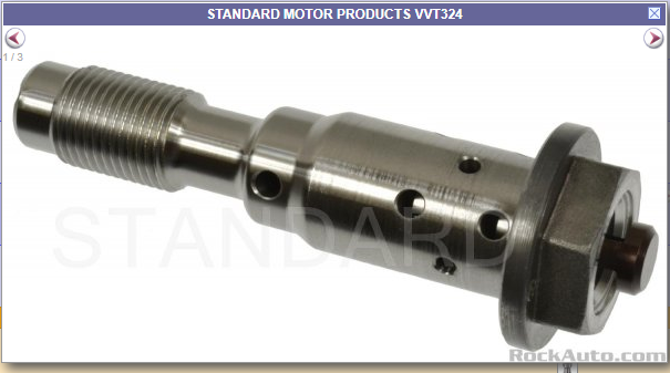

Man, you got me hanging on this one. I can't think of anything you have not covered. Only getting 8-10 mpg is very odd. Even in the winters here when we leave our vehicle run/warm-up, we average 13-14 mpg.
I only mentioned the VVT as I was getting ready to replace the solenoid and the valve on my 2007 because I was getting poor mileage and that was in the same boat as you. I actually purchased the solenoid and the valve, but ended up trading the vehicle in before I got to it.
If you do decide to go that route, now is the time to do it since your radiator is pulled and your coolant is drained.

It does not have anything to do with cylinder deactivation. What I am referring to is the VVT solenoid and the valve for advancing/retarding your cam. I am assuming you still have VVT active in your vehicle. The valve doubles as the bolt that attaches your VVT phaser sprocket to the cam. The solenoid is mounted on the timing chain cover behind the water-pump.
