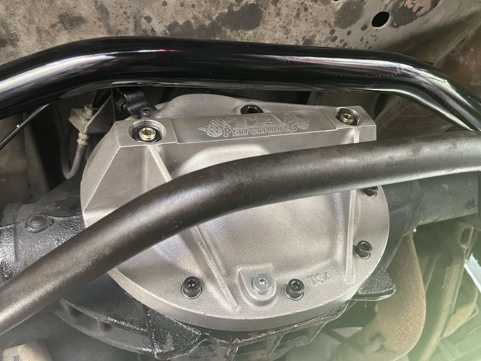

It’s been on jackstands for weeks while I’ve been dealing with Moser and waiting for the Dutchman axles instead. Moser doesn’t know how to ship axles correctly and sucks at customer service.
Received the Dutchman’s Thursday and installed them today. Felt great to drive it again and get it cleaned up.
The new Spohn bar fits great with the TA girdle (low profile version).

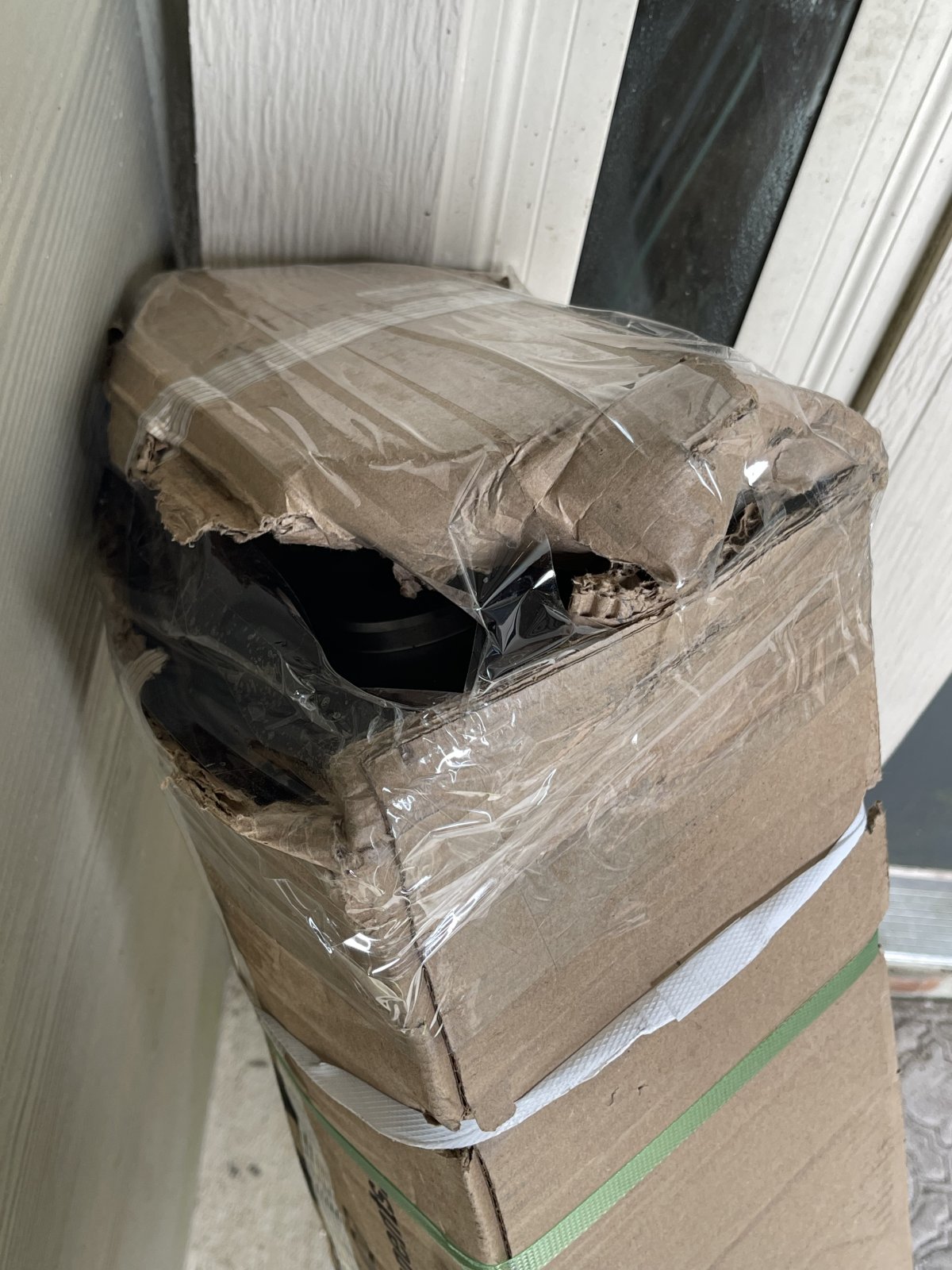

Yeah, I received 3 different sets from them. I called Moser first to confirm the right part number. The first box was really wrecked so I called Summit and they filed a shipping claim and sent out a new set. The second sets box was also really messed up (pictured) I didn’t want to wait any longer and decided the axles were good enough to use, so I fully installed them and realized they were a tiny bit too short when I put the rotors back on….. Moser then told me there were two different length options and there is no rhyme or reason to it?? Not sure I believe that. So I had to order a third set directly from Moser because Summit didn’t have it. I even called Moser after the second set to tell them they might want to ship these differently. The rep just said “ok” and couldn’t have cared less. They just ship them together with a thin piece of cardboard in between them so they’re just banging around the whole time. I have a video of FedEx dropping the third box on the concrete, and the axle was already hanging out of it with the end totally ripped off, so the axle was directly dropped on the concrete. There was no way I was going to run those. They might have been fine, but who knows what they went through up to that point, and I didn’t want to support them anymore. It should’ve been an obvious shipping claim, but Moser kept saying they had no reason to believe they weren’t usable. At first they tried to give me store credit. Then they said they’d refund me but wouldn’t cover return shipping (it was $75 to ship them back). Dude had an attitude the whole time and said “We are just not picking up the tab because you have chosen not to use the shafts.” So I’m out $75 and all that time. At first they only refunded me the axle cost themselves and not the shipping to me. I’m sure that was deliberate so I called and talked so someone else and they fixed that.
Dutchman was awesome and the axles were perfect. I’m using either them or Strange from now on.

Why did you get new axles? Custom differential?
lowh07
Dec 1, 2017
445
1,772
Future proofing. My axles probably would’ve been the first thing to go when the new engine is in. The 10 bolt is still probably too small if ever get drag radials but idk if I’m even doing that.

Ok, so you kept the 10-bolt and put in stronger axles, got it. If you have an aftermarket center section, like a Trutrac and are putting 6.2 like power through it, the time before it requires overhaul will be shorter than the bigger axle or smaller engine but should be fine with occasional use.
I put a 14-bolt in mine to match my pickups and zero timed it with new GM axles.
They came in a heavy crate like box with 2x4s inside and out to protect them. No issues with shipping from Rock Auto.

in the future probably better off just have a local shop build a axle for you. just ask the guys at the local track who they have build them, there's always a place or two.
There's atleast 2 places here to me locally and probably a crapton around nor-cal
yeah, just wanted to save a little money and get the experience. I might preemptively sell it before it breaks if I get radials. I had already put some good money in it and then my power goals changed, or I probably would've got a 14 bolt. I think it's pretty solid for a 10 bolt. Truetrac, Motive performance 4.10s, ARP studs, girdle, and now axles.
