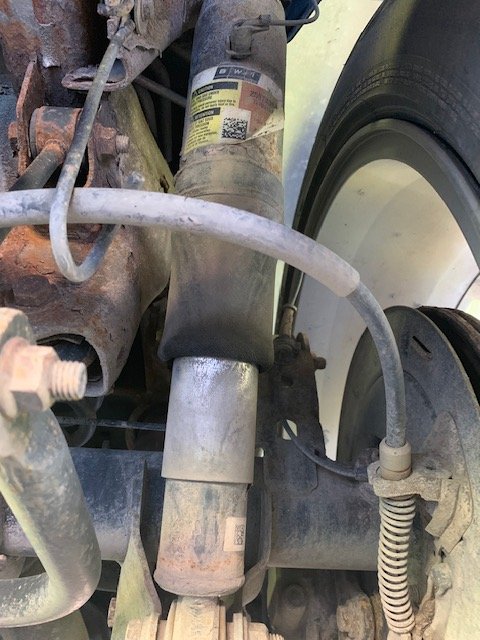

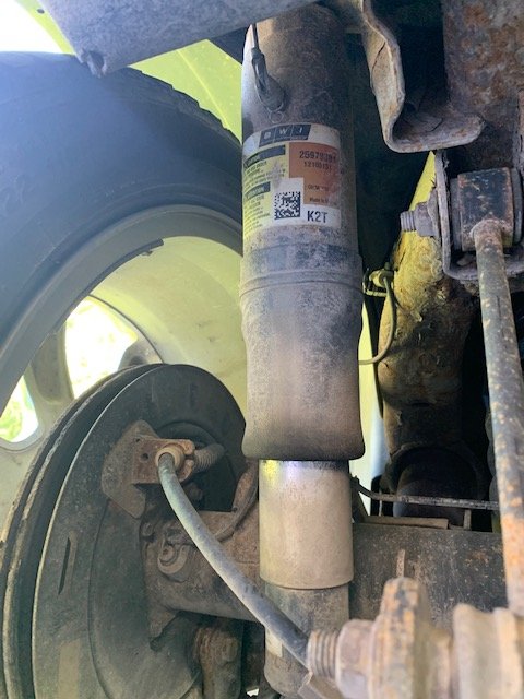

Good news, crawled under the Denali and the rear air shocks look good. Felt all around them and no rips or tears in boots. Have pics.
The bad news- the heat shield for the spare is broken at the upper frame mount- prbably ratttling.
The bad news- the heat shield for the spare is broken at the upper frame mount- prbably ratttling.View attachment 228041 View attachment 228042
you might want to verify no leaks by spraying those down with a mixture of soap and water and watch for bubbles
