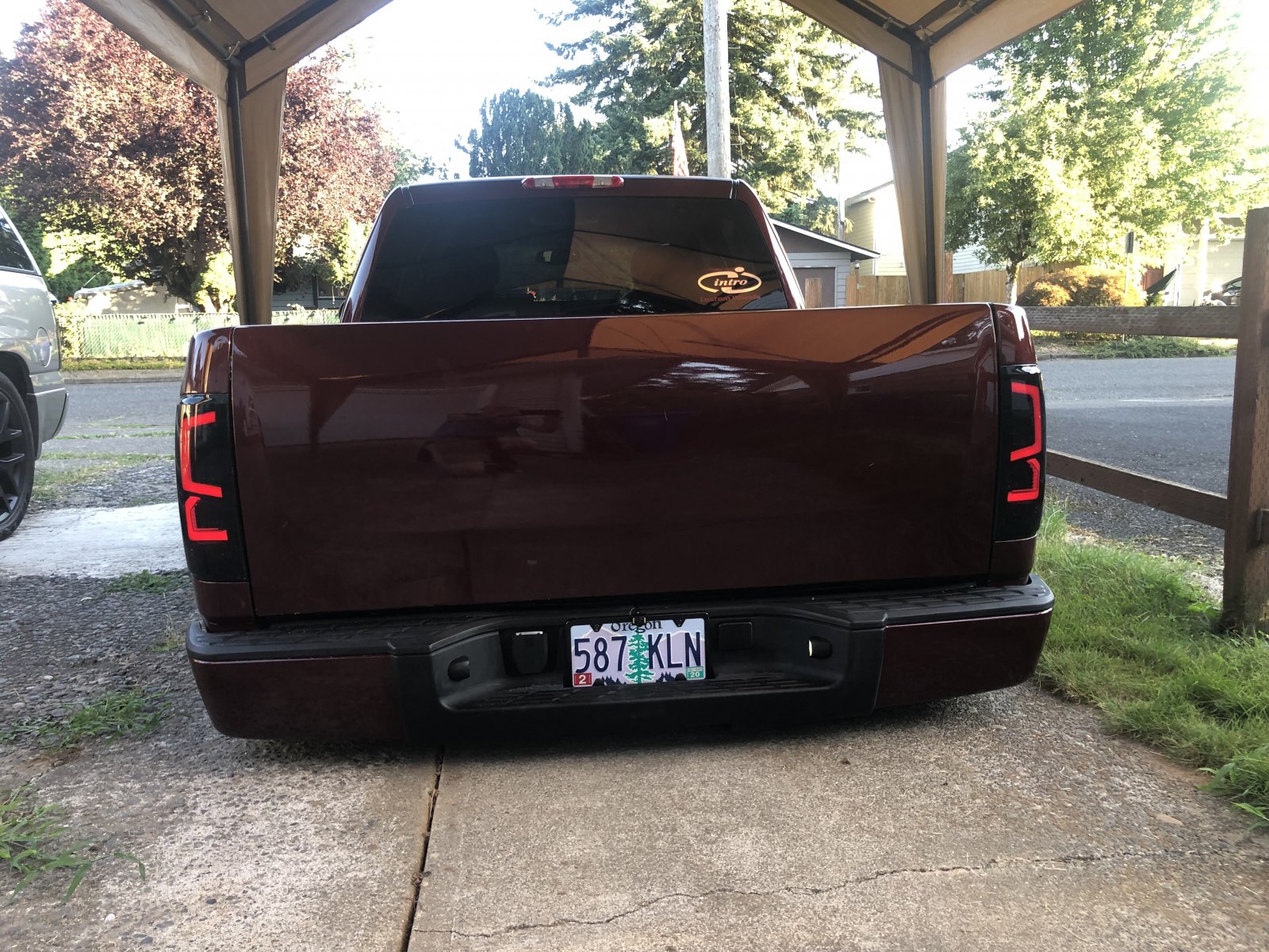

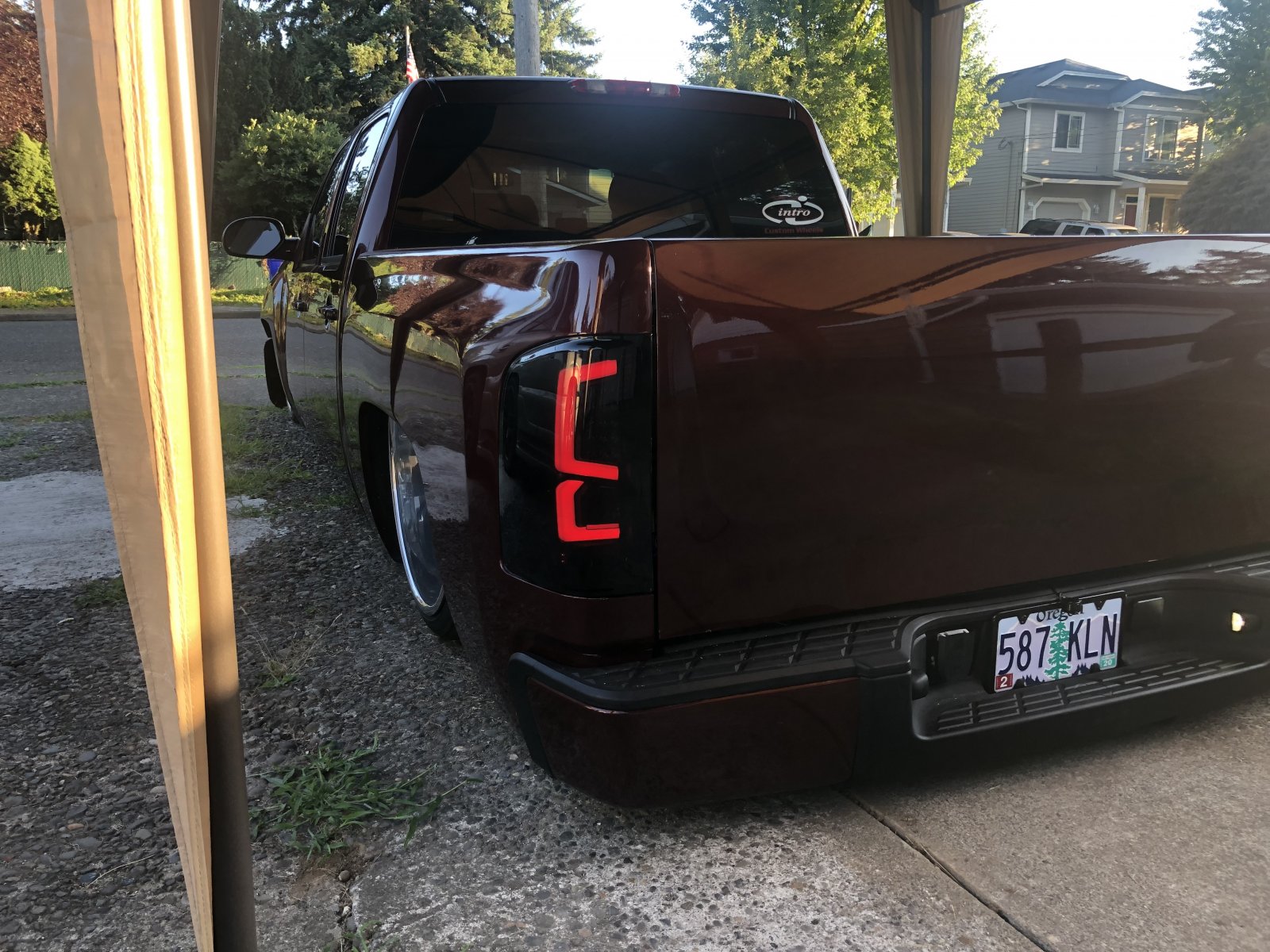

Got my new tails installed in The Machine.

Someone said yesterday that you’d need resistors for the hybrid tails to avoid hyperflash- no you won’t because only the brake lights are LED. The turn signals are still incadesent.
Thanks for clarifying. I didn't know one way or the other. I was just speculating that it might be a risk.
