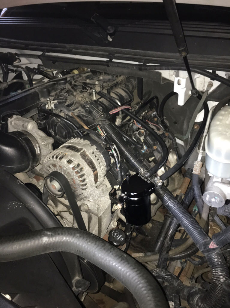

Crap pic but Amazon el cheapo and $5 of hose from Napa. I made a bracket to bolt it to the alternator bracket.
My 6.0 had 220k of blowby buildup in the intake and had a constant rough idle. Cleaning the upper intake and adding a catch can cleared it up 100%. They work and don’t have to be expensive.
