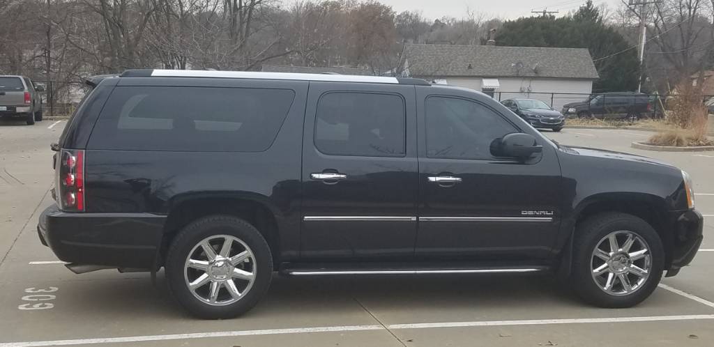

Mine's not lowered and I don't notice the resonator unless I'm laying looking under the vehicle [emoji848]
2001 Yukon SLT
2012 Yukon Denali XL
2011 Yukon Denali RIP 5/20/18
I take that back, you can see part of the bottom of it behind the rear tire if you know what to look for, but not enough for me to spend any time worrying about it... Lol
2001 Yukon SLT
50,943
19,372
2001 Yukon SLT
I guess that depends on the person looking at it. When that dingleberry was hanging there on mine it bugged the crap out of me and had to go fairly quickly. t just looks horrible IMO Then again, maybe I'm psychotic LOL

That's not very obtrusive at all. For us with the 5.3, the exhaust exits out the side, making the side of that giant can really visible from the back.
