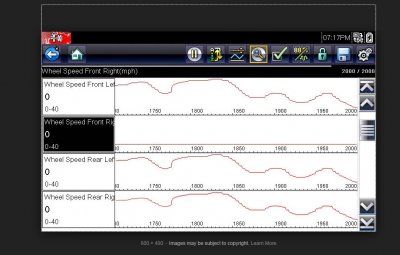

Poked around in my scan tool earlier today and it does have the ability to display all for wheel speed sensors.
Unfortunately, that didn't provide much insight. Found a wide open parking lot where I could safely just drive around in a circle at about 10mph while looking at the scan tool. The whole time the traction control light would flash, but the wheel speed sensors were consistently reading and reading as expected. The inside wheels would read just a bit slower than the outside (as expected) and the rear just a bit slower than the fronts. Similar readings regardless of whether I was making clockwise or counter-clockwise circles. Inside slower than outside by a small amount, rear slower by just a small amount than same side front.
