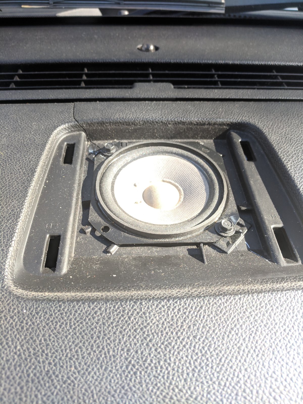

So the one crack in my dash is right at the center speaker mount, I noticed that it shakes a lot on bumpy roads so I figured maybe there was no support under it, sure enough just a big space underneath so I put some foam pad under it hopefully that will stop the shakes and keep it from breaking anymore.
30,500
47,887
That helped a lot, doesn't shake anymore, probably what made it crack to begin with.
