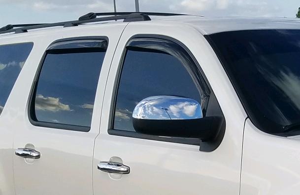

Weathertech in-channel FTW. To me they look much cleaner. No clearance issues. I'm not sure what would not let you stick your hand out. Plus you can easily remove them in the summer when they're not needed and reinstall them in the fall. And no sticky tape on your paint.

I went with Wade brand in channel visors... I like them because they are a little wider then some and they are made in the USA which is still important to some of us.
I guess you northern boys have vent visors for different reasons than we do down south.
I keep mine on year round and use them primarily for parking in the summer time to allow the heat to escape. You can leave the windows cracked and not worry when it rains, EVERY afternoon... lol

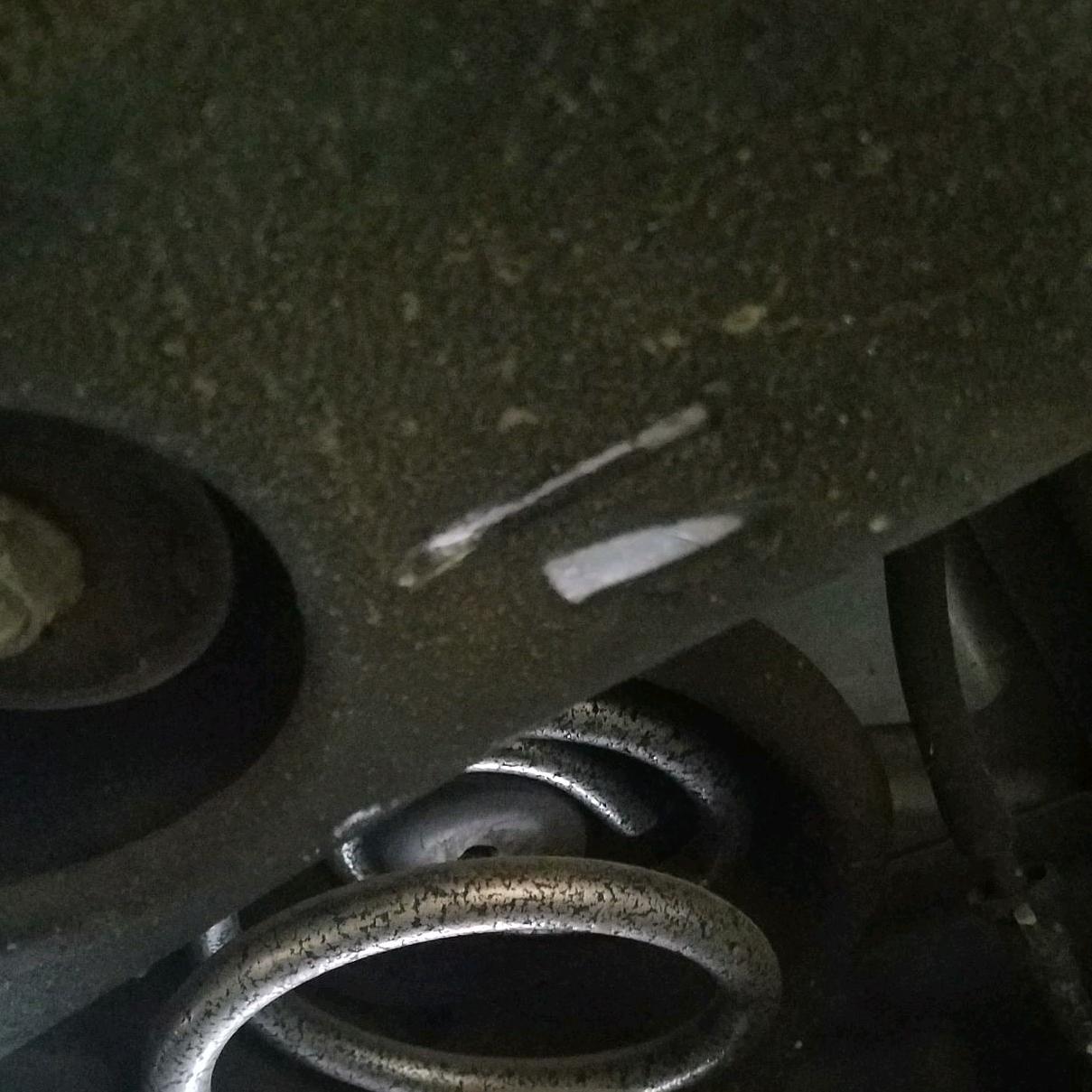

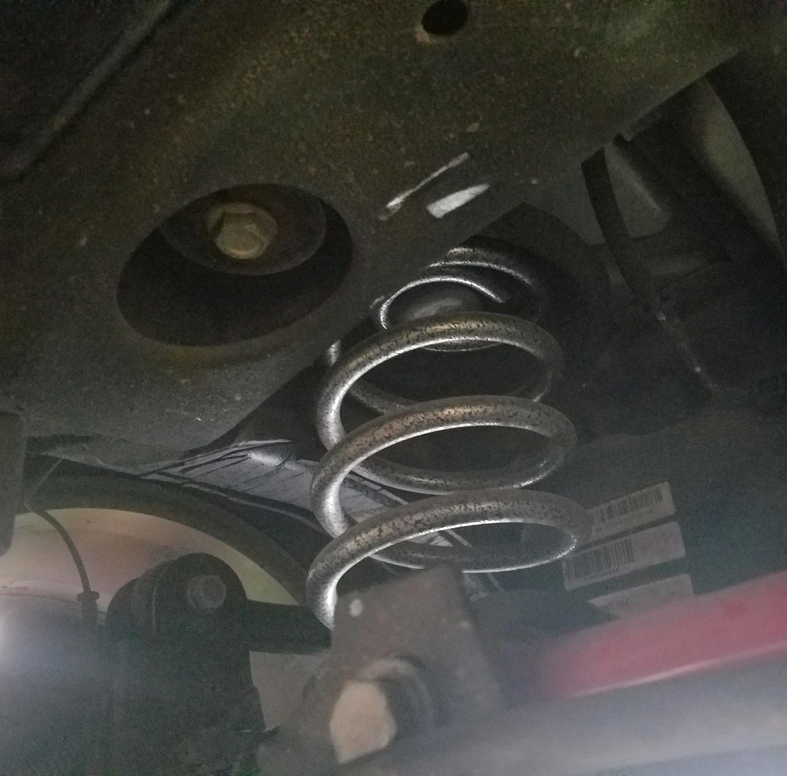

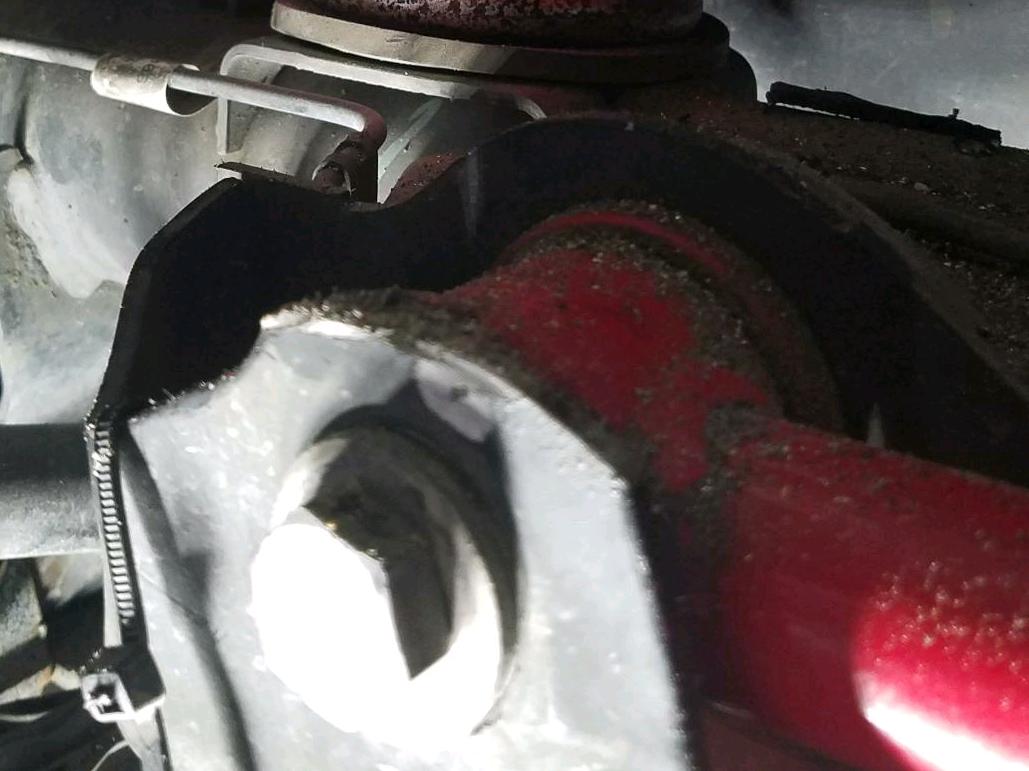

I finally ordered and got the helper bags installed in the rear of the Burb.
I also realized that the bracket on the axle for the panhard bar was hitting the crossmember above it when I would hit a dip in the road.
I knew something was hitting but assumed it was bottoming out the axle bumpstops on the frame.
So I trimmed the bracket
and notched the crossmember for clearance.
And installed the helper bags.
No more bumping and banging over dips.
How low are you?
