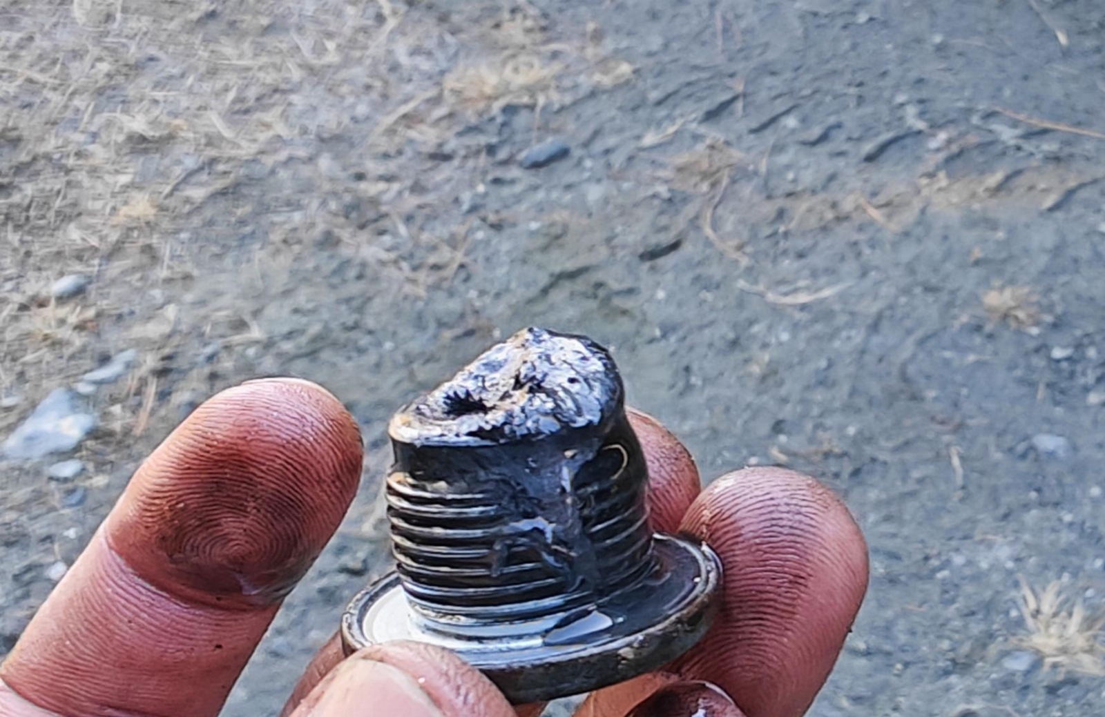

New front diff oil. Squeezed in some Lucas 80w-90, after draining the old gunk out, and cleaning the magnet off. Lots of sparkles, which pretty much confirms that the whining is the bearings failing, but which bearings?
There was at least an 1/8" of schmutz on the magnet.

this was my rear diff when I got it.. with 130 something on it. dead quiet still but it does seem like a lot.
this was my diff
I didn't take any of the front, but it was ugly too. so far thou no side effects from it. so it doesn't always mean it needs rebuilt, but if you got whining. yeah blah.
