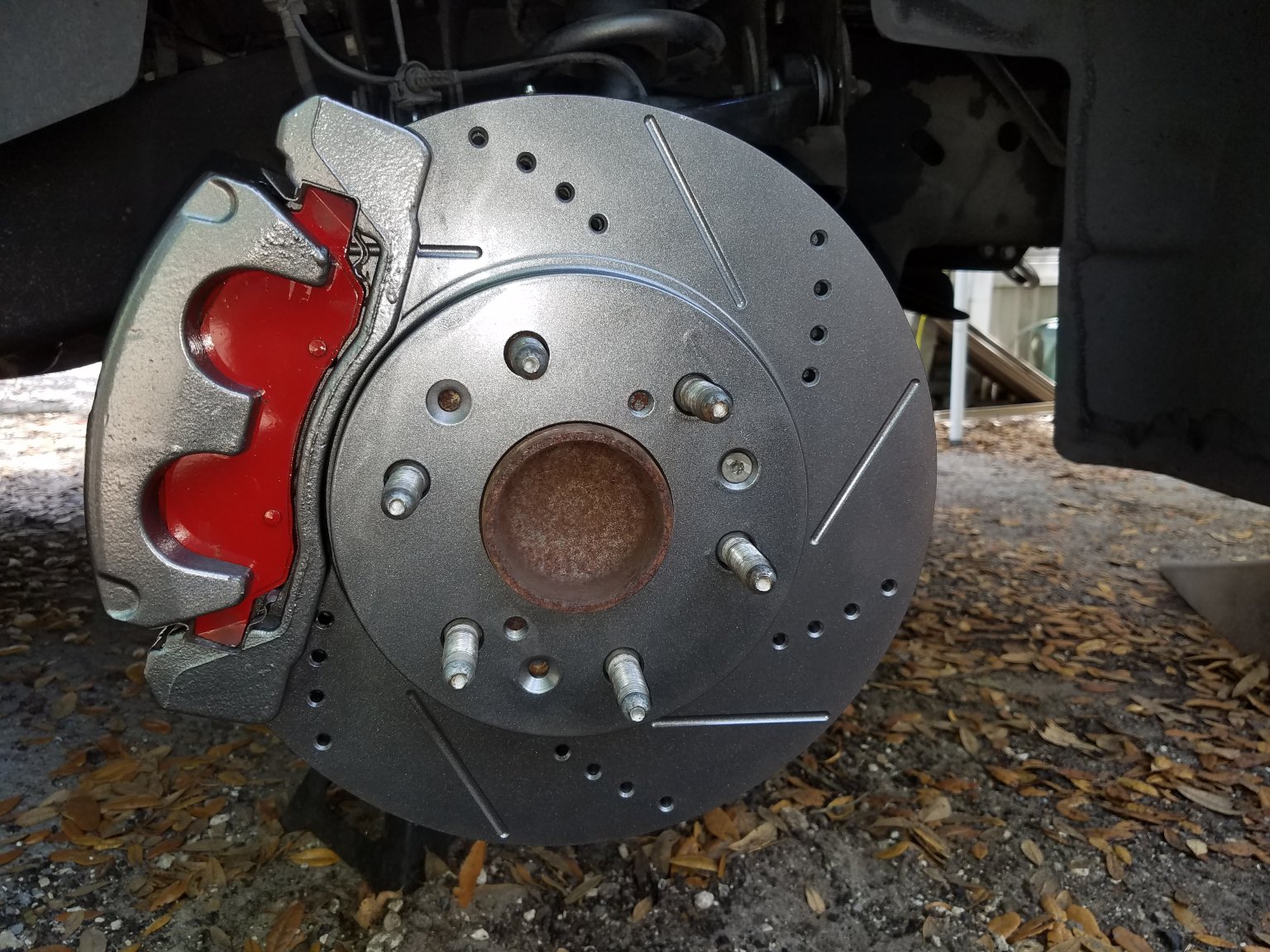

Here is a pic of the front rotors...
I forgot to take pics of the rear but they look the same only with single piston calipers out back.
I painted the rotors and calipers with high temp gun metal gray paint and the pads with high temp red. Of course the first time you touch the brakes the rotors face gets wiped of paint but the edge and hat remain painted and hopefully wont rust for a long time. I took it out and bedded in the new brake pads and after that she stops really well.

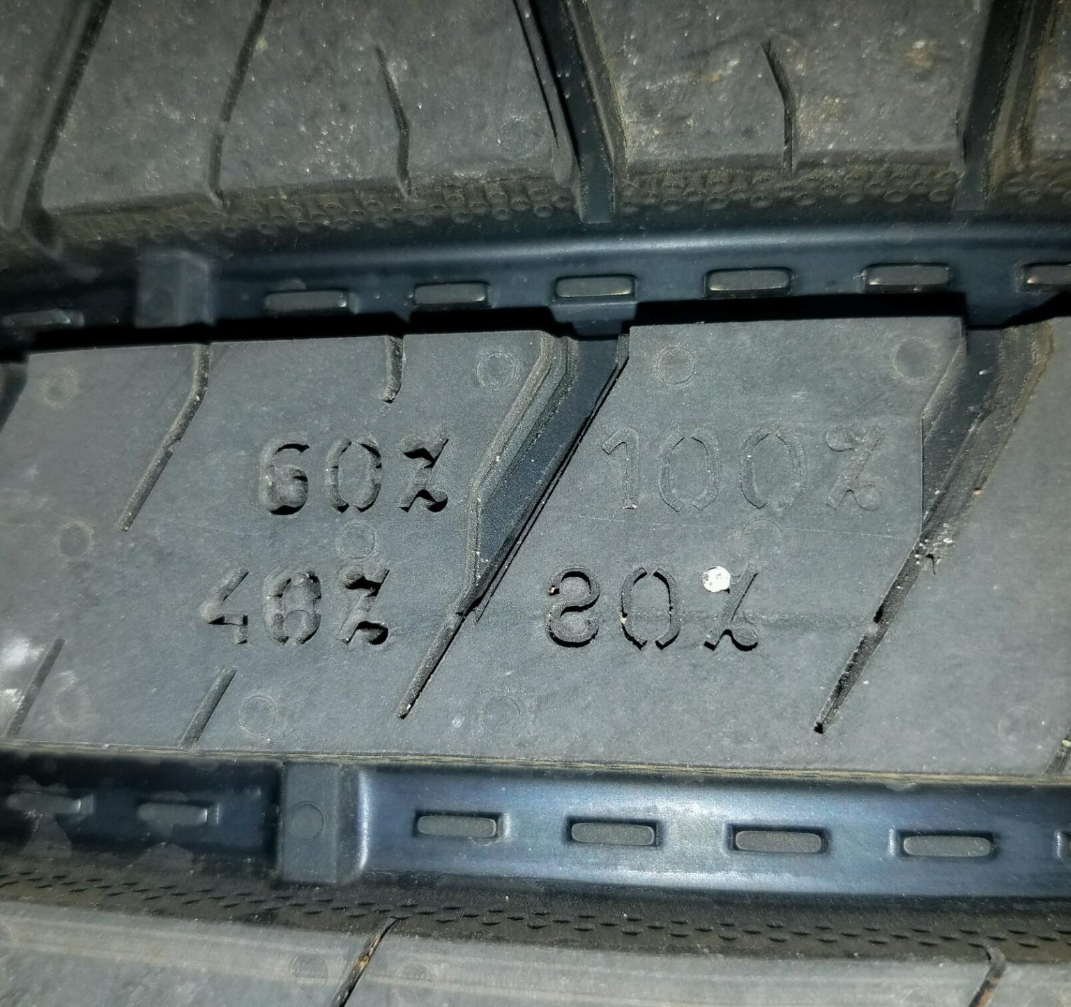

Here is one cool thing that I had never seen before.... These tires are made in Finland and they have a tread depth percentage gauge built into the tread... I thought that was pretty slick.

Heck yea nokian tires are great we use them in the winter here... best tire ive used for bad weather. And the tread % is a bonus haha.
Yeah as far as going that deep into something... This ain't my first rodeo.... Lol
I thought the tread gauge was pretty neat. I had never seen it before and to be honest I had never heard of Nokian tires before, but in my defense we don't get much snow around here in Florida. I bought the tires from a wholesale place around here. 275/55/R20 70,000 mile tires for $107 a piece, I thought that was a pretty good price for 20's.
