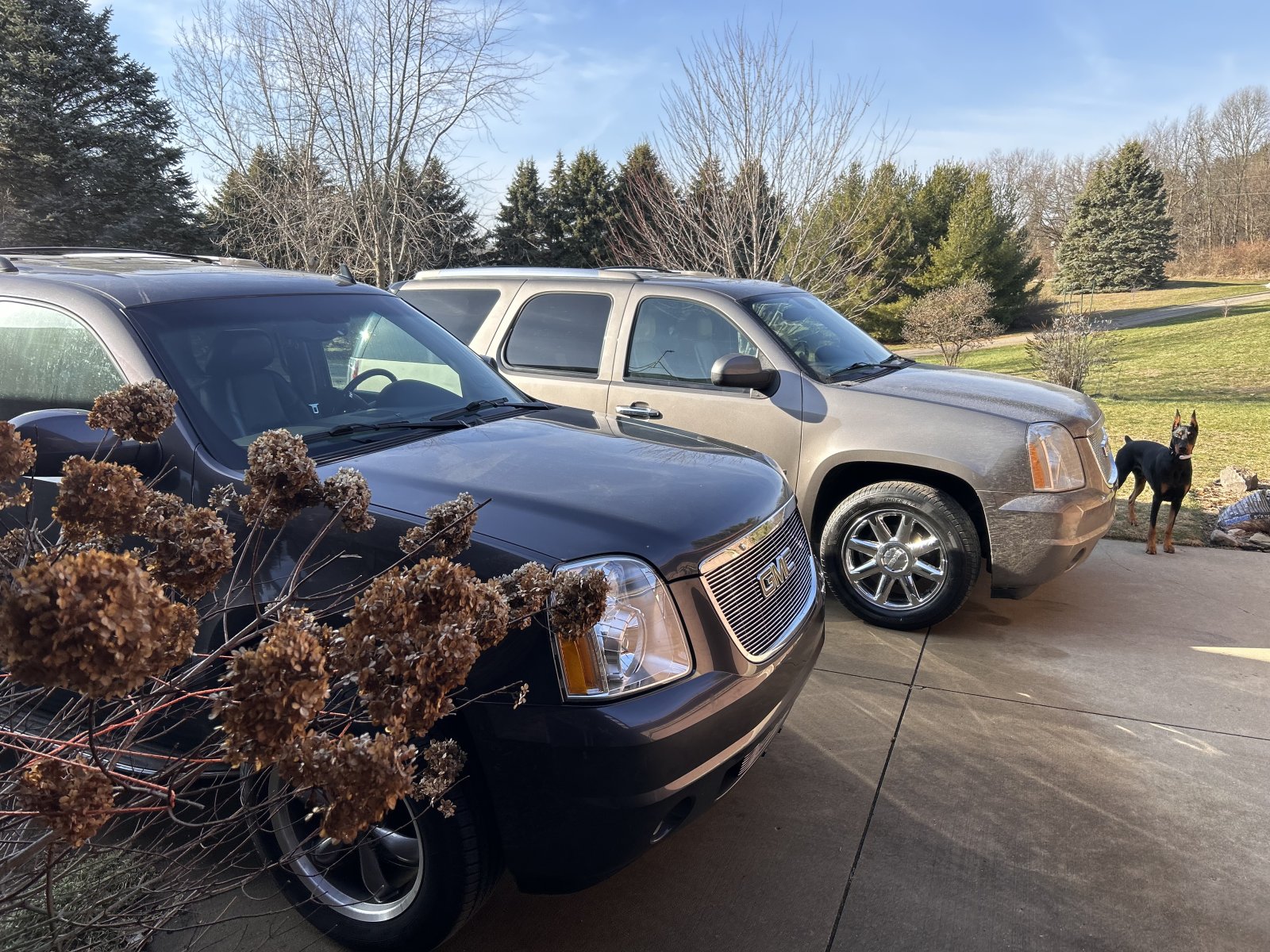

I didn’t realize how much darker the Omega was. Alpha is definitely due for a new set of shoes - proper 22” this time.
And I’m still debating on whether or not to go full billet. I didn’t feel comfortable cutting all of the old grille frame out, because of how the billet mounts to it. Plus the weight difference is like 2lbs vs 25lbs. The overlays look cheap and are made even cheaper. Maybe it doesn’t matter up here in deer country.
