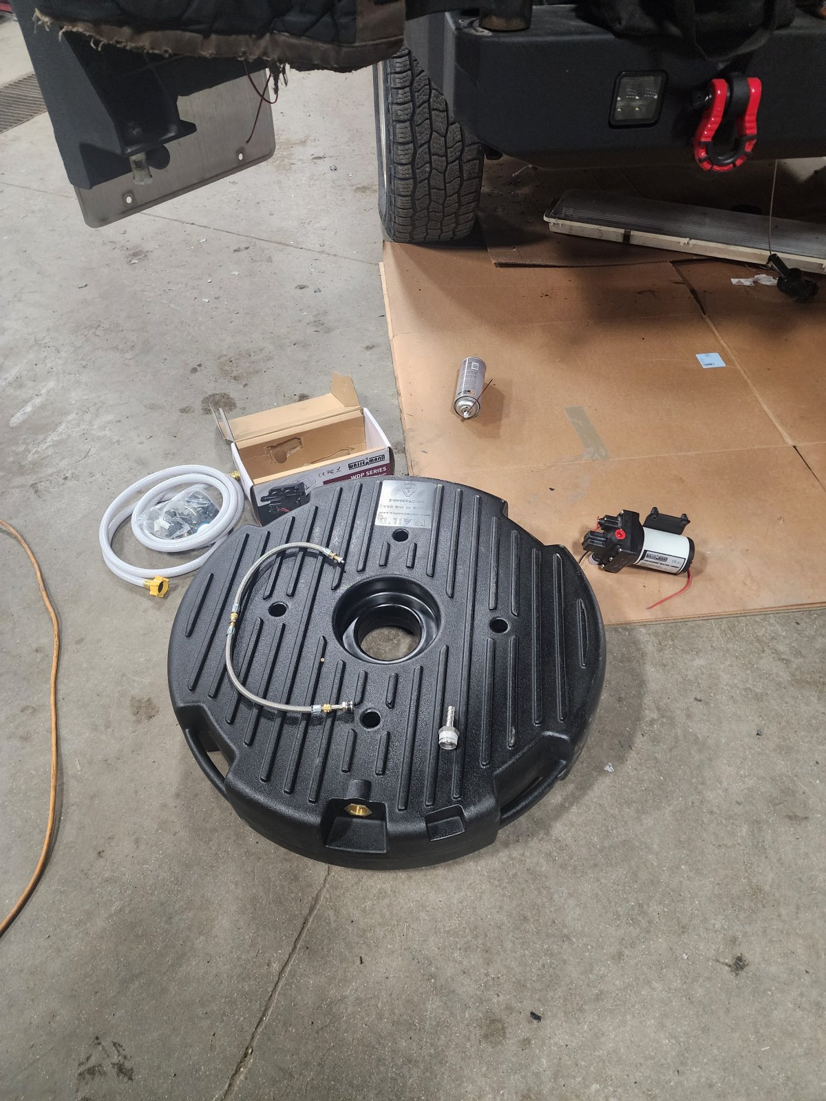

It's in there. Sprayed everything above it with Fluid Film to keep the rust goblins at bay.
Fluid film with a misting crevice tool is the way to go. Or Tranny fluid works as well. I don’t think fluid film smells as bad.
You have a link to that cover? I missed what that pump is for.
