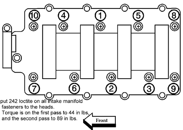

I was inquiring about new ones for that reason. I'm not sure if I have the updated PCV style. I'd like to find out before hand, How would I know if I have them?
I'll have to go over the manifold bolts as well and my intake bolts.

IIRC, if you have a MY 2011 or newer, it should have the update from the factory.

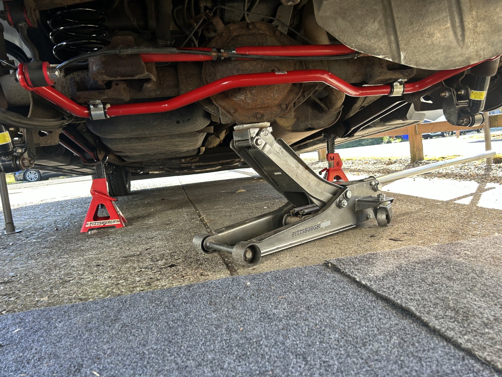

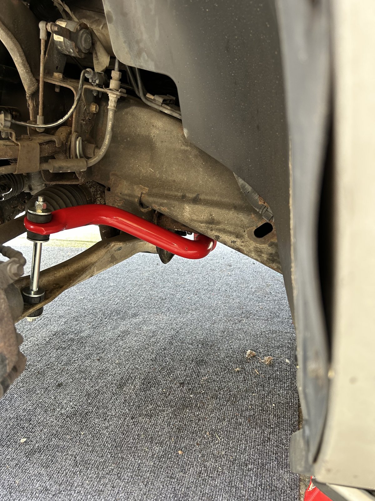

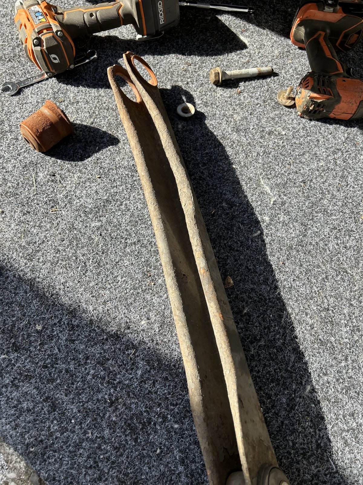

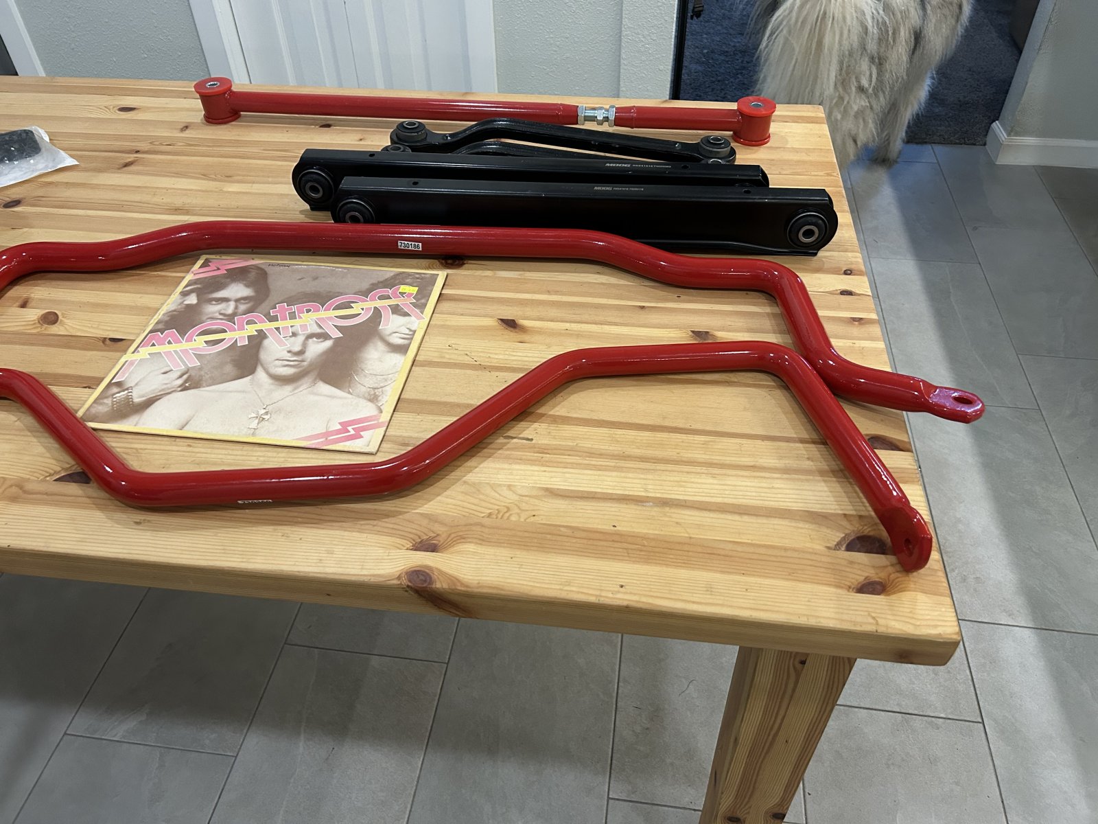

In the last few days I replaced the rear control arms, upper and lower. The left lower bushings fell out of it when I removed it, if that says anything about the condition of them. And it looked like someone jacked the truck up by the lower arms, they were badly bent. Also installed a set of Nolathane sway bars. I used Energy Suspension bushings and clamps on the fronts, the ones with zerk fittings. I ordered new Energy Suspension front end links, the shortest they have. I feel the road with the long ones on there. I should have ordered ahead of time. Oh, and an adjustable panhard bar, cheap knockoff. Got the rear wheels centered left to right.
Edit: forgot one thing. I ordered a new damn driveway. 24’ x 38’ exposed aggregate, way wider and most importantly- new. Im tired of this old crumbly thing. I signed a contract yesterday.
View attachment 469519View attachment 469520View attachment 469521View attachment 469522
How did those rear links twist like that?
Nice work @Rocket Man .
You need some shorter sway bar end links for the front.

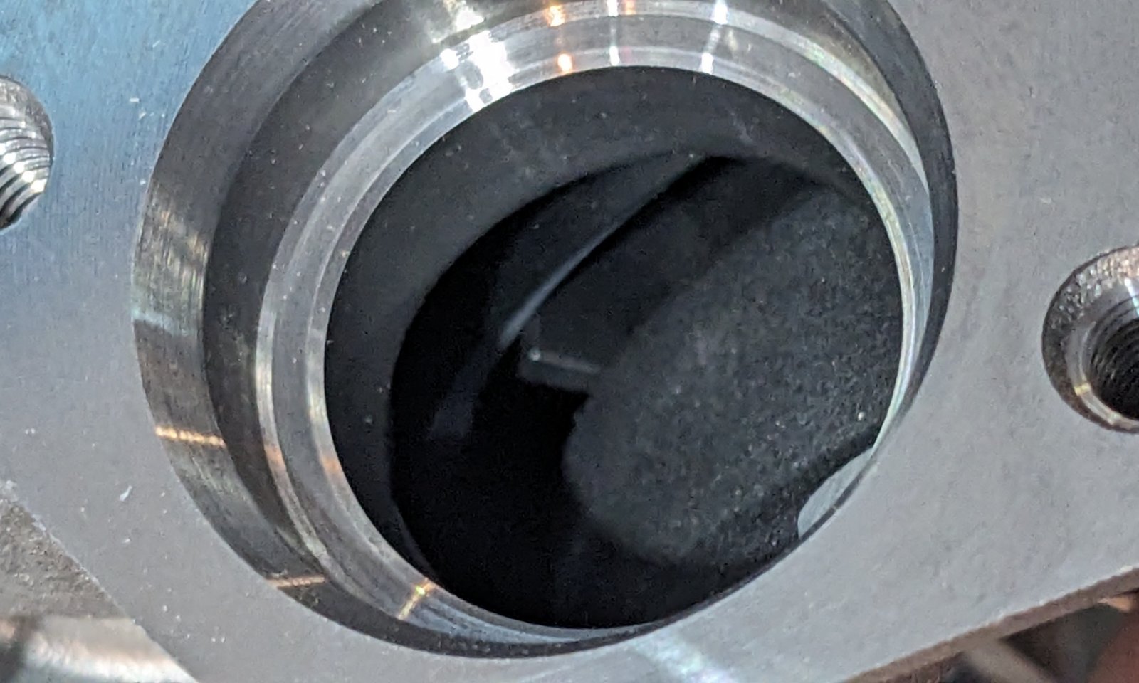

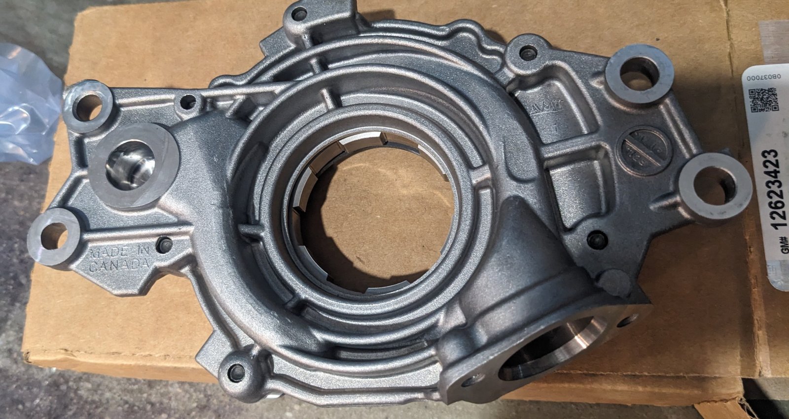

a variable displacement ls oil pump.
fins inside instead of gears, and I don't see any pressure bypass. how it changes displacement, I have no idea. I'll have to take the cover off the old one.

What's it from?
