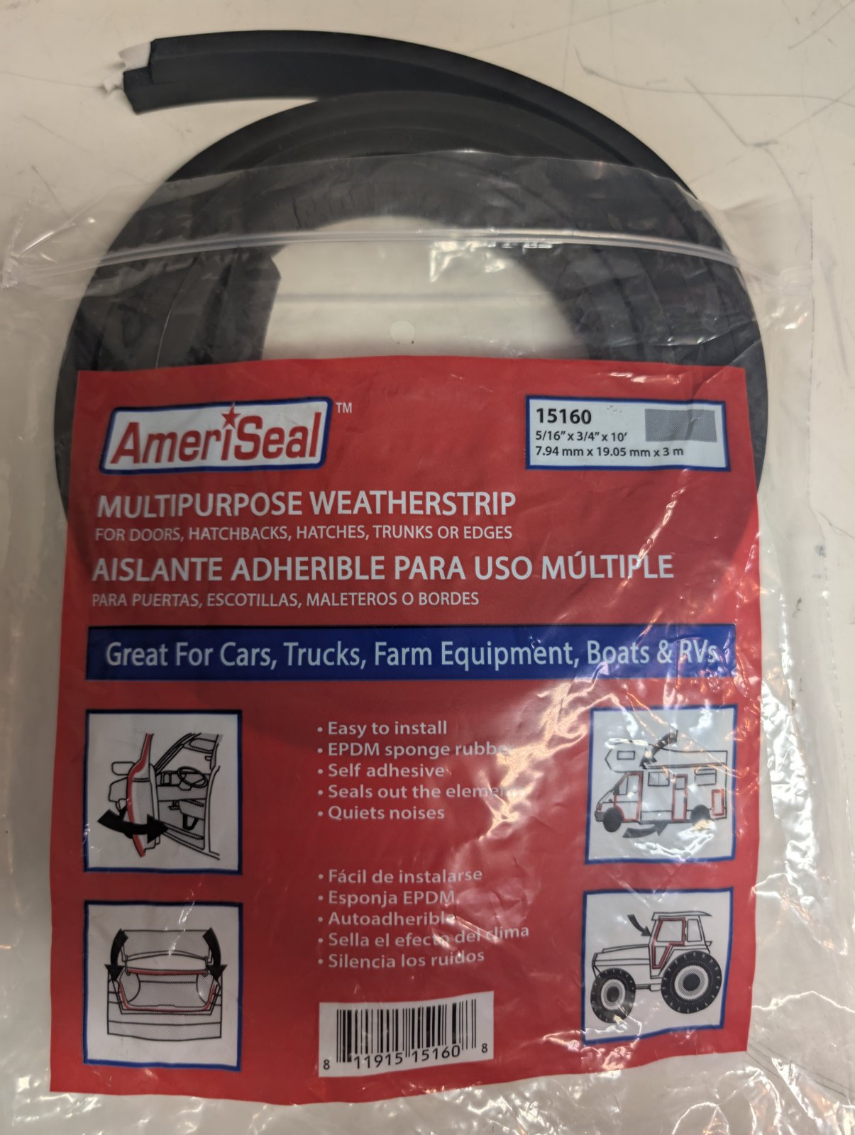

This the stuff I bought at AutoZone it sticks on well

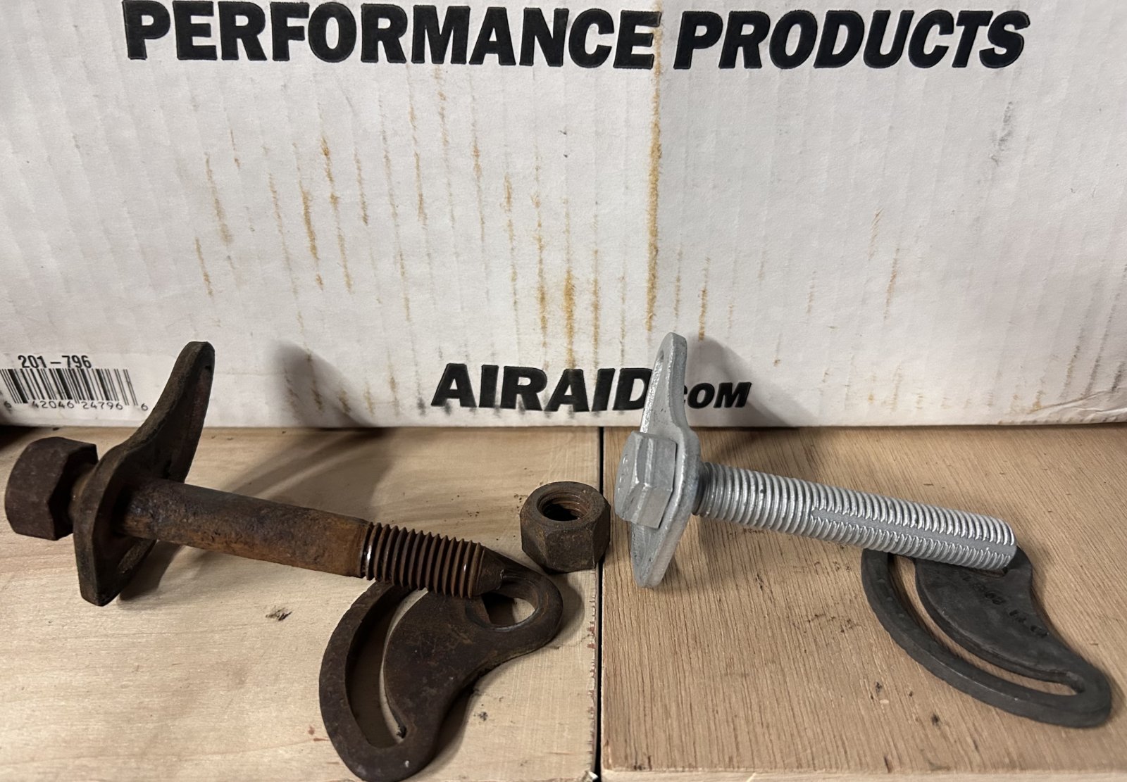

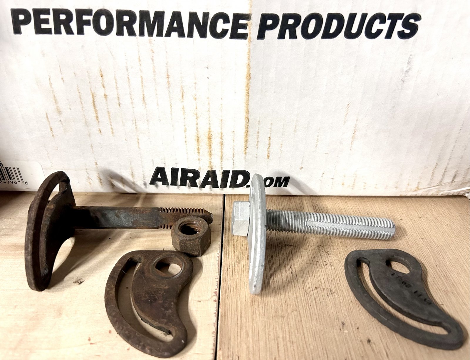

Anyone ever used upper control arm bolts with grease fittings?
The replacement GM cam bolts are completely different than the OEM ones. So buyers beware.
Not only will they not fit the old plates, but they don’t even fit a set of brand new OEM GM Genuine camber plates.
They are fully threaded with lines ground down the center of the bolt - on opposite sides versus having one flat “keyed side” to fit the camber keyway.
After an hour of grinding and filing I got them to work, but I’m debating on switching over to some other brand (maybe MOOG camber bolts).
I saw they had Delco and MOOG kits, both with and without grease zerks.

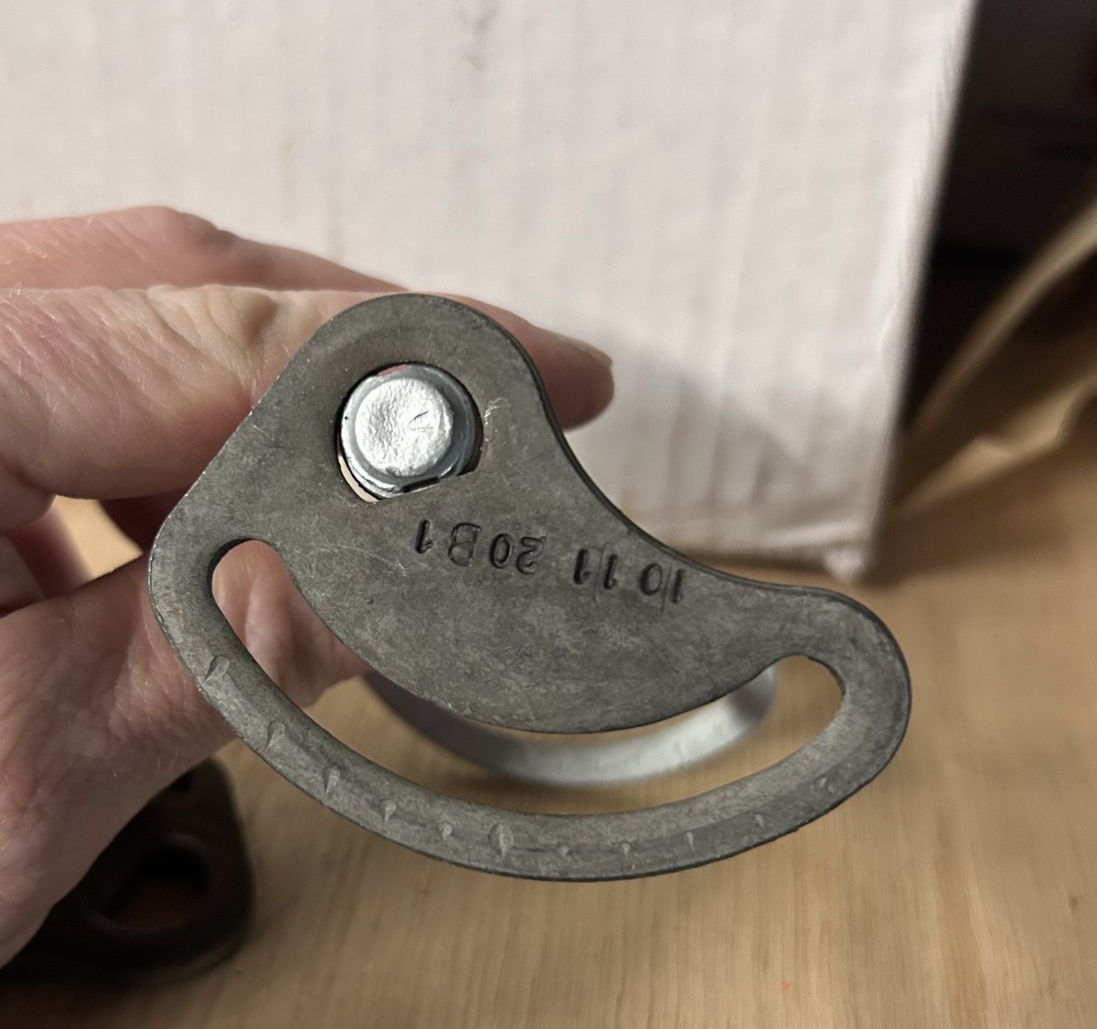

I believe there are two camber plates avail, one with more adjustment. Which one did you purchase?
I bought both plates. One was the bolt that came with the plate, the other was just the plate. Let me grab the p/n’s.
*I don’t know why I made that last comment like you guys are on FaceTime or even listening to me compose this message. Ha!
GM - 15741217 (camber plate)
GM - 11601736 (bolt & plate)
*if you have a different p/n by all means, please share the knowledge.
In this last photo you can see that due to the fully threaded design of this bolt, the plate won’t go on any further than what’s shown. At least not without some modification. I had to grind and file the taste into my mouth before I could get the other side to fit.
Make sure to put the nut on first -before you do any grinding. That way when the nut is removed (prior to installation of the bolt), you will be using the nut to help “reset” the threads of the bolt you just abused.
Otherwise they can be a bit of a bear to bite initially without running the risk of cross threading. The same concept applies if you ever have to cut the length off a bolt or screw. Thread the nut on first, then cut it to length and as you remove the nut it will make ease of install. It’s also the reason why electrical wire strippers have a threaded hole in them. It not only helps hold the screw you’re cutting down, but as you unscrew it from the strippers it cleans up those first couple threads.
*the more you know…

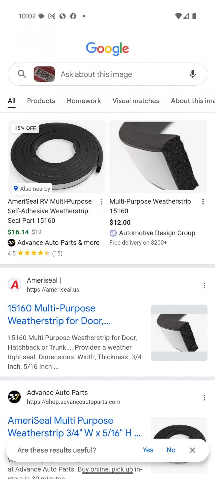

@dkad260 got a link for that adhesive weather strip you got there?
I picked up some at autozone that's probably identical a couple weeks ago for my 03 that my sister has now. I think it was around $17 for a 12' roll. sticks on well

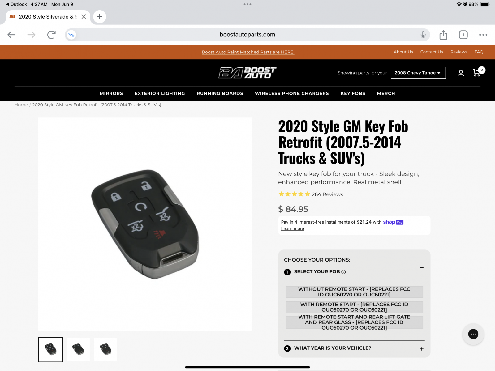

I lost the set of keys yesterday for the Tahoe that had my Boost Auto key fob along with a house and mailbox key. I went to order a new 2015 style fob (price has gone way up it seems) and saw they now sell the 2020 style for the GMT900 platform only so I ordered the new version. On an unrelated note… bought these 2 Koi to add to my collection. My pond is filling in nicely. The fish are in Hawaii and will be shipped after they don’t eat for 2 weeks, poor guys.
Boost Auto link
