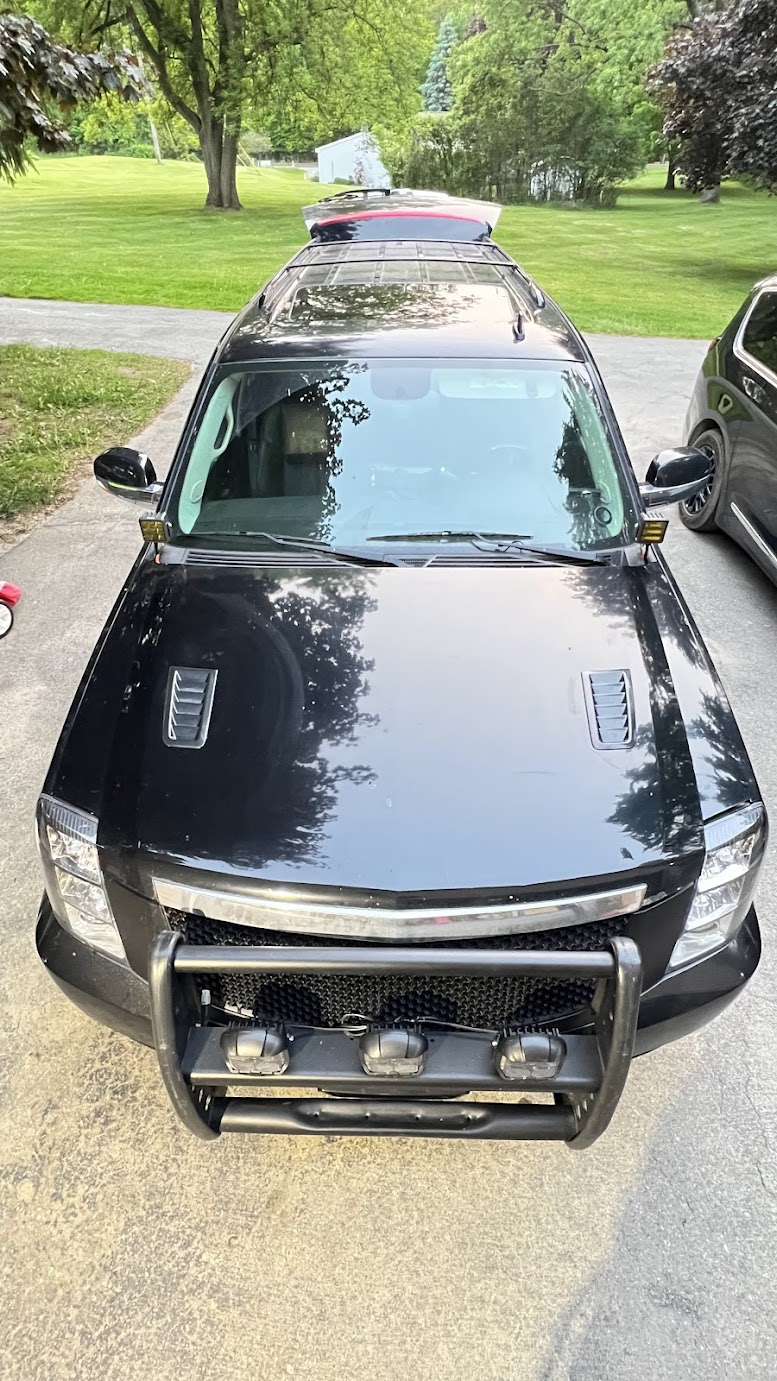

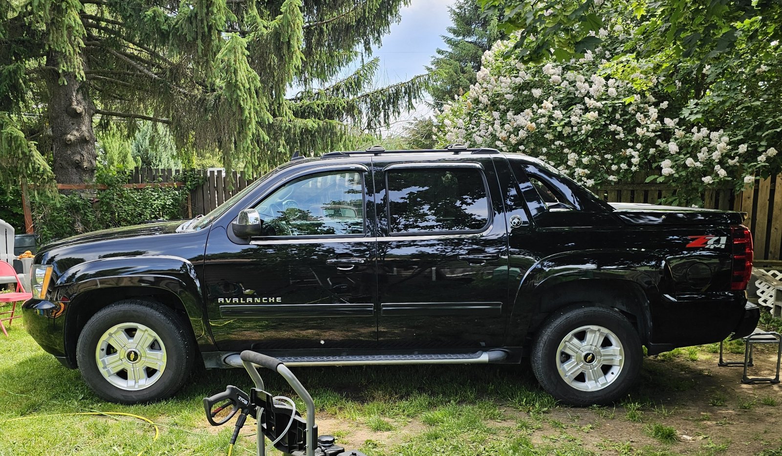

So we leave for our annual Gulf Coast trip friday...driving thru whats looking for gnarly storms BUT..
Sunday I gave it a good cleaning, inside, outside and put a new ceramic coat on it....cleans up really good for an 11 year old brown truck. Its dirty again, more tornadoes today and had to drive thru the rain but nothing sticks to it.
full
full
paint and glass is really reflecting
full

Damn that's a good looking rig! Nice stance, wheels, tires, flaps, really nice!

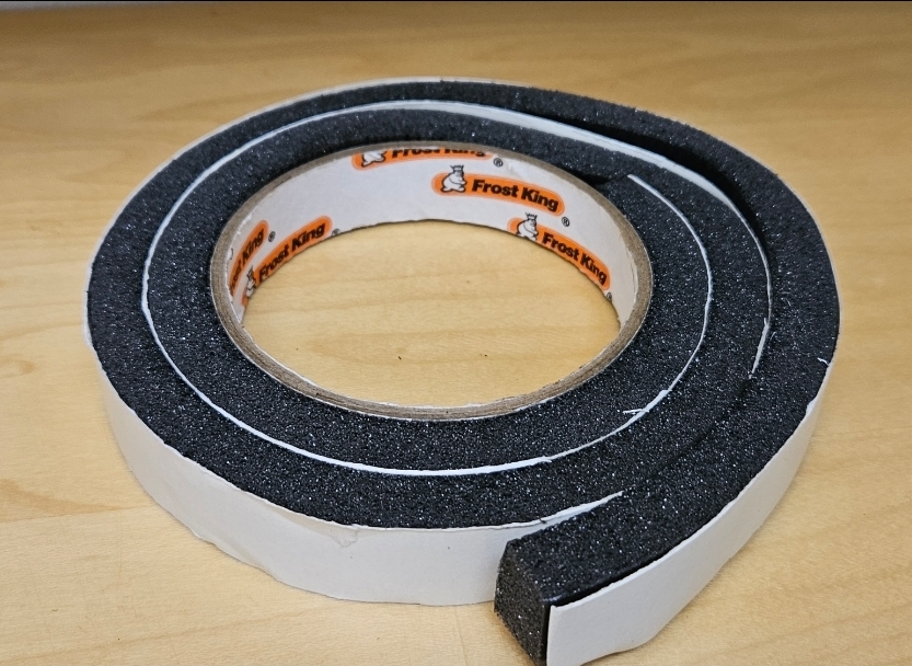

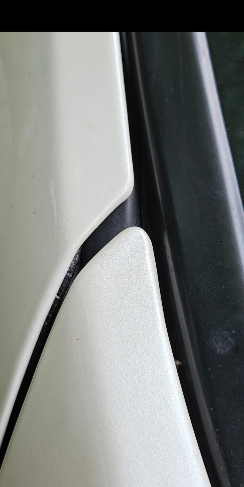

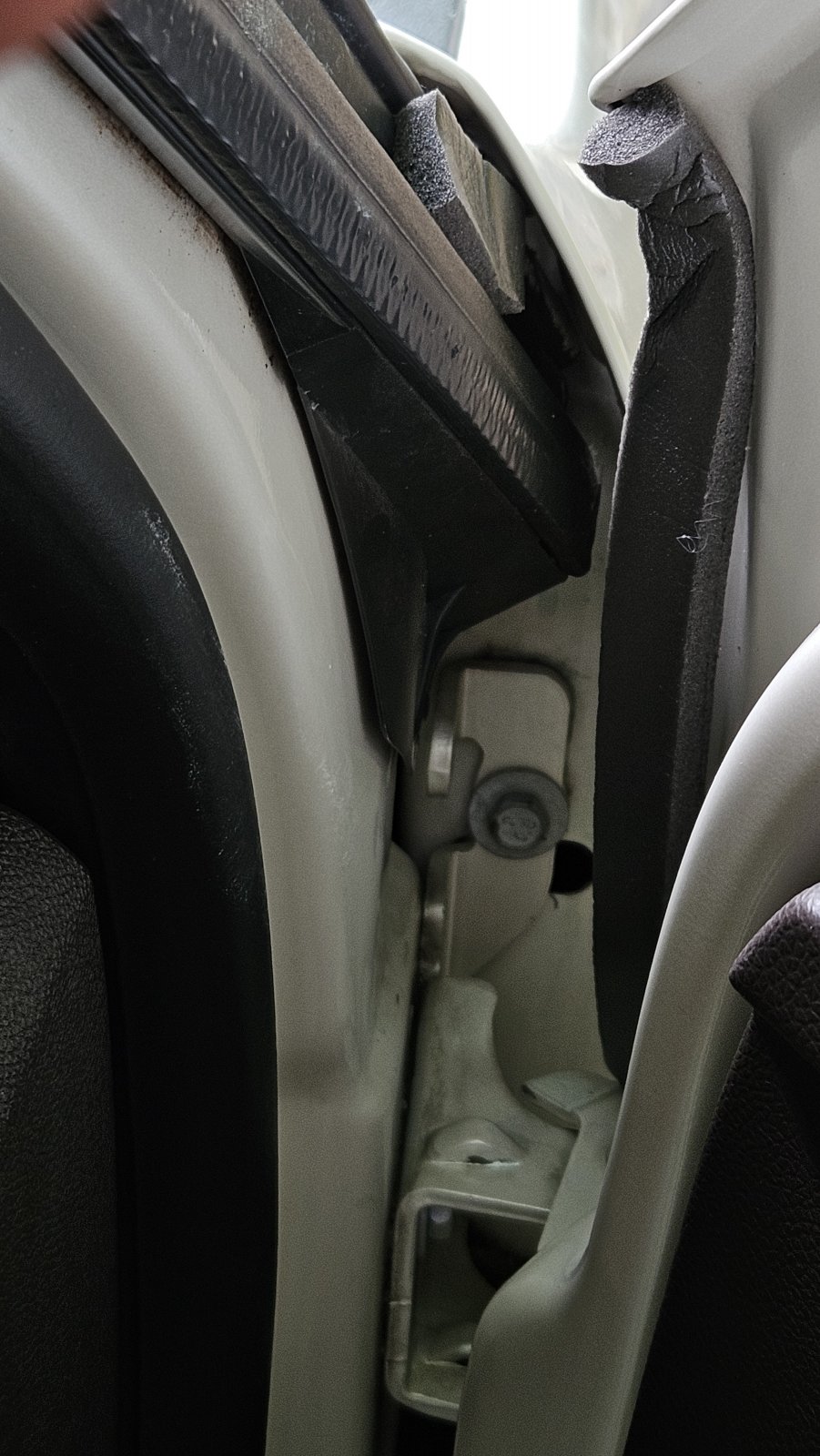

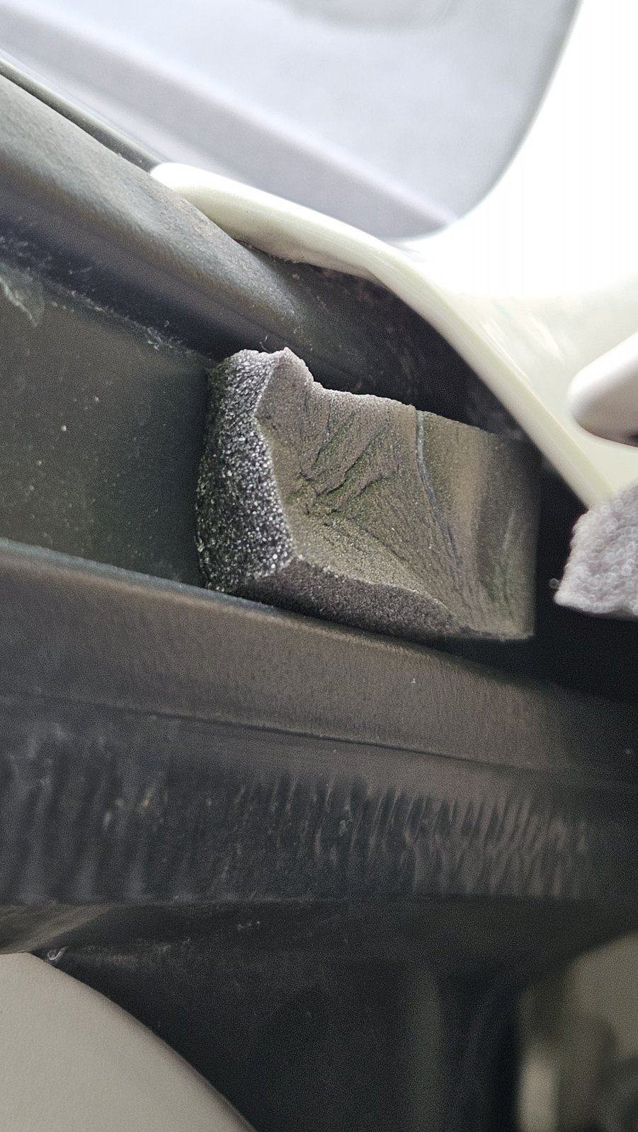

This is work in progress so forgive the slight sloppiness as this is an ongoing science project.
I used some adhesive foam weatherstip, I believe 3/8" thick by 3/4" wide. I only have the black at the moment so if this works out I'll likely source some white or grey.
This is the RH side, both sides are the same.

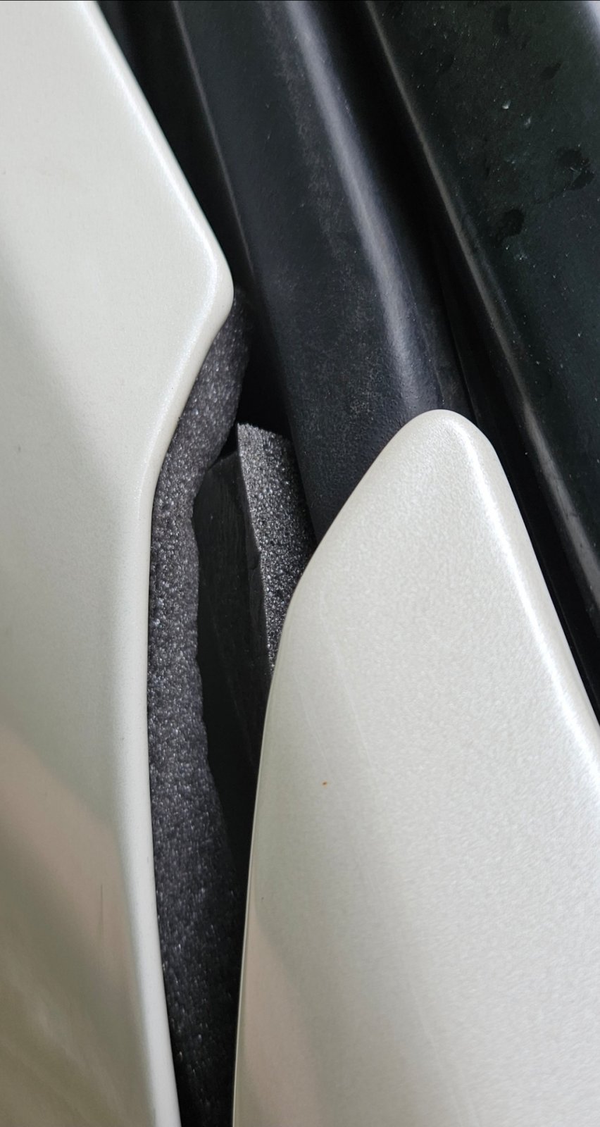

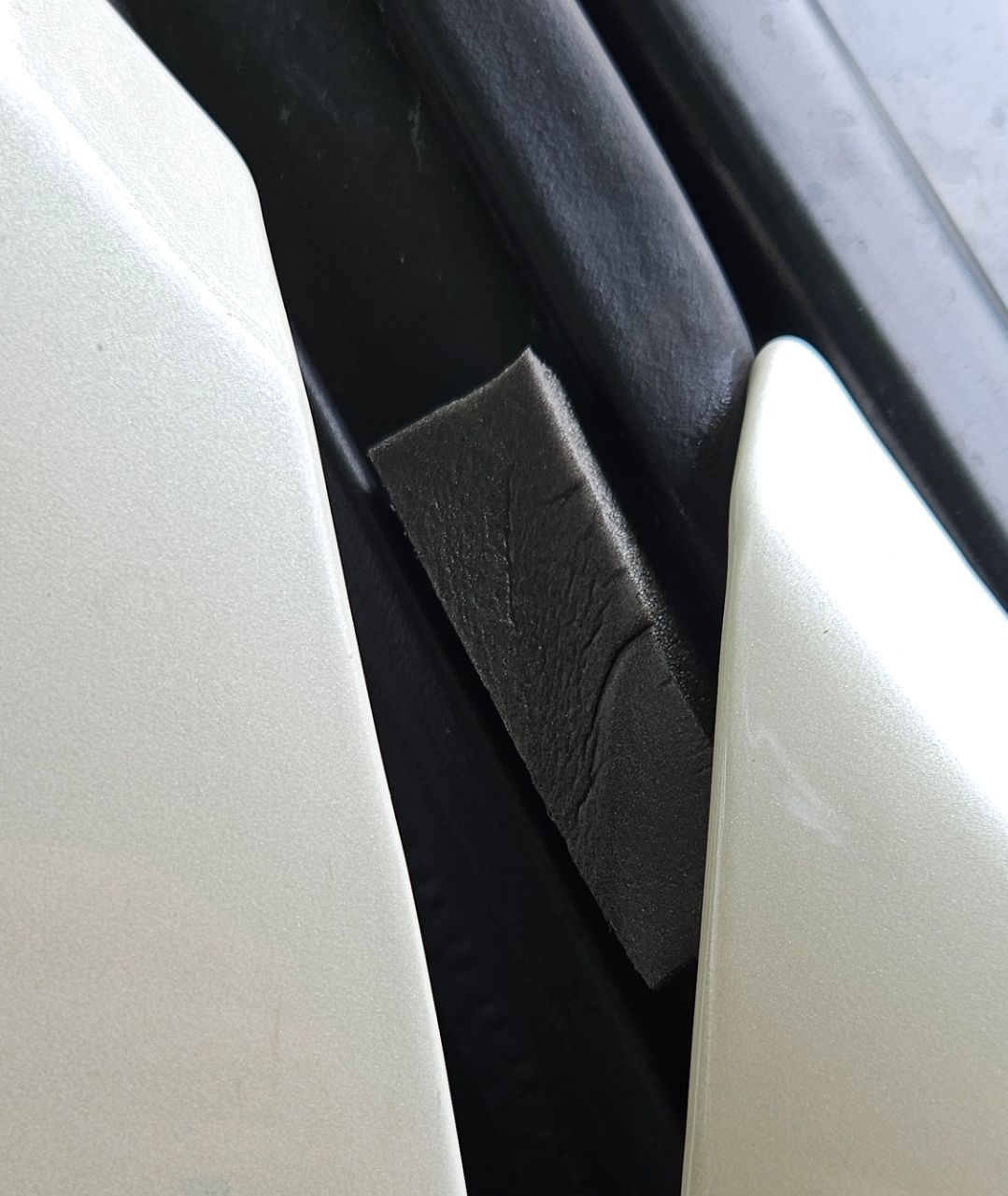

I cut a small piece and placed here...
Which is overlapped by a piece along the edge of the door.

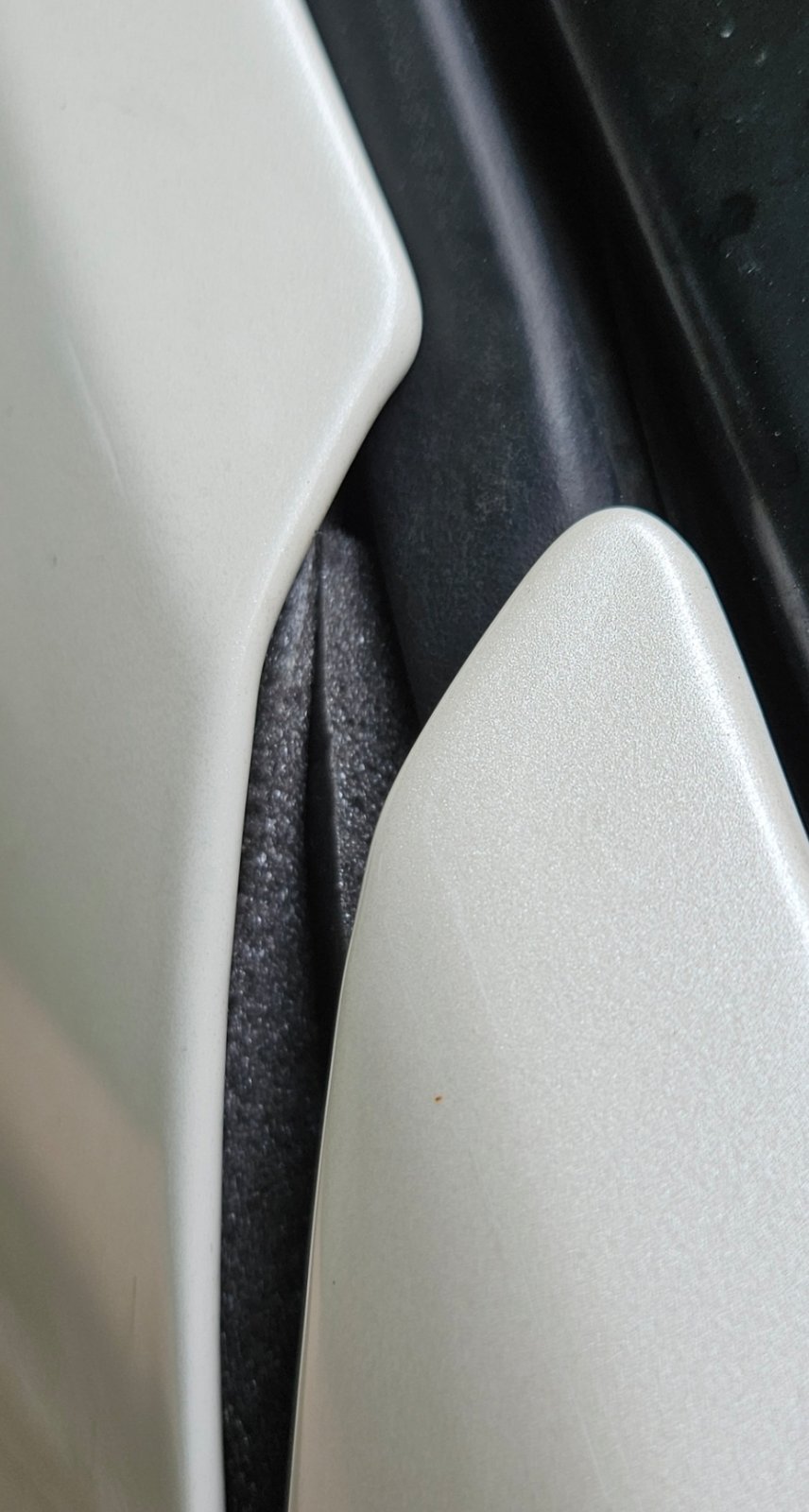

What it looks like as they come together...
Disappears from view when closed.
I did this on both sides and has pretty much eliminated the wind noise.

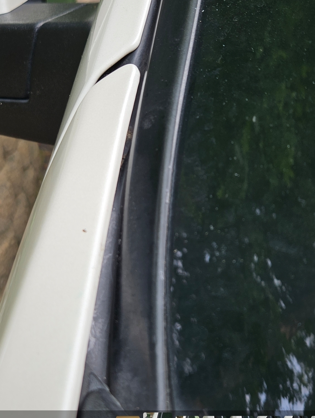

I also closed this smaller opening up
Behind the LH side mirror, but not on the RH side....both sides are just as quiet now so likely no reason to do this.
I have to clean up the install, again, still in the trial phase, but give it a try and see if it works. Was a substantial change in cabin noise.

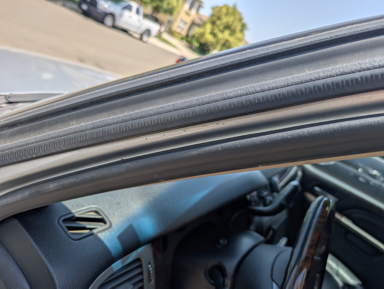

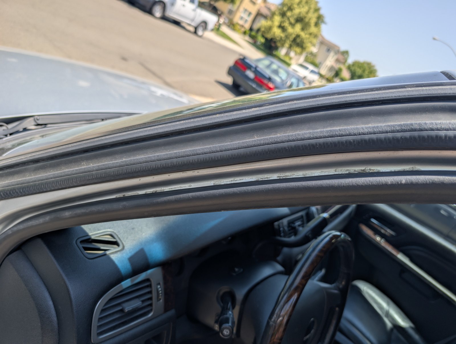

The inner door seal is where the wind noise comes from on mine, you can see the little bit of spray glue I tried where it works its way loose, pushing it back up eliminates the noise

The inner door seal is where the wind noise comes from on mine, you can see the little bit of spray glue I tried where it works its way loose, pushing it back up eliminates the noiseView attachment 458961View attachment 458962
If you plan on keeping it for awhile, I would urge you to confirm the part # from the dealer and try to find a new OE seal online before they are NLA.
I did that with mine about 2 years ago and seemed to help a little. The main entry was that area I had treated with the pieces of weatherstip. I had my son use our small DeWalt blower and point air in numerous places....it was very distinct when aimed at this spot

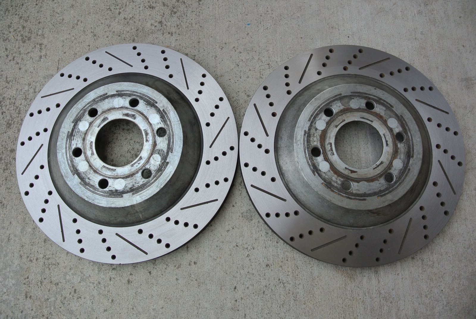

Have you considered upgrading to stainless steel brake lines? Even with stock calipers they have a noticeable impact on increased pedal feel and response.
Personally, I would stay away from drilled rotors for a DD street vehicle. You end up with hairline cracks spider webbing from the drilled holes. I would stick with slotted, dimpled, or plain rotors.

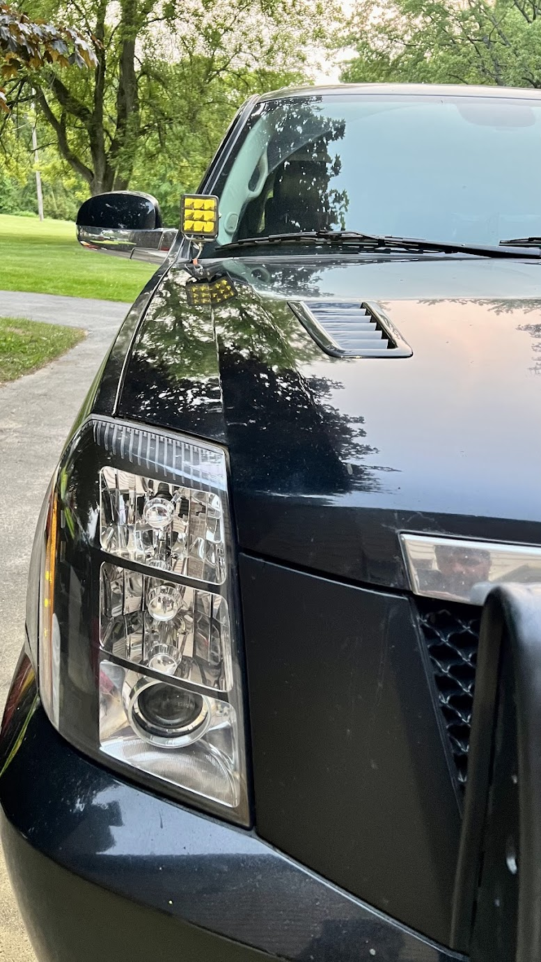

What brand black housing headlights do you have there?
How long have you had them?
Any issues with condensation?
What’s your opinion on the light output of the HID projector compared to OEM headlights?
I love the look of the black trimmed housing on the GMT900 Escalade but am so hesitant to go with an aftermarket headlight housing…

I thought there was a relatively cost affective way to upgrade to the 4-piston front calipers from the T1XX SUVs/Trucks? Maybe worth looking into.

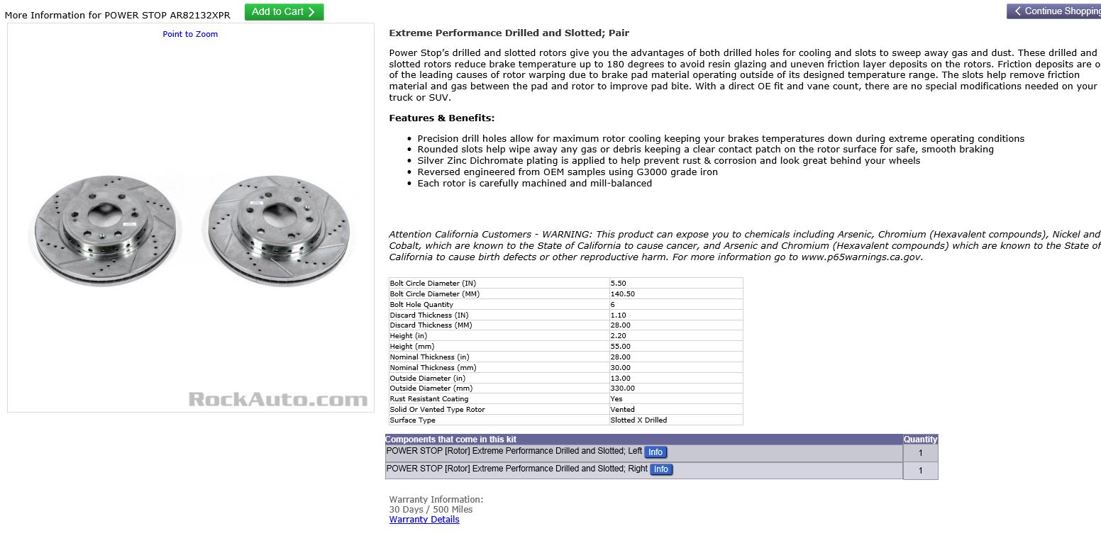

i have had these power stop on the pickup for years now added them to the wifes truck a couple years ago and no issue's of any kind and I drive these mofo's like mario andretti
no problems with Baer erradispeed either those bad boys are thick

@dkad260 got a link for that adhesive weather strip you got there?
Once the size is narrowed down, I'd suggest refining the properties and getting it from McMaster-Carr's "foam" category. I did this when I had to r&r the sunroof cassette in my Gen 3 Camry and no one except them had the strips with the correct properties; I ultimately decided to stack two different P/Ns with the same size, but different density to conform and have the right "squish." Importantly, make sure the foam is rated for outdoor use -- a lot of it you get at hardware stores isn't and it'll crumble after a short while.
I believe this is it.
White:
Black:
