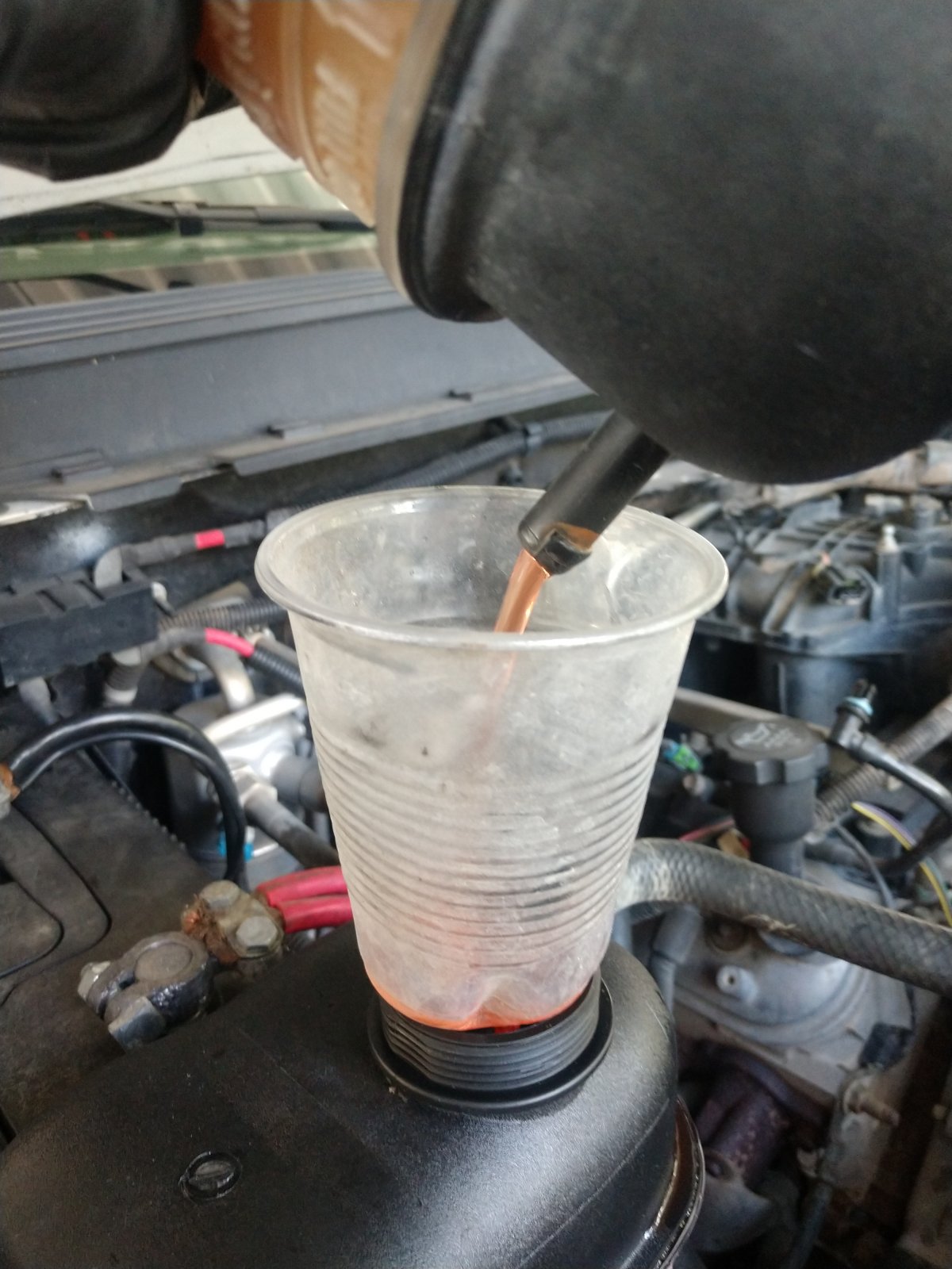

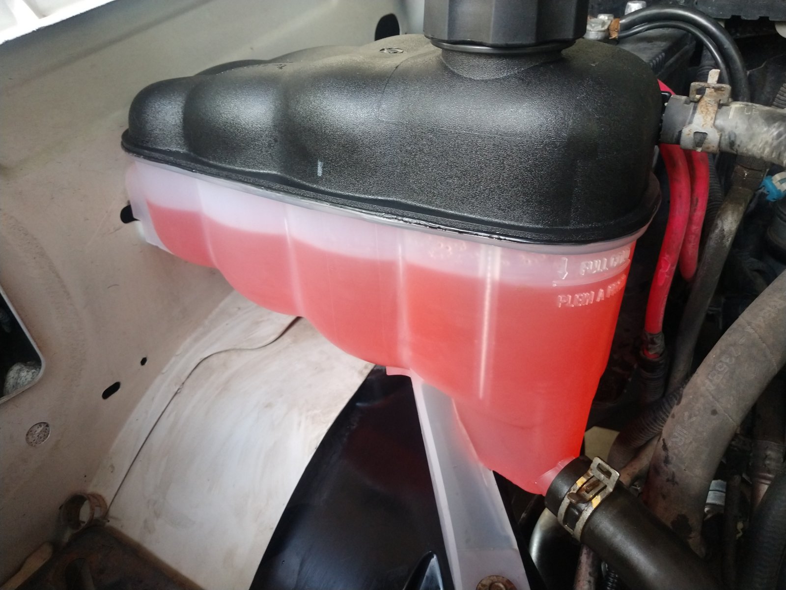

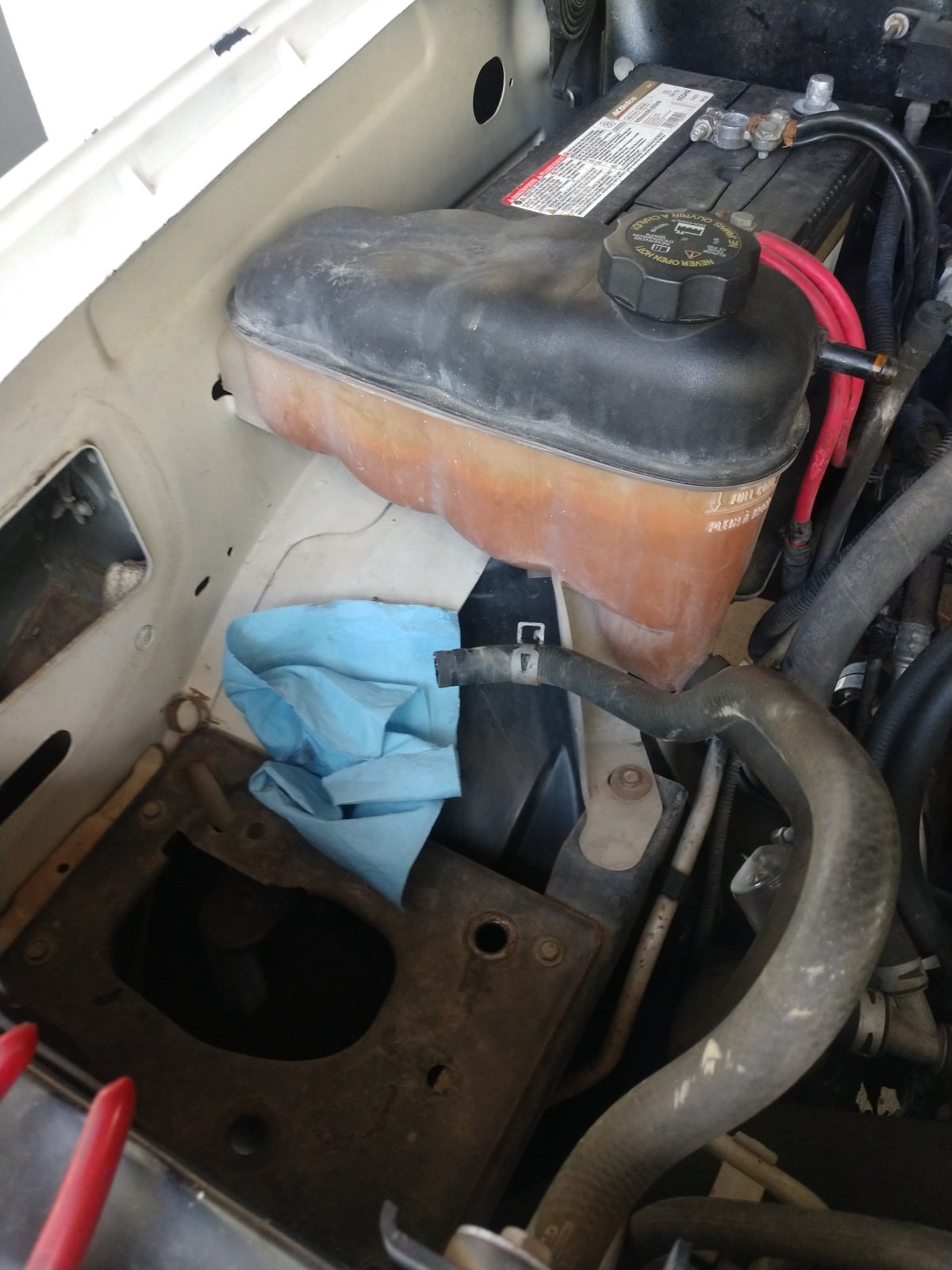

Coolant tank was old/cloudy. Couldn't hardly see the coolant level.
Swap was easy. 2 10mm nuts/bolt. Remove small coolant line. remove large coolant line and put on the new tank.
Use a funnel (I punctured a hole in a plastic cup) and pour into new tank.

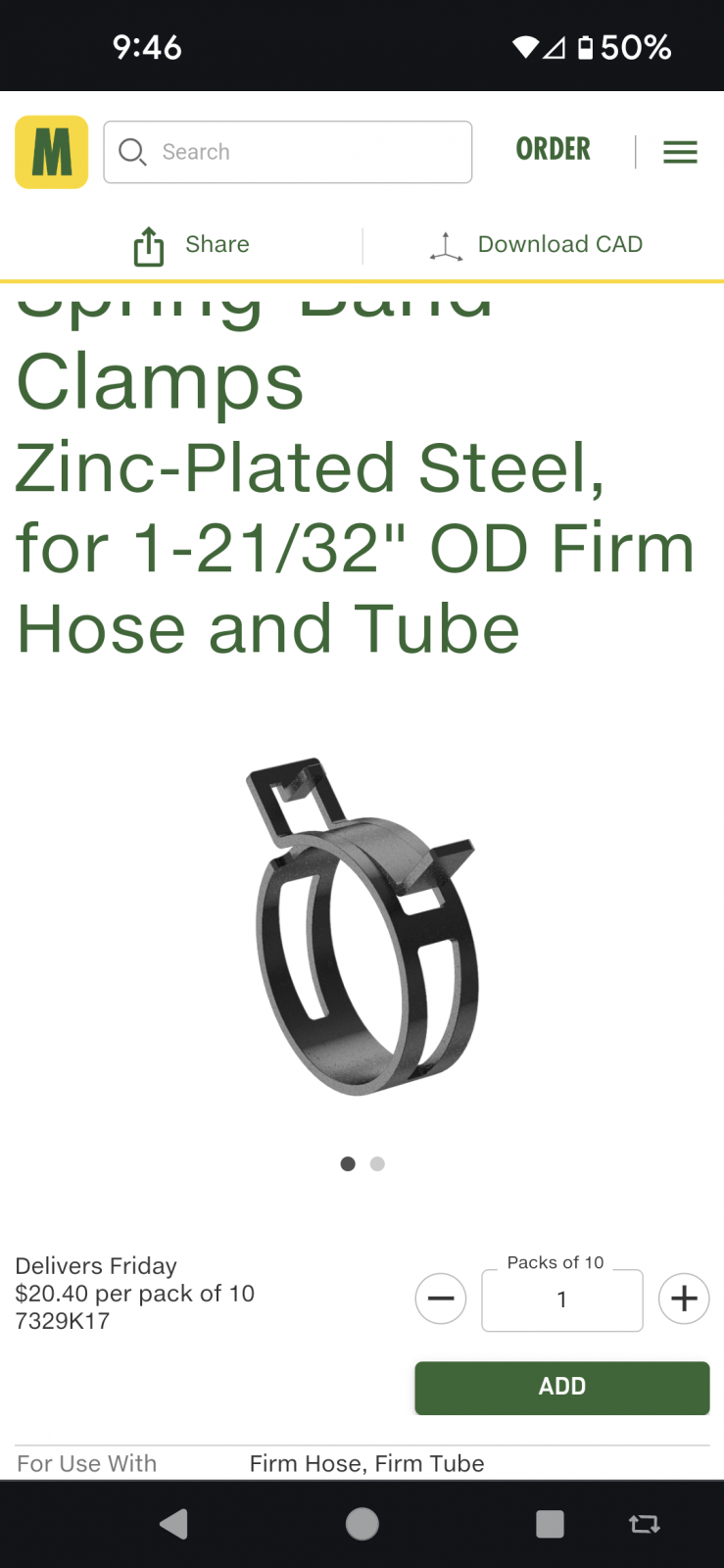

McMaster Carr has an excellent selection of spring clamps, and the measurements and pricing can be had here:
j91z28d1
Feb 28, 2022
4,611
5,864
huh, you know have looked around on there before but never actually bought anything. looks like I need an account. they actually seem to list useful ones. never thought to look there.
